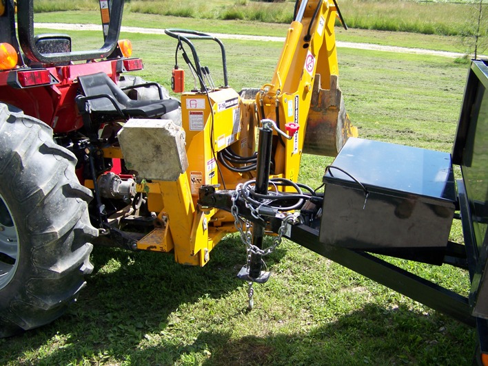

Dave what is the other piece that is also stored under the back hoe base along with the hitch?
   / Hitch on your backhoe #35
Fiddler,

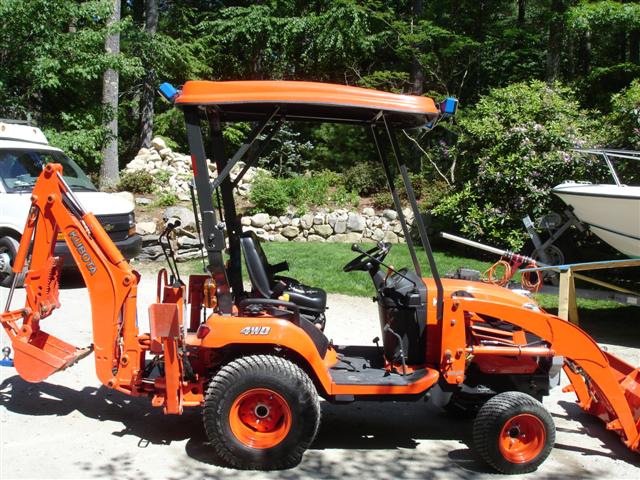

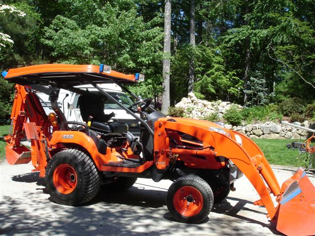

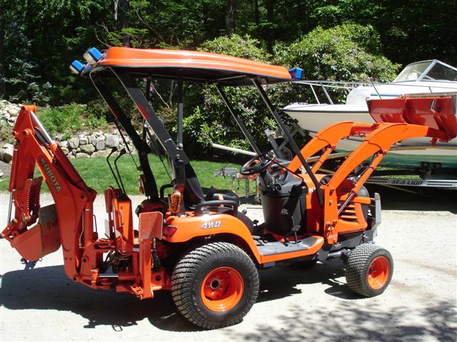

The front box has 30' of 3/8" g70 chain in it - 3 10' lengths w/grabber hooks on each end. The box @ the fel arm has tools, the two other standard tow balls, a bunch of hooks and shackles, and spare fuses. By coincidence those size boxes fit like a glove, almost "0" clearance on the front one - cheap money too @ your army surplus store + waterproof.
With the top all the way down, you could get inside but you wouldn't as it's only for being on the trailer. Halfway up is where I normally keep it - easy to get in and out at bh or front though you can't stand up in it - can't stand up in my truck either & never was an issue. The top is just under 80" tall & my garage door trim is 81". That benchmark was used to determine the halfway height. All the way up it looks kind of strange - like a surrey - & never put it there unless it's raining & I'm working the fel. I initially cut 3" off the bottom legs of the rops as that's the most you can take off before the bend in it starts. Even with that the top looks too tall for the tractor with it all the way up. I would have cut more at the time but it would have meant sectioning the top sides of the rops & rewelding - it is not very thick stock & would have had to have been sleeved - looking back through all the work that has been done now, I should have sectioned them by another three inches.
Some of the design considerations were;
1) Height of garage trim.
2) With the top halfway down, the rops function is severely compromised so brace arms were added.
3) Folded all the way down the starboard front canopy arm had to be shifted outboard a bit to clear the fel control and also wanted full function of that control at that position. Also the canopy had to stop just short of the boom in it's locked up position.
4) The canopy needed to stay level for looks in all three positions - That was done on graph paper 1st and then mocked up with 3/4" wood sticks. It was achieved by the location of the pivot points and length and bend of the front arms.
5) By default the two up positions give rain coverage at either the BH or front stations.
6) Found after fab it took all I had without busting a nut to push the top up from full down and difficult to position it accurately with one hand to pin the locking bolts in. Added 2 90# struts and solved the problem -100# would be neutral & will switch them out later.
7) Wanted all wiring hidden and not get pinched inside the rops' pivot as well as up @ the marine hinges.
8) A "factory" look was important, so even with the great welds you can get with the mig, all welds were faired will aluminum powder filled polyesther resin - a little pricey @ $30/quart - but way better than plain bondo, and it's thicker consistency is easier to work with & feathers better too.
9) The coating is 1986 Yamaha dark silver marine outdrive paint from Tempo. As a laquer it touches up invisibly unlike most paints even with the metalflake in it. I bought a case for the shelf as Tempo is now closing it's doors. In the process I put about 10 coats on the intake screen - noticed most in the dealers yards were starting to rust from foot scuffs.
Spent an evening with the heat gun and vaporised all the decals except the backhoe removal instruction which I kept as a boot scuff guard. Would like to detail the loader arms and other locations when I'm done customizing with some pinstriping - am looking for some one near Cape Cod who's a good artist if anyone has advice.
The blue arm you see is for the wallenstein thumb. I store it there instead of on the thumb as it is sort of in the way when using the bucket - even when folded down.
Dave

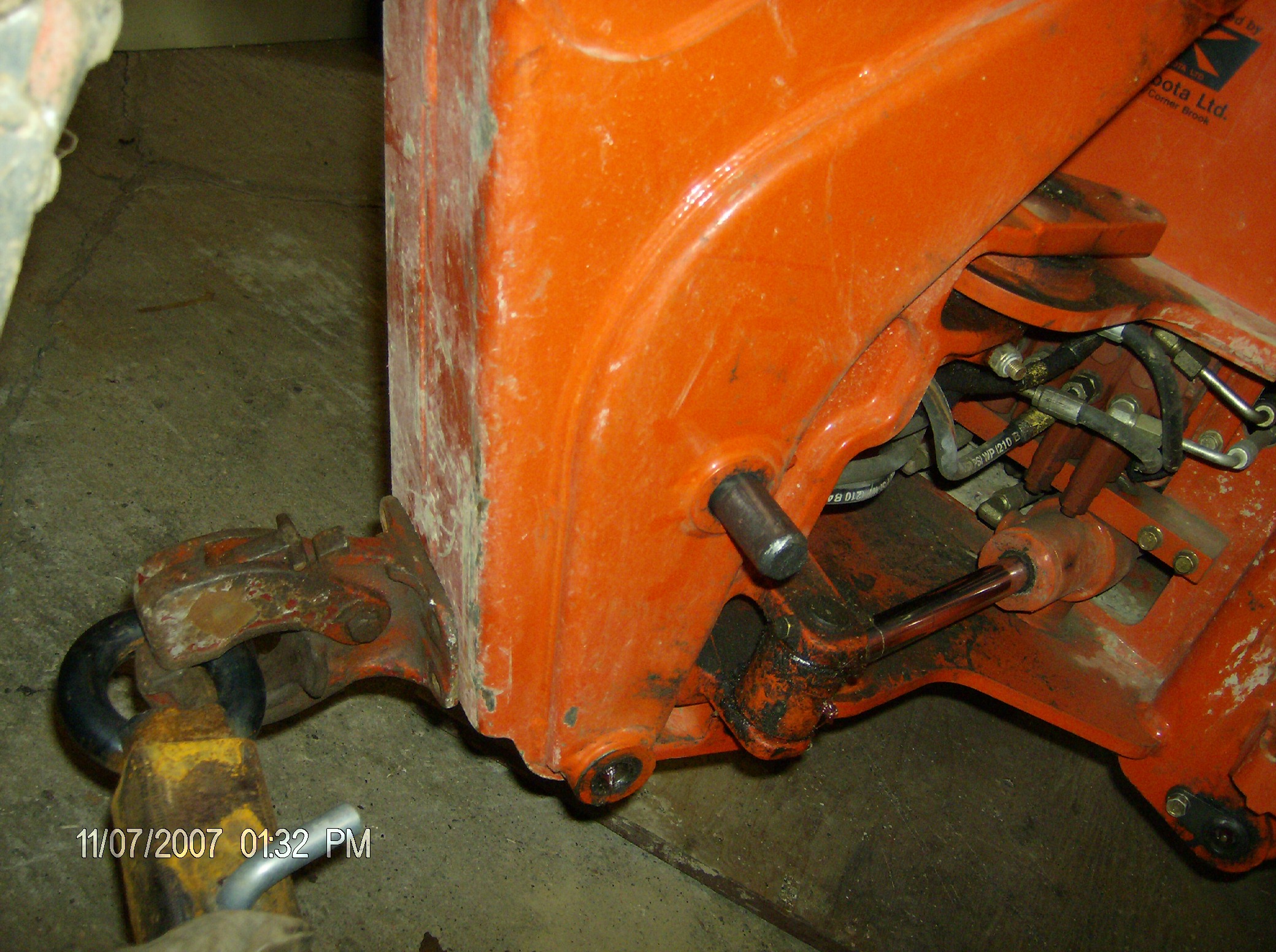

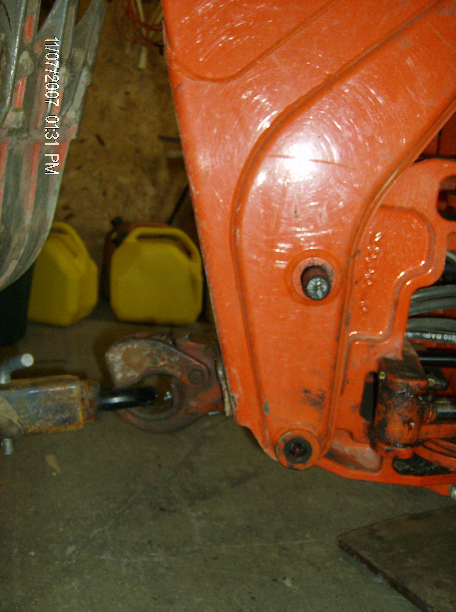

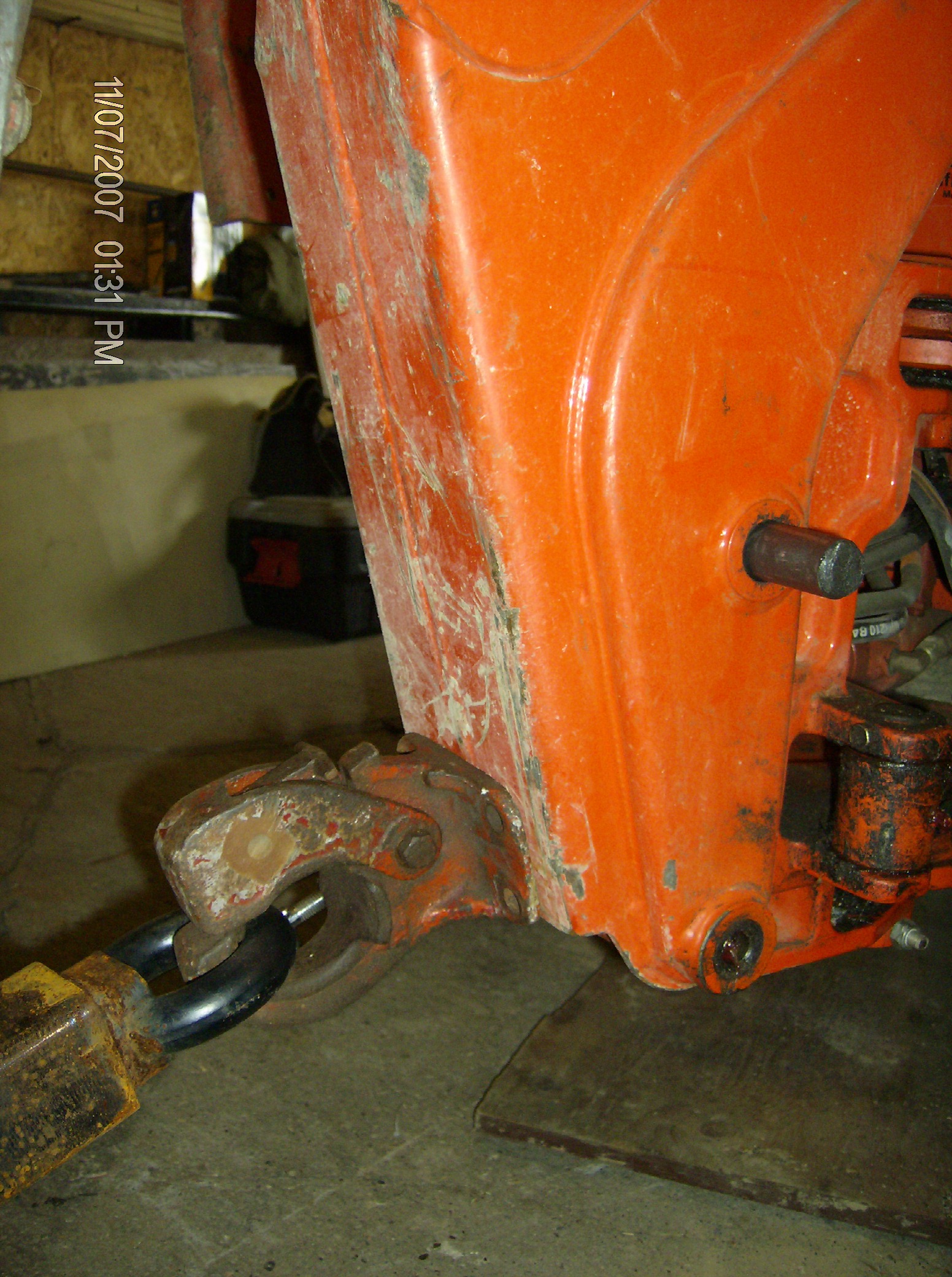

This is how I had planned on putting hitch on backhoe when I initially started this post . The reason I show this is so people will be understand what it was I was going to set up . I went with the pintel because it was a bit more forgiving especially when using it up around the cabin where the terrain is not that even and it gives fore a more secure connection. I can't see the hoe being strained here anymore than the strain it would put under during use again up here where our ground is very rocky.
Feedback would be appreciated.

If that were attached there all the time would the arm and bucket clear it when you curl it up I know mine would.but perhaps not a problem .
