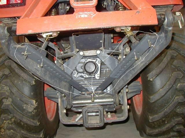

Here's how I solved the problem of the fixed drawbar on my BX. Just get a 2" hitch that has the reach and lift that you need. I unbolted the original drawbar plate and used it as a template to make the holes for the new one. Disregard the marking that I added to the pic for someone else.

/ hitch extension
</font><font color="blue" class="small">( Here's how I solved the problem of the fixed drawbar on my BX. Just get a 2" hitch that has the reach and lift that you need. I unbolted the original drawbar plate and used it as a template to make the holes for the new one. Disregard the marking that I added to the pic for someone else. )</font>
Milk,
Do you use the bolt from the the original drawbar plate to reattach the 2" hitch? Do you have any problems with the rear implement being more unstable than normal due to the extension?
jam
/ hitch extension #9
You can see how mine is attached over the original hitch.

</font><font color="blue" class="small">( You can see how mine is attached over the original hitch. )</font>
Kevin,
Is that a metal plate under the hitch bar? I like your solution. It looks practical and inexpensive.
jam

/ hitch extension #17
Here is a better pic.
/ hitch extension
#18
</font><font color="blue" class="small">( Here is a better pic. )</font>
Kevin,
How is it fixed to your tractor?
jam
/ hitch extension #19
You are looking at the bolt heads which are welded to the extension for ease of mounting or removing. Two original bolts have to be removed and replaced with longer bolts. (these are the two near the transmission).
