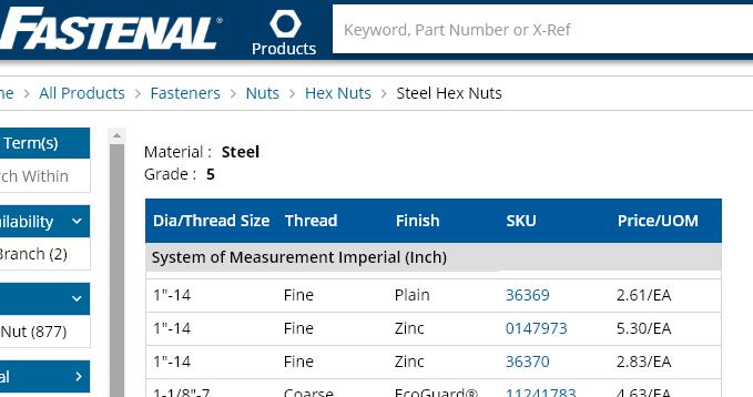

You're supposed to be able to find anything on the web right? So why can't I find the thread count on hitch balls, even on sites dealing with hitches like Reese or Curt?
On a 1 7/8" ball, shanks come in 3/4" or 1". If you lose the nut (we never lose things, do we?), what nut would we order if we didn't have any other reason to go to town to stand in a hardware aisle and try one after another? I have spares from older hitch balls, but they are coarse thread and the new ones are fine thread. Or would they even be available in a hardware store and not limited to trailer supplies?

Just look up a "fine" thread chart 3/4-16. 7/8-14. 1-14. 1 1/8-12. 1 1/4-12
The only coarse thread trailer balls I remember had internal threads in the ball and were 3/4-10

From what I can tell they seem to be extra fine thread. Good luck finding the nut in a hardware store. Fastenal might have one special order. I'll take my thread pitch gage to the ones I have later and I can give you the exact thread count. I believe all of mine are 1" shank. I'm guessing it's 1"-20.

The only one I have immediate access to check is 1inch X 14tpi....
or...
https://www.amazon.com/Hex-Nuts-1-1...1,p_n_feature_fourteen_browse-bin:11433998011
1 inch NF is 12tpi by any chart I can find...
Best "local" place to find replacement nut is probably local "U-Haul" or any place that is dealing in towing and trailer supplies.... Maybe local farm and ranch supplier in "hitches" section...

I know I've seen replacement hitch ball nuts at either TSC or Rural King, maybe both.
   / Hitch Ball Threads? #10
Okay, I checked. Mine are all 1"-14 from what I can tell with the little bit of thread sticking out the end.
