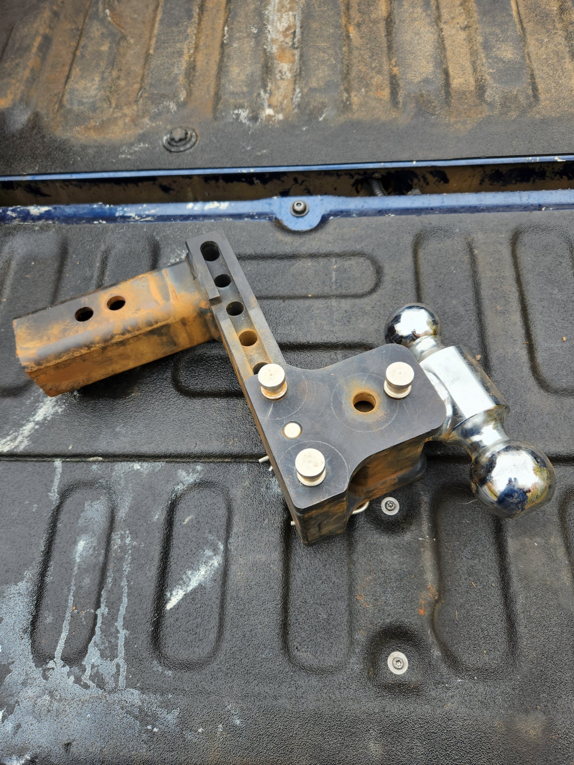

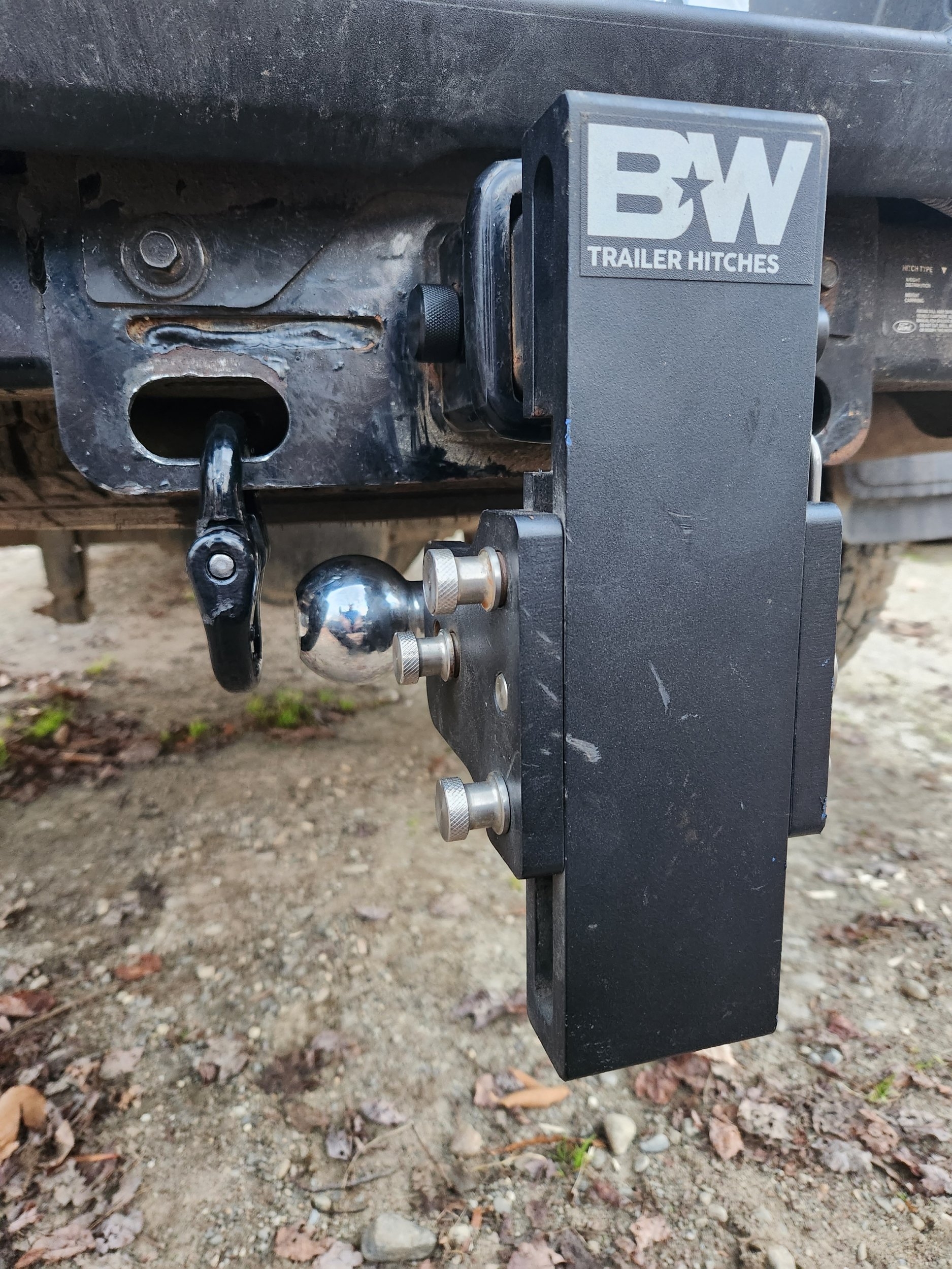

I mean, drop hitches vary; I'd question Jeffrey Brodozer's choice, but the one I've got is rather stout. This came with the truck, which was nice, because they're pricey.
This inspires a little less confidence.
