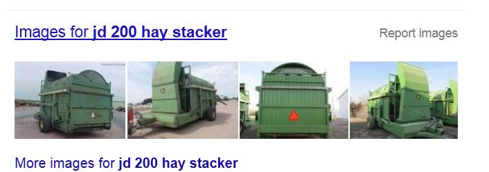

The other day I saw a guy baling hay with a HUGH baler. The bales were rectangular - probably 5-6 feet wide by almost 10 feet long and 6-7 feet high. They had very marked crowned tops. I'll bet each bale was at least 6-8 tons. Like to see what is used to move those bales - - -
   / hiring someone to make hay #12
oosik
Crowned tops sounds like a hay stacker not hay baler. Hesston & JD made stackers back in the 70's-80's.

Tx Jim,
Those thumbnails are the same thing I saw him using. First time I ever saw anything like that. He was using it to put up very thick, heavy bottom land field grass.
   / hiring someone to make hay #15
I sold one of the JD model 200 stackers back when I worked for a JD dealer.
When I worked on a farm in the 80's he had a stack mover. It used the 3 pt to lift along with hydraulic powered wheels to lift. It had a set of tines on the bottom to lift. It was all a 4020 could do to move it. That w as for the 100 stacker. The 200 was twice as big and stacks had to be fed where they were unloaded. Too big to move.
