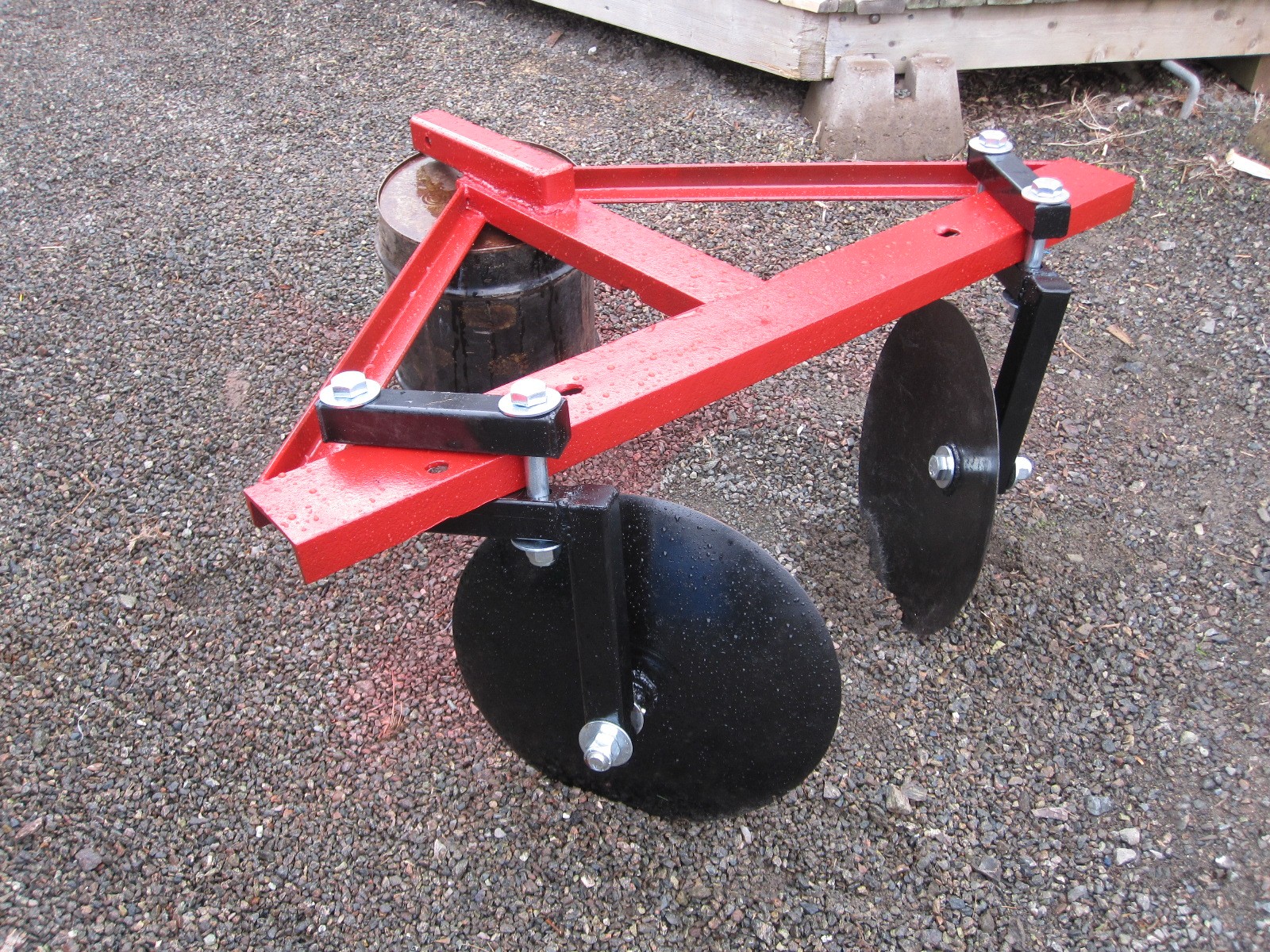

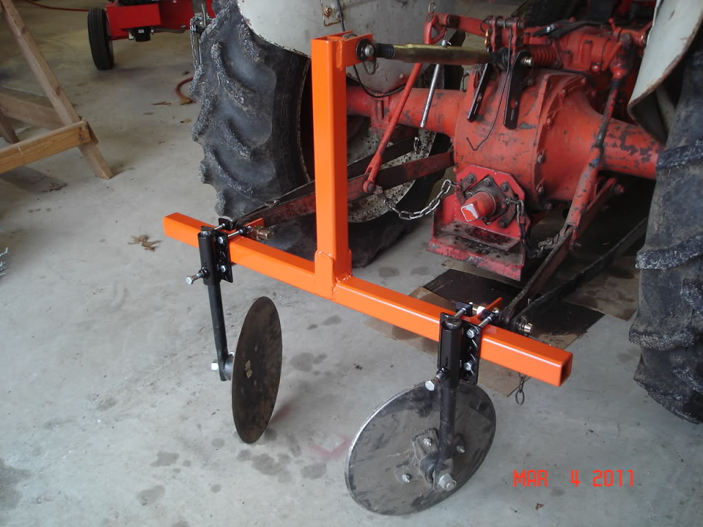

Here's my version. For a complete, numbered, multi page, highly accurate set of blueprints, send a postal money order for 299.99. :D Or.....just take a really good guess to the measurements, and fab it up. Got the shanks and discs here, Agri Supply - Search. Mark

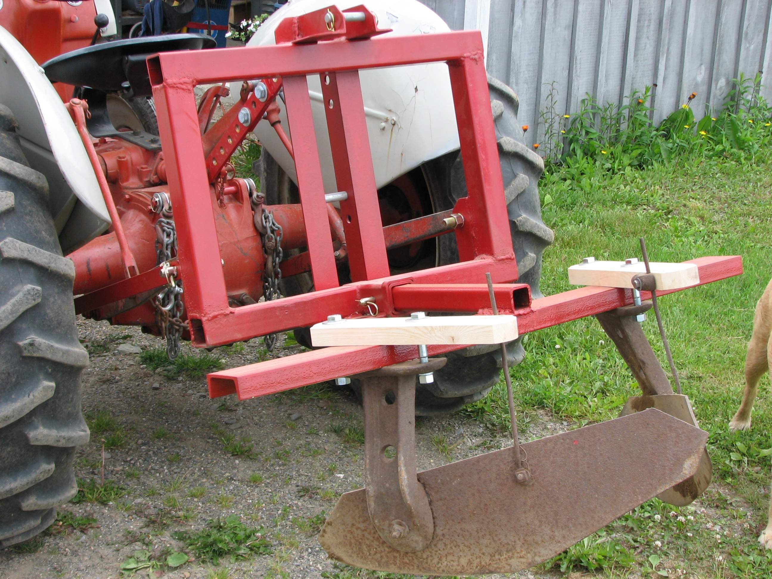

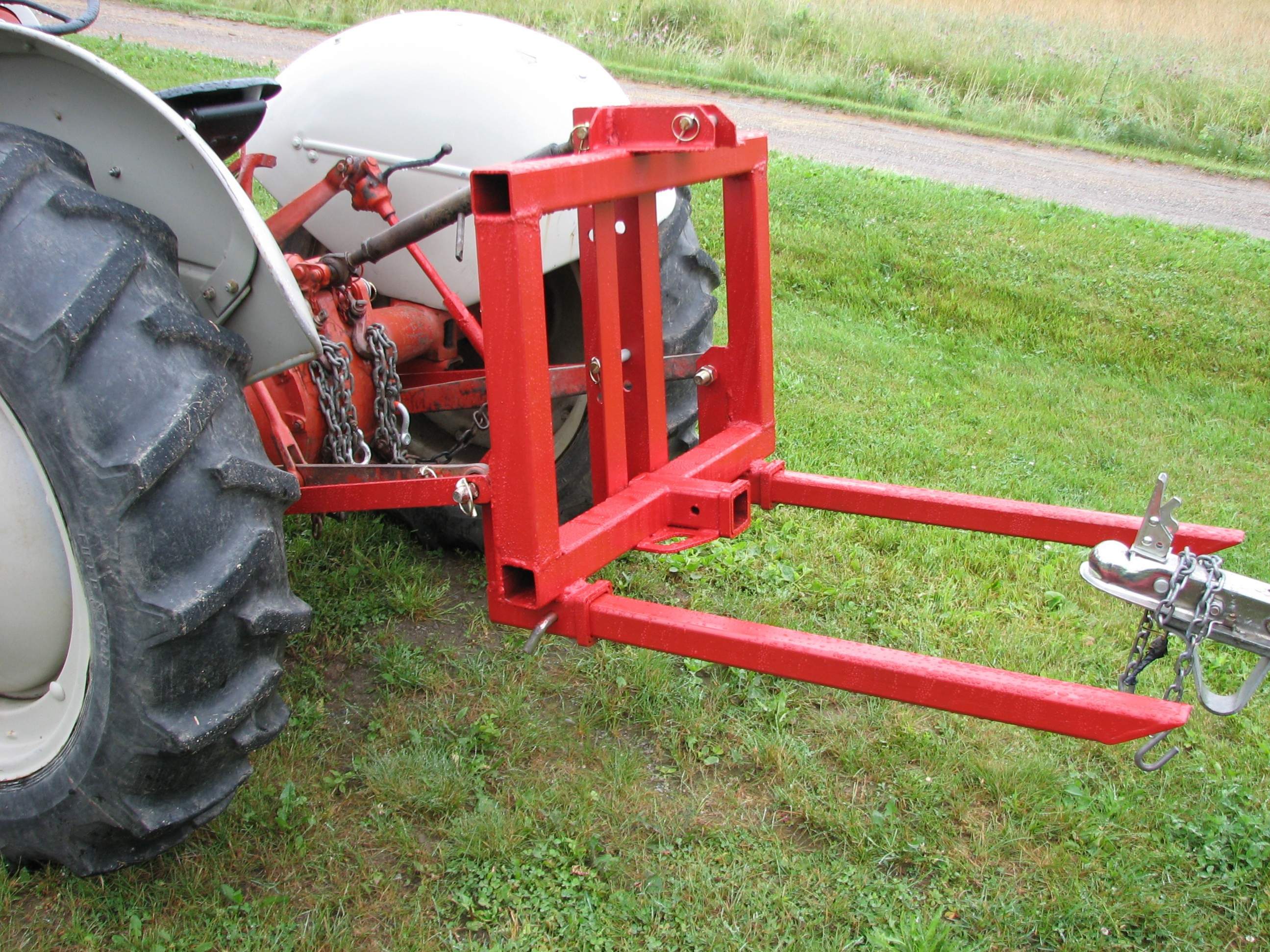

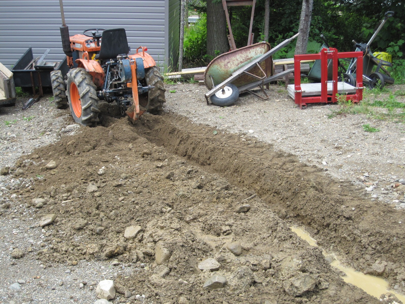

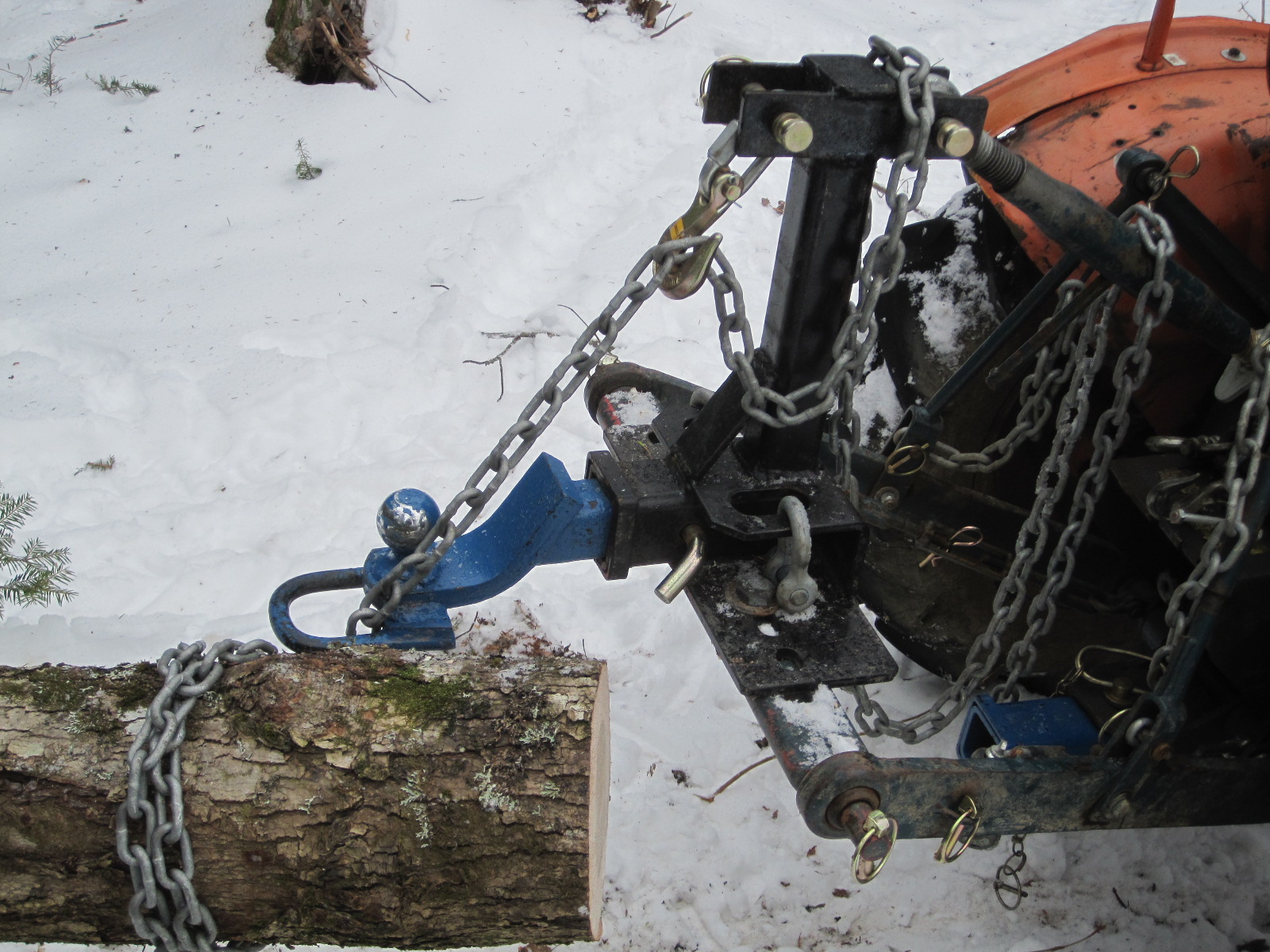

Built a couple to use with my '47 Ford 8N & my 1980 Kubota B7100. The first was built using the metal pieces from an old horse-drawn set found at a dump site. 2nd set was built using a couple of replaced discs from an old Massey Harris (Ferguson ?) disc harrow (which I still use with the Ford 8N). Both work great & attach to 2" receivers I welded up that bolt to the 3 point drawbars on both tractors. The drawbar attachment also worked great skidding out firewood logs a couple of weeks ago.

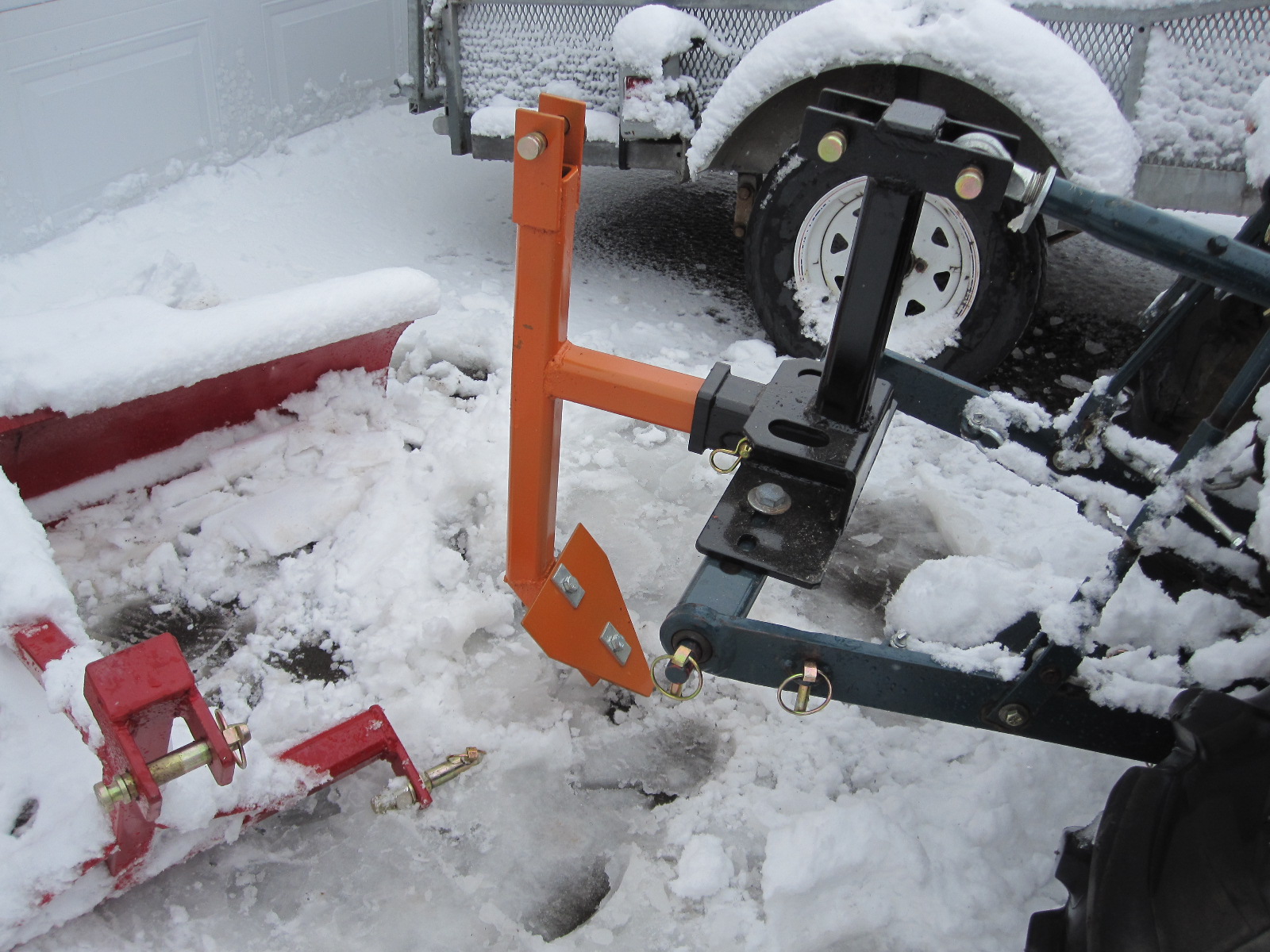

You can also add the discs from Agri Supply to a one row cultivator. Works great for hilling and weeding potatoes all in one shot..
This is someone elses picture, I used part of a Freightliner frame to make the 'upright' for holding the discs. It bolts together in seconds.
