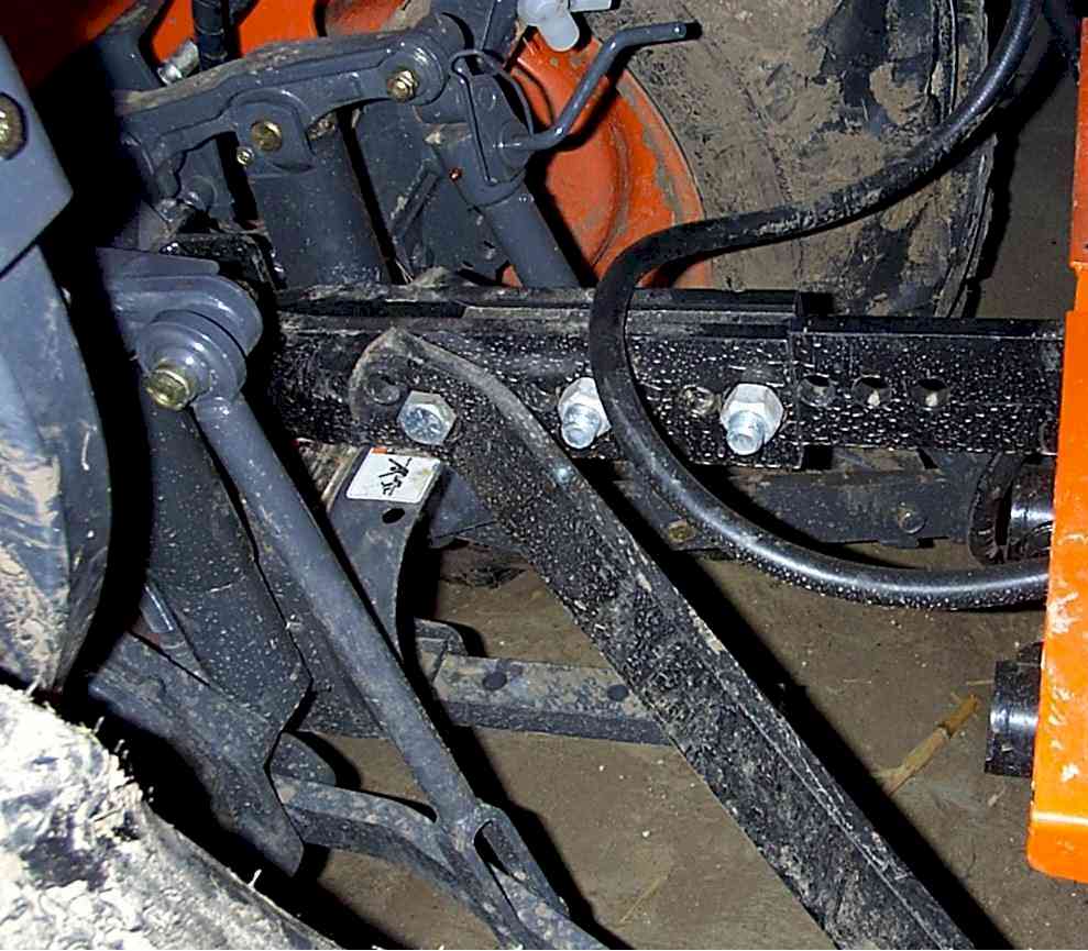

Here are some pics. You can't tell anything about the pin but you can see that there isn't any room. If I had a straight shot at it I'd use my air hammer with a punch. That would knock it out in a hearbeat. The only way I could do that is to remove the 3pt hydraulic arm.
The might be enough room to get a saws all in there, it would be tight.

pic...

pic.

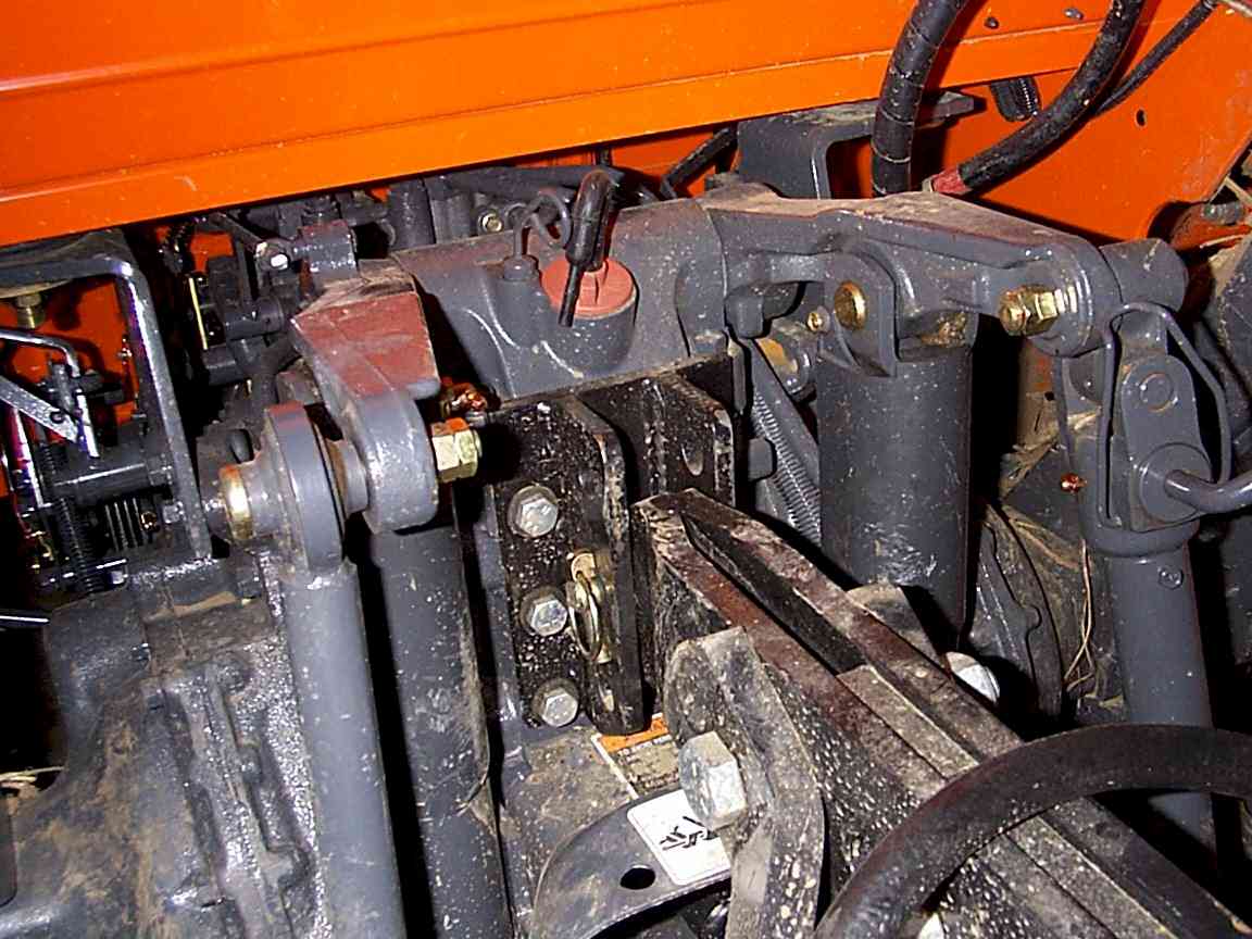

You can see in this pic how little room there is.

The BH has what called the safety lock that should keep you from getting smooshed. I agree with you and will not use it until this is corrected.
Thanks everyone for your input. It looks like taking the 6 bolts out for the top link bracket is the ticket. Then drive it out with the air hammer.
Thanks

I called the dealer and he sid they installed what came with the BH. Then I called Woods. Woods stated that the 9000 BH is NOT designed to be used on the 3pt of the L3130. It is too much weight and thats why the pin bent.
The dealer already has the 4pt(not subframe like I thought) on order from Woods. This is what I wanted in the first place but appearantly it wasn't available or the dealer didn't realize it was.
Bottom line Woods said DON'T use it until the 4pt is installed. Otherwise damage may occur.

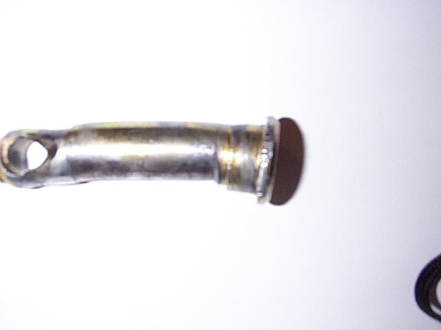

Well today was a nice day out so I took the bracket off. The air hammer had to work a bit to get the pin out. The pin was starting to shear.
