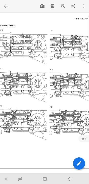

You might need to pop the top off and make sure there isnt a problem with the gear mesh. You should be able to see any issues from the top side.
I attached an image of the 6 forward gears, in grey are the two gears for high and low. You can see them at the top of each.
Hopefully it isnt a fork problem. Maybe someone else put it back together in the wrong spot? Screenshot_20190131-172323_Adobe%20Acrobat.jpeg

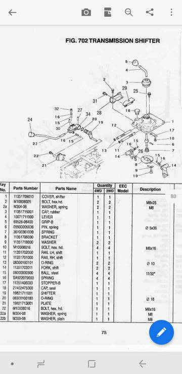

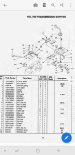

Yeah it's just the safety starter switch.
As you can see from this image, the high and low speed shifter is not that complex. If it's not the linkage, then its internal. Screenshot_20190131-174730_Adobe%20Acrobat.jpeg

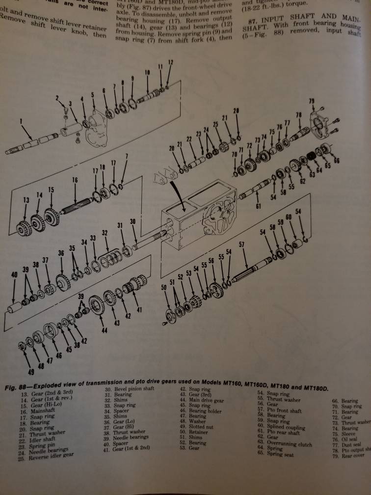

If the MT160 is designed like my MTE2000D, the H/L gear is slid on its shaft by a pin on the end of the shift lever ( no fork). Take the top off the trans case and try moving the shift lever, you should be able to see what the issue is.
On Edit; I just looked at the manual and the range gear shift mechanism is the same- a pin on the end of the shift lever. Your issue should be easy to diagnose with the trans cover off.
   / High / Low Gear MT160 #8
Yup Kernopelli is right (and faster at reading than me too!).
Number 15 is your hi-low gear, just in front of the case bracket. If it moves on the shaft a bit, then it is the "range shift arm" that goes through the case that is seized up. 20190201_100421.jpeg20190201_100433.jpeg
