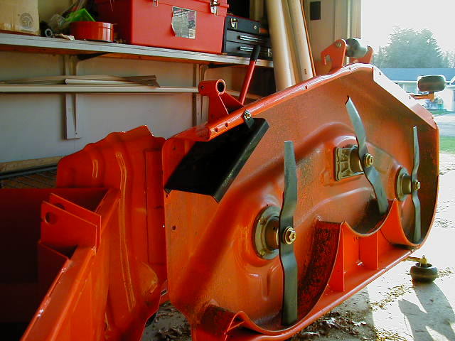

If you have the 60"MMM did you get the boot with the deflector chute? On the 54" they don't supply the chute, but on the 60 they do. Here is a picture of my unit when I installed it. It helps deflect the grass back into the hose better thus reducing plugging I think. I can still plug my Kubota Bagger from time to time if I go to fast or it is to wet.
The deflector is the black piece you can see in this photo.

I did buy the Kubota boot, but I didn't get a defector shute. Does the shute back a big difference? I do have the 60mm.

You can make the part or you can order it from Tractorsmart. Here is the information.......
Original Part Number 70050-94652
Current Part Number 70050-94652
Description DEFELECTOR, WLDT
Pack Quantity from Kubota 1
Price Each $23.70
For the complete parts list for the Kubota BX grass collection system, click here...... and then go to the section that is marked on the right hand side of the page..."Boot"...

I am not sure if it makes a big difference as I have only used it with the deflector on. I assume thought that it is important for the 60" or Kubota would not spend extra money to make it as they don't require it on the 54".
For the $30 I would probably get it and find out myself.
