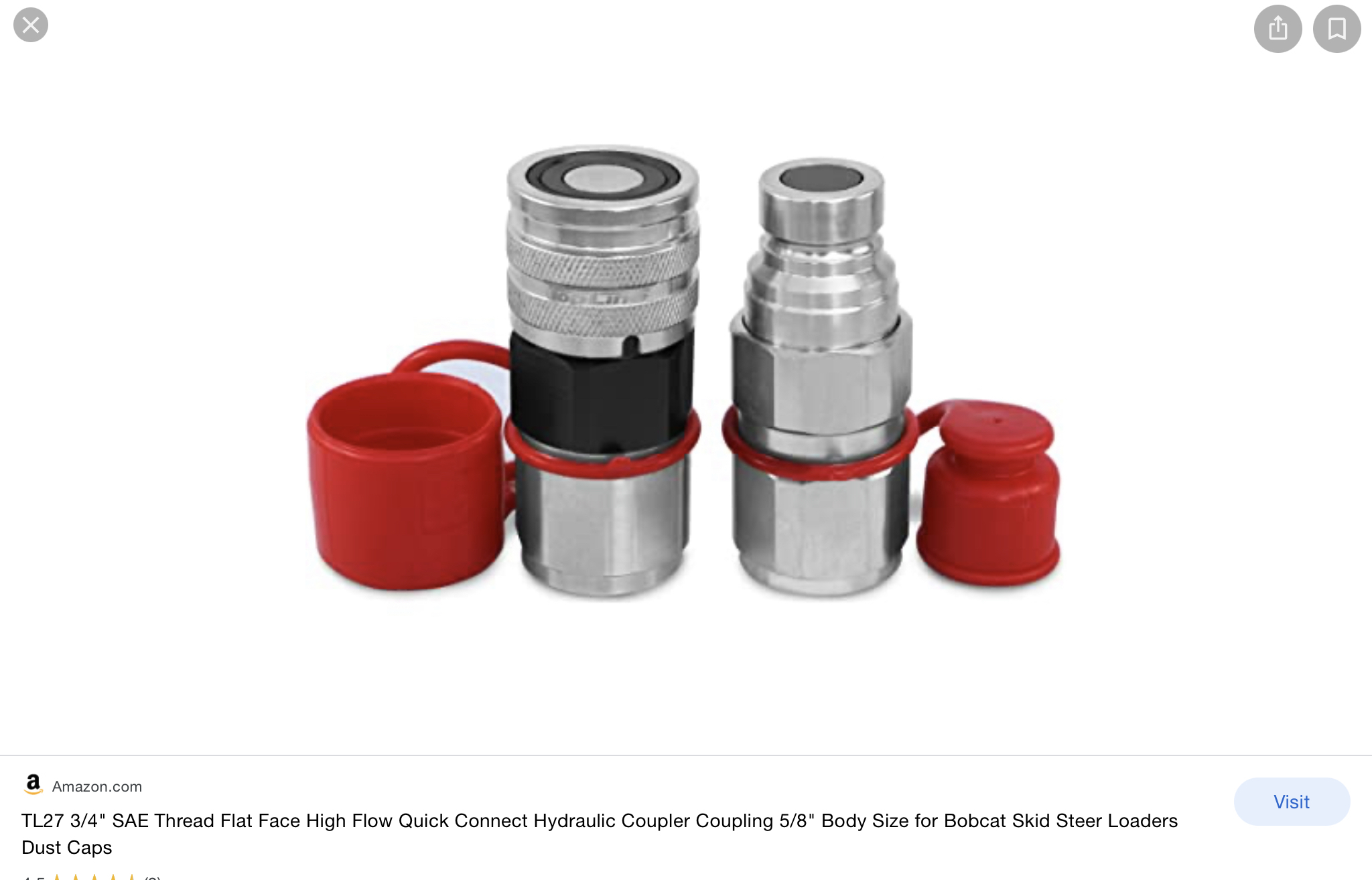

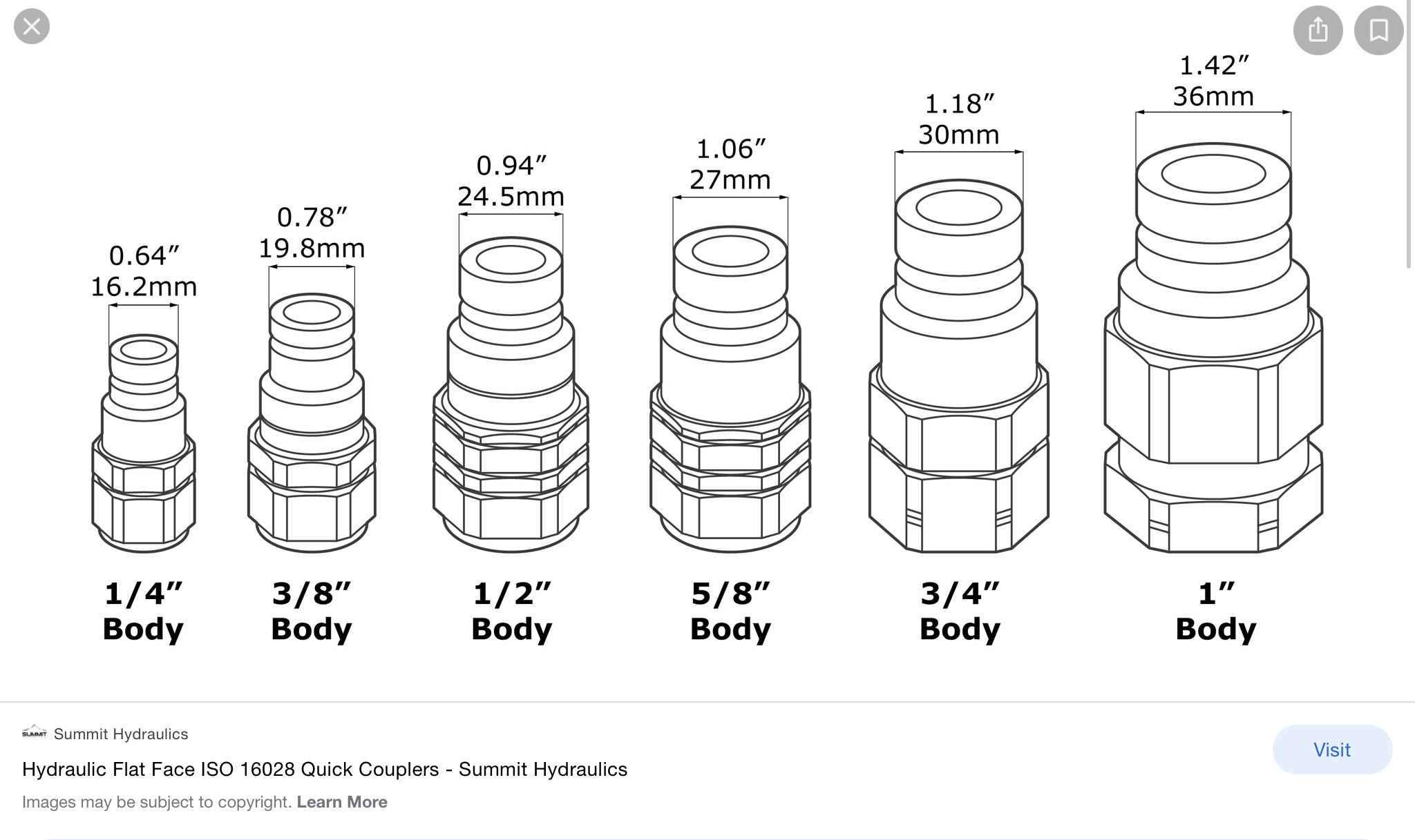

1/2" Flat Face couplers are considered to be standard flow. 3/4" couplers are generally used in "high flow" applications. There are a range of coupler sizes just like most styles.

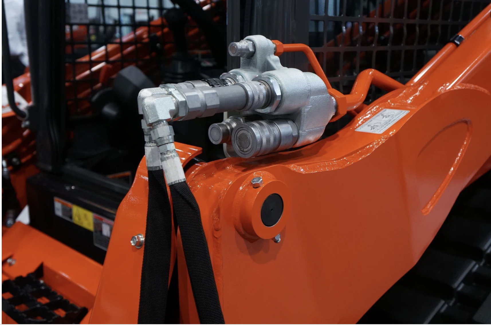

Skid steers and CTL's with the high flow option typically have a pair of couplers for standard flow and a pair for high flow applications as well as a case drain connection. The couplers pairs are manifolded to a single pair of supply tubes.
