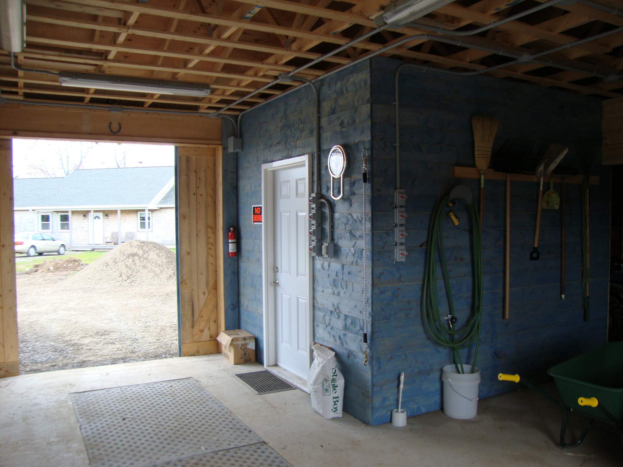

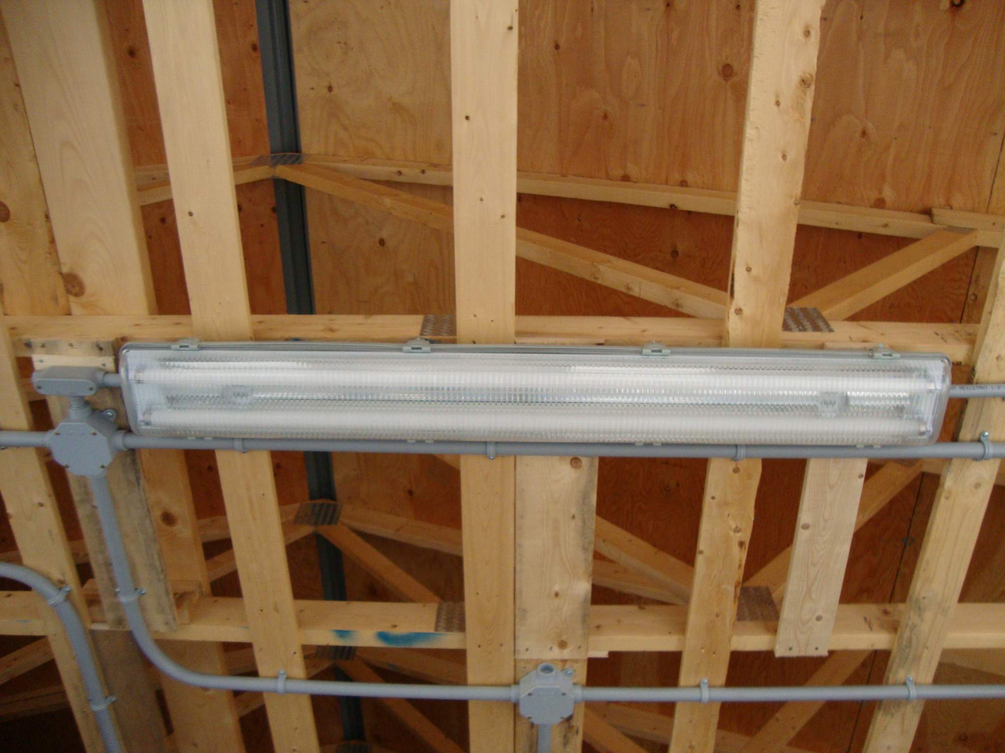

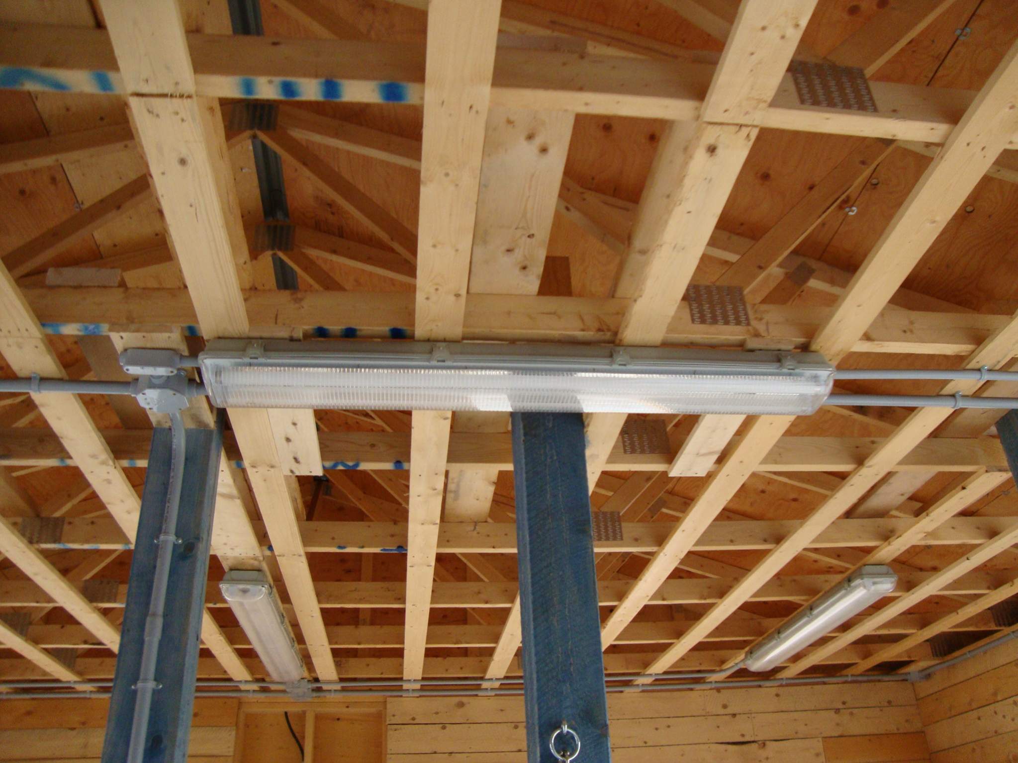

Late posting, but these are the ones we installed in our new barn, very nice light.
Sean

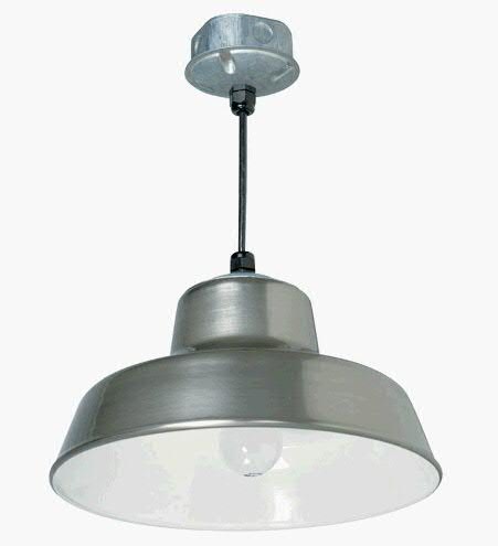

When you guys recommend T8 for 12 foot and T5 for 15 feet and higher, are you saying the T5 HAVE to be mounted higher since they are so crazy bright? I have a 12 foot white ceiling and white walls and want to evenly light the space for automotive work and general fabrication, with the smallest number of fixtures and with an eye on electrical efficiency. The temp will run as low as 45 in winter. Sometimes when I am not working in this building, but just popping in to get something or open up and get out the tractor, I might want to hit a seperate switch for some reduced output incandescent type fixtures, so I am thinking about sprinkling in a few of these too (see attached pic of pendant barn light):
Anybody know a less expensive place to buy light fixtures???

The recommend 15 feet for T5, but i have one about 10' above my work bench...its like working in sunshine. I love it. I can get 4 lamp t5 High Output (4 x 54 watt lamps) fixtures for about $119 including lamps. Not sure what your area gets for them. I just dont know how a T5 will work at 12'. You might have to install one and then judge the light output. then you could figure out how many youll need and the spacing. You could always wire one of them to a separate switch for small amt of light to just pop in.
