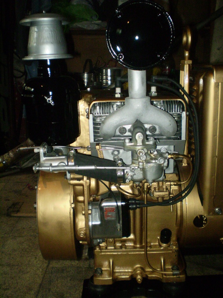

Hi all. Thank you for accept me in your community. My name is Alejandro Barrera. I like to share with all of you a pictures of my engine Wisconsin 1954 mod T F assembled in a generator welder Hobart mod GW-222 in almost complette restoration. Please go to Flickr: emynder's Photostream I hope you enjoy it. Thanks

Alejandro, welcome to the TractorByNet forums!
Wow! That is a beautiful restoration. Your photos are excellent.
How long have you been working on it?
What parts did you have to make? The rubber air intake pipe/hose? Any other parts?
Have you tried to use it yet?

Hi Mr. Ted. Thanks for enjoy the pics. The restoration has began since 5 years ago (september). The engine was found in very poor conditions. The engine parts was disassembled one by one ( I mean ALL) was cleaned carefully and I was thinking never can finish, but my customers and friends tell me GO AHEAD. I haven't pics from the beginning because this project was a simple game for me. The choke area has been modified from the original specs and in his place I was adapted a shutdown switch The rubber pipe is used in a radiator cooler from any kind of engine, just was cutted to exactly size for good look. Of course the engine runs fast and very very well. The welder generator works at 100% for any kind of welding test. Daily I run the engine for get ready when somebody want come to see it and test it

The choke area has been modified from the original specs and in his place I was adapted a shutdown switch .
I don't understand "shutdown switch". The "choke" reduced air flow to the carburetor. What does your "shutdown switch" do? I'm curious! :)

Maybe you can't understand because my english is not very good. I like to say button switch off. The air flow get in very well because the choke control always is open. Just I use it for when the engine is in off process for keep gasoline in valves area for easy start again. I'm a welder man since 1985 and I work for my own. If you want to know about my next project this will be a restoration of an antique welder generator ASEA. When I get the pics I will send it for you

/ Hi from Mexico City #16
Welcome Alejandro.
That's a beautiful job on the Wisconsin welder. The name plate seems to indicate 200 amps and 25 volts open circuit. Is that right?
The commutator seems hardly worn. Did you have it turned down (on a lathe), or had it just had very little use.

Hi and thanks. The engine works really good, but don't be used because after 5 years of restoration will be a shame if for any reason is spoliled the paint or some of his components. By now still in show piece. Anyway welds terrific. Soon I will upload a video with the engine welding. I suppose so you have seen the video YouTube - Wisconsin engine Mod T F 1954 showing the engine running
/ Hi from Mexico City #20
Great video!
I noticed that you started it with a full turn of the crank or more. As a youngster I was taught that you should limit it to a quarter turn of the handle and then to pull the handle off the shaft because the impulse magneto might cause it to fire the spark plug early and kick back. Does yours ever kick back when starting?
