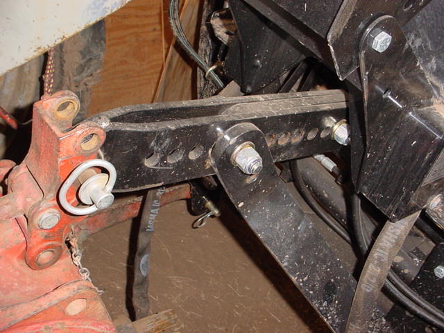

Attached is a picture of my top link mount for the Bradco Backhoe.
Does anyone have some detailed pictures to attach?
Several examples and designs will be needed to get some good ideas.
I can only guess that 3 PT BH's are available only because of market demand to get a quickie Backhoe. And not because it is the best or safest way to go.
I do have to agree that the 3 pt BH puts ALL the stress on the top link. This is what I have. The Bradco models we have 3265 & 3375 were designed for 3 PT.
The steel brackets for the 3PT mounting kit that comes with them are very massive and stiff. However everyone is correct in that all the digging stress is sent to the top link pin. I will be careful and yous guys have me convinced I should start thinking and looking about getting / desigining / buliding a sub frame. I do respect your experience and wisdom. Your persistance is paying off - keep it up to educate guys like me! /forums/images/graemlins/blush.gif (Humbled)

Here is a picture of the lower end of the mount showing the lift arm and the "triangle" 3 point mount system from Bradco. Sorry about the trashed tractor - just got back from pulling some poor fool that decided to try and drive down our impassable mud "road".

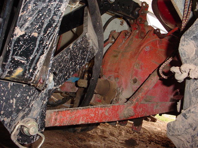

The problem is not necessarily the link itself... looks like yours are pretty strong. But here's a photo of what can happen when you overstress the 3pt attachment points on the tractor. This is a photo of a Kubota (it's not mine, but it's the same model as I own, so it touches close to home for me!) with the whole back end of the rear differential ripped off by a 3pt logging winch.
If you were digging and prying with the backhoe and something like this let loose right underneath your keister, it could ruin your whole day.

OUCH! How do you go about fixing something like that, or do you??
   / Hi everyone. NewB with dumb ?? about backhoe #28
Yikes /forums/images/graemlins/shocked.gif - that's not going to grow back.
I cheked out all the posts for the link you supplied. The subframe is a fine feat of engineering. I think I am going to be wearing extra padding under my kiester from now on. Thanks for sharing.
   / Hi everyone. NewB with dumb ?? about backhoe #29
This picture was actually supplied by one of the other TBN'ers, who I think was going to repair it for the owner. Never heard how it turned out, but it would basically involve a new rear end casting and the dis-assembly of the old internals and re-assembling them in the new housing. Maybe not too costly on parts, but lots of skilled - and probably expensive - hours doing the job.
