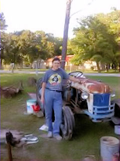

Rtv - DUH. It's been many years since I've done any wrenching. I use to use that a lot - way back when. :rolleyes: Never would have thought of the alcohol. Makes sense to help dry up the water.
This is my first tractor so it will be a learning experience. I've been studying everything I can find online and in some books that came with the tractor. Over all, it seems to be in pretty good shape for it's age and lack of maintenance.

a good service manual to get is an I&T FO-4 if it is not a version with parts diagrams in the back.. then a master parts catalog too. the MPC is about 20-25$ and the fo-4 is about 30$ or so.
great resources.
there is a reprint owners manual for about 5-15$ depending.
the owners manual is the least helpfull of the 3 for maintenance and repair.. however.. for a first time tractor owner.. it might be worth the $$
i can't see from your small pic if it is a front mount with crab cap. or a side mount.. but here is a list I have of oil filter cross ref and front and side mount auto parts sotre ignition parts that are good to use. avoid tisco ignition parts. like tsc. they are cheap and don't last long.. IMHO..:
