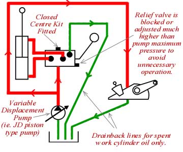

I have two tractors--Kubota B 7610---AC 6060(for the big stuff)
My latest project is to put a clam set up on the Kubota bucket--the problem is I'm out of hyd. taps. Need info on tapping the system to add a two way cylinder. Also don't understand the (power beyond) line. Thanks Bob S

As far as the PB, if your valve has a PB outlet, you can add another valve in series with the other valves. You can also add a solenoid controlled selector valve that uses the bucket curl hyd supply. No voltage uses one side of the valve. When voltage is applied, the hyd shift to the new cyl, and your curl lever controls the action.
https://www.surpluscenter.com/item.asp?item=9-5117-A&catname=hydraulic
   / Hi All from new member Bob S need help on kubota hyd's #6

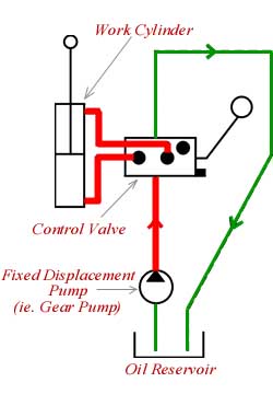

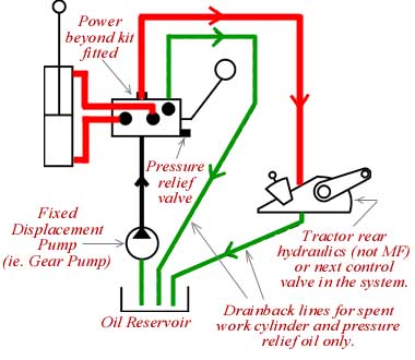

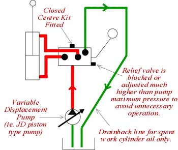

If your looking for PB info do a search in hydraulics there is a lot and I learned everything I know about the subject from the threads. As far as J_J suggestion, that's the way I'm going. The only difference is I'm using this selector: https://www.surpluscenter.com/item.asp?item=9-7852&catname=hydraulic . It's $10.00 cheaper and only has one electrical connection. If you look at this site: ANBO Manufacturing Hydraulic Diverter Valve , they sell the exact same valve (haven't found a price to compare) as part of their "Hydraulic Diverter Valve Kit". The first 2 picks are PWR Beyond, one with and 1 without it being used. The 2nd 2 show a variable pump were pwr beyond is not needed.

Thanks for the info JJ--looks like elec/hyd is the way to go. Also thanks to ch47dpilot, the picks help alot. Thanks to all Bob S
