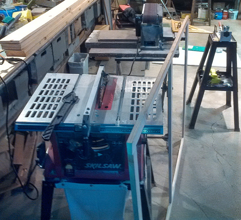

Below is a photo of what I'm building - frames to mount fine-art canvases. The frame has to bevel inward on the face side so you don't see the outline of the frame when looking at the painting on the face of the canvas. And the center stiffener has to be double-bevelled then sanded down even thinner so it lies behind the surface of the painting. The belt sander evens out the occasionally uneven bevel I got from the table saw.
There's a couple more interesting things in this picture. The pocket-screw jig clamped down temporarily to the grinder stand is from HF. I used it for the corners of the frames, to assemble them as 90 degree butt joints. The grinder stand is also from HF. Both are excellent, recommended. The yellow square clamped to the disc's table is from HF. Excellent. This was to make the ends of each frame component perfectly square so the corner butt joints would result in a square completed frame. I accomplished good precision, a later test with a framing square showed each of the completed frames was under 1/16" in 16", variation from square.
Don't bother with HF's $4 corner clamp, its junk. I tried it on the first frame. Tightening the screws just flexed it and pulled the frame out of square. I had to dig out an ancient Craftsman equivalent and use that instead, to clamp the corners in place when I installed the screws. Maybe HF's more expensive versions work better.
And the Skil table saw is from Lowes. Its a twin to HF's version but includes the stand, making it less expensive overall than buying the same thing at HF. The sawdust bag under it is from HF. (But most of the sawdust seems to be thrown toward the operator instead of into this bag).
