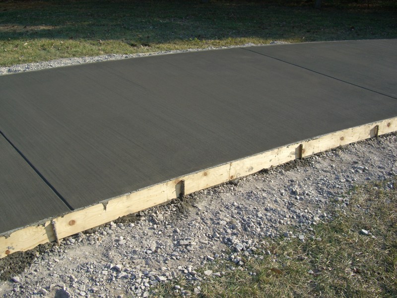

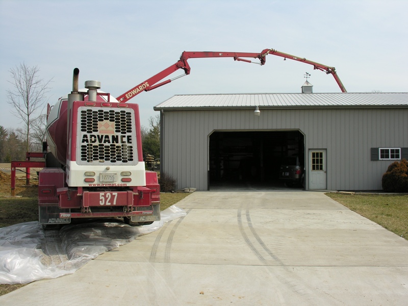

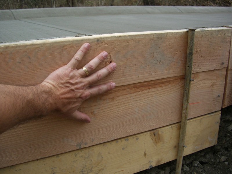

I attached some pics of the driveway work for reference. In one shot you can see that I poured about 16" to 18" thick on a run up to the bridge. That is the area that is backfilled at a really steep angle. In another picture you can see just an average 8" thick area before backfill. And, in the last picture I just wanted to show one of the 3 pumper trucks they used for the 4 days of pouring 375 yards of concrete.

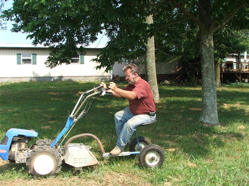

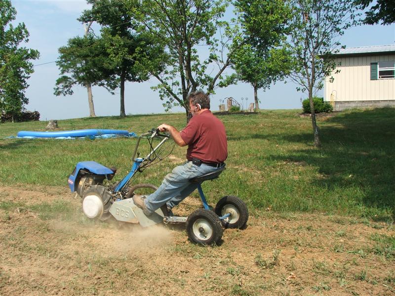

Dargo, here's a ride behind tiller, the BCS has a tiller transport wheel that is a caster wheel that goes under the flap behind the tines and also a transport sulky when you have the tiller and the transport wheel attached. I have the transport wheel and the mower sulky and after about an hour in the garage with some scraps and a lot of noise, I now have a transport sulky/tillerrider sulky. Still have some tweaking to do before I paint it.
