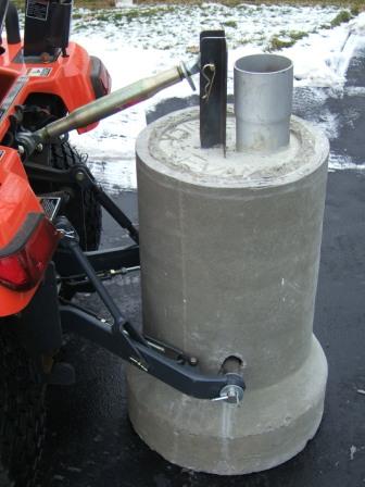

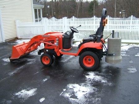

Ballast threads are abundant - so here is what I learned from TBN
Make is close - tight to the tractor
Don't make it top heavy

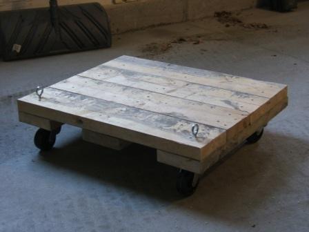

And always have a good dolly to make mount/unmounting easy...
It's a drain pipe left over from street work, cut down and filled witgh concrete, and a tool holder (4" pvc pipe) for good measure.
I estimate it weighs about 325# - but math was never my strong point.

I can understand the need for ballast but just wanted to ask whether a rear mounted implement would serve the same purpose? Is this ballast setup heavier and/or more maneuverable? Just trying to learn :)
   / Here is what I learned from TBN #6
It should provide more ballast in a more compact size, than an implement hanging off the back.
Nice job c-and-a!

Thanks for the comments folks...
I have taken the MMM and Bagger off for the winter - so this takes up far less room in the rear allowing me to maneuver easier for the driveway clearing in the winter and it will assist in moving 20yds of mulch in the spring - again, lotsa of back and forth in tight areas...
