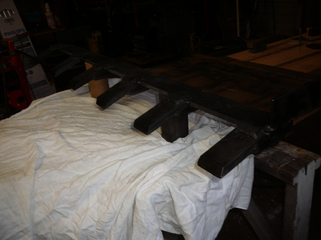

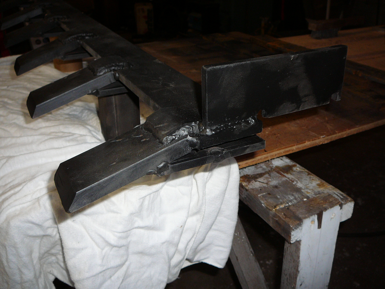

   / Here is a couple home built attachments #12
New Crusty design toothbar, $16 new steel, $10 scrap.
49 inch for my bro in laws mini JD.
Thanks Crusty!!
