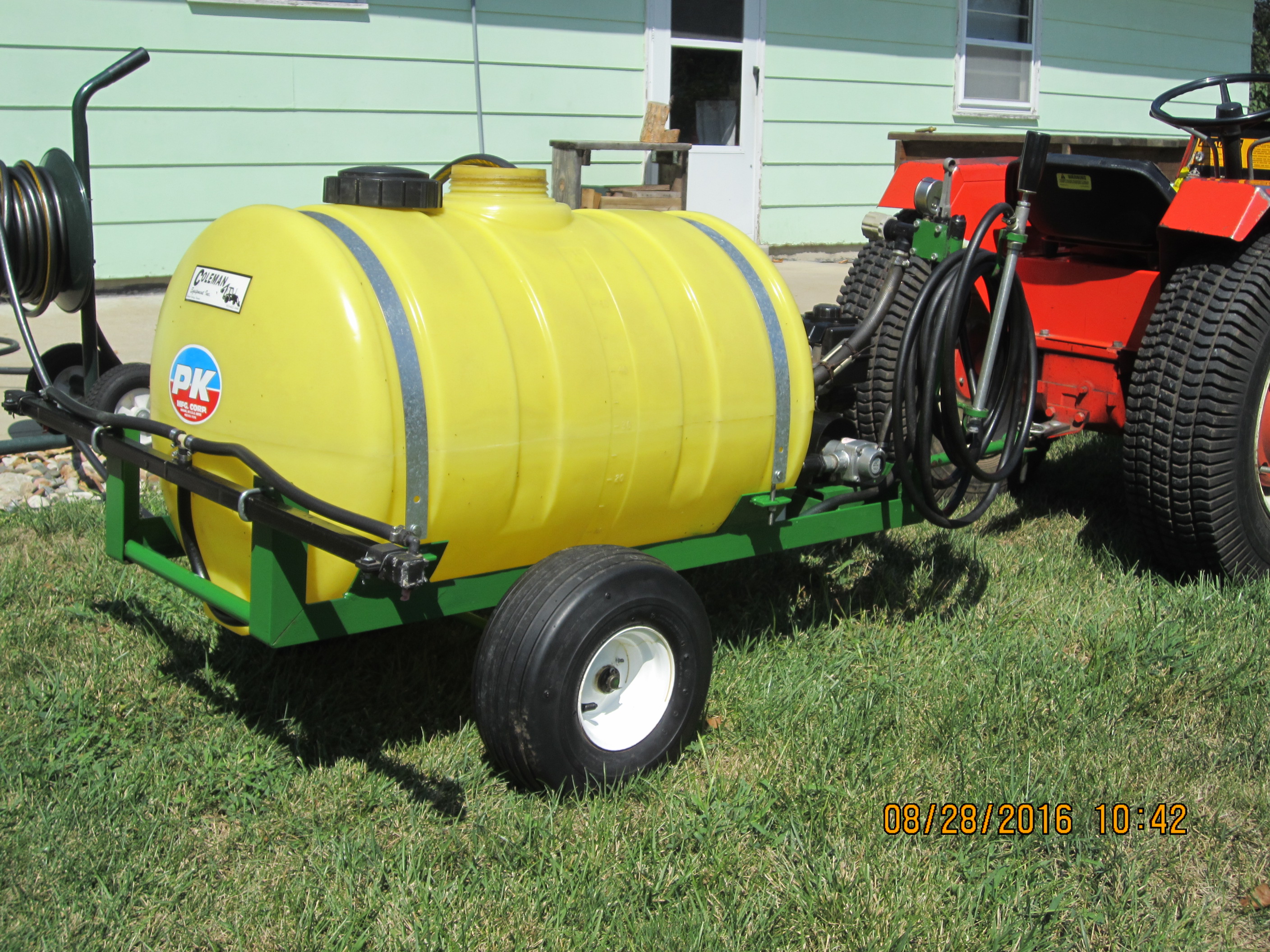

Whated to start an herbicide discussion. My lawn is anything but nice. And don't really desire a golf course lawn either. But have ALOT of weeds.
Dandilion, broadleaf plantain, buckhorn plantain, some viney yellowing flower things (creeping buttercup I think), and lots of clover.
Sprayed basic amine 24d in the spring at 1qt mixed with 30 gallons water per acre. Obviously fall is the best time, but a gallon of 24d is cheap, and I was spraying the yard anyway with insecticide.
So been reading about herbicides until I'm cross-eyed. Lots of big words. The weeds aren't really that big of a deal, but stemmy weeds like the plantains, red clover, that yellow flower crap...cuts like crap.
So...what do you guys spray? Seems there are several different things that they mix with 24d to have two active ingredients, as well as some have 3. Of 20 different products I have looked at with 24d, it seems none have the same combination of ingredients.
And the more I read, it kinda has me re-thinking wanting to kill the clover. As it is claimed to add alot of nitrogen (which the grass needs). And that if I kill EVERYTHING but the grass, I will have a high maintenance lawn that requires fertilizer. That's not what I want.
So is it possible to kill EVERYTHING but the grass AND clover. The spring spraying of 24d seemed to do nothing. Things wilted for about a week, then turned green and healthy again.

I'm pretty certain the MCPP will kill the clover. Check to see how the chemical works best. Hot weather yes, but perhaps the lawn must be irrigated/actively growing and not under stress.
Just keep in mind IF you have large expanses of clover and IF you are indeed successful in eradicating it, new lawn in the form of seed, sod, or sprigs will be necessary to REcover these areas to hinder future weed populations.

LD1, I'm pretty close to you here in Ohio and have the same weeds. This is what I do, and it works well.
Trimec from Rural King. I buy it when it's on sale and have it on the shelf so it's ready when that perfect weather day arrives and I decide to spray at moment's notice.
Surfactant from Rural King - Drexel Hum-AC 820. I get a gallon and it lasts for years. It makes all the difference especially when battling the tough weeds, but I add it to every spray batch.
Crossroads from Rural King. It's the generic Crossbow, and works well on brush and poison ivy, and I occasionally use it on the tough viney weeds (and clover) in the yard.
Trimec will knock out clover when you add the surfactant. That makes all sprays work better since it's getting the leaves soaked by breaking that surface tension (especially on clover and ground ivy). I've used Trimec for years, and it didn't control my clover at all, until I started adding the surfactant.
I try to spray once a year and that controls things pretty well. Sometimes I spray 2 times but that's rare. I spray spring or fall, when the temps are not too high, and the weeds are growing actively.

LD1 I will change hats and attitude now. (annoyingly **** to relaxed and humorous. :) )and offer another suggestion.
Four acres is a good chunk of lawn. If you're not looking for a golf course, consider spraying for weeds as planned....
Then in the fall (early - mid September) overseed the entire area with a hard fescue suitable for your climate. (You will need to be prepared to irrigate if it doesn't rain).
You may need to redo it in varying degrees in subsequent years in order to keep your desirable grass population at a level to suppress new weed growth.

Trimec is labelled for lawn and turf use. Crossroads seems much more harsh and I don't like the idea of using it across my entire lawn, especially with a well. When I use Crossroads on my lawn, it is only on small problem areas, usually with a 2 gallon hand sprayer, or 4 gallon backpack at the most. Also, Crossroads will kill shrubs and trees if it drifts, while Trimec might slightly damage them but I've never had a problem. Trimec is cheaper too. ;)
I have a tall fescue lawn and keep it mowed at approximately a 3 1/2" deck setting. I have been using the 5 fescue blend from Rural King to reseed areas etc, and that is a nice mix and reasonably priced. Fescues go dormant in the hot dry summers though, and I consider that a bonus but the lawn will be brown during droughts. It always comes back 100% after the first heavy soaking rain.

Everyone has been telling me it's best to spray 24d in the fall, when the plant is putting energy into the roots for the winter. In the spring, you may "appear" to kill the plant, but really you are just killing the foilag. And the plant will come right back because you didn't kill the root.
As to thin vs thick. Accord to label I am actually on the heavy side (least diluted.) The jug I have, iirc, says 1.5-3 pts per acre. So I use two pints. It also says in the column right next to that 20-200 gallons per acre.
So diluting 1 pt in the 15 gallon sprayer, and spraying 1/2 acre is not the middle of the road in terms of per acre, and toward the lower end of dilution.
Mixing 8 oz per gallon (12 oz per 1.5 gal)...seems strong as crap. Perhaps not a concentrated version of 24d?
