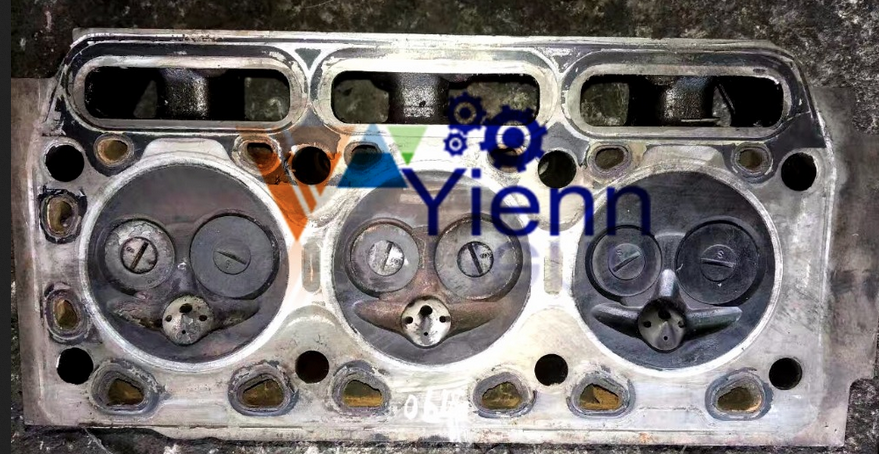

The volume contained within the head, for a diesel, is usually quit small. Removing significant amounts of thickness of the head changes many things: Reduces volume, raises compression, puts valves closes to piston, changes swirl within the space, and could place a sharp edge inside the circumference of the cylinder leading to hot spots.
Pic of a yanmar 3 cyl diesel. Notice how thin the head volume is at one edge of the cylinder for each cylinder.
