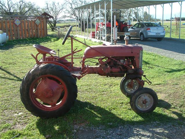

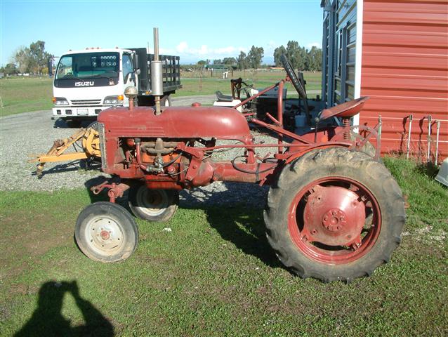

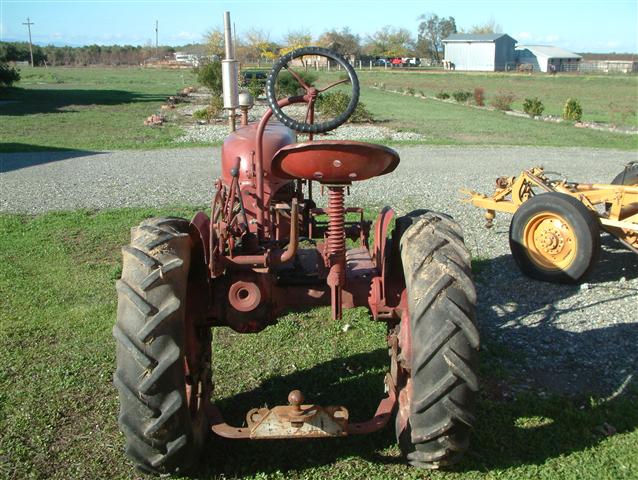

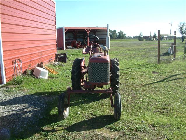

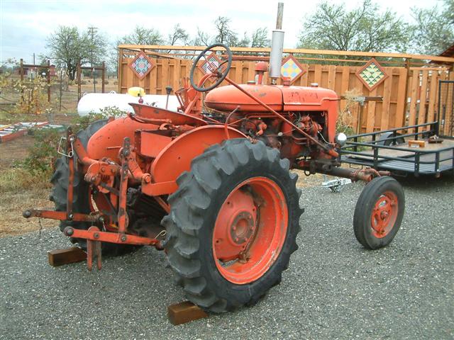

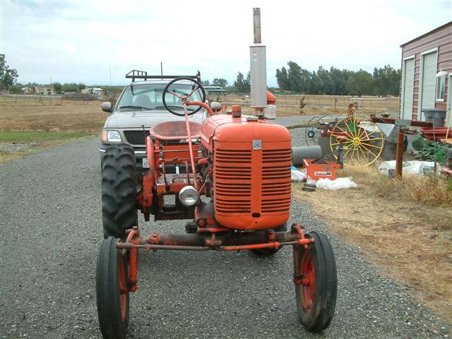

Farmall Cub, Farmall A, Farmall Super A. These tractors are designed for small acreage mowing and cultivating. Used mowers and cultivators are available on eBay and craigslist. And there are a lot of them still around and running.
My Cub cost $1100 (no implements, just a pto and simple hitch)
DSCF0082 (Small).JPGDSCF0083 (Small).JPGDSCF0084 (Small).JPGDSCF0085 (Small).JPG
my Super A cost $1300 including a 6-ft sicklebar mower and 3-point hitch.
Parts are readily available and these old tractors are easy to service and repair. You can get the manuals on CD and there are DVDs available to help you service and repair these old girls. Working on these simple tractors is a quick way to learn tractor repair.
