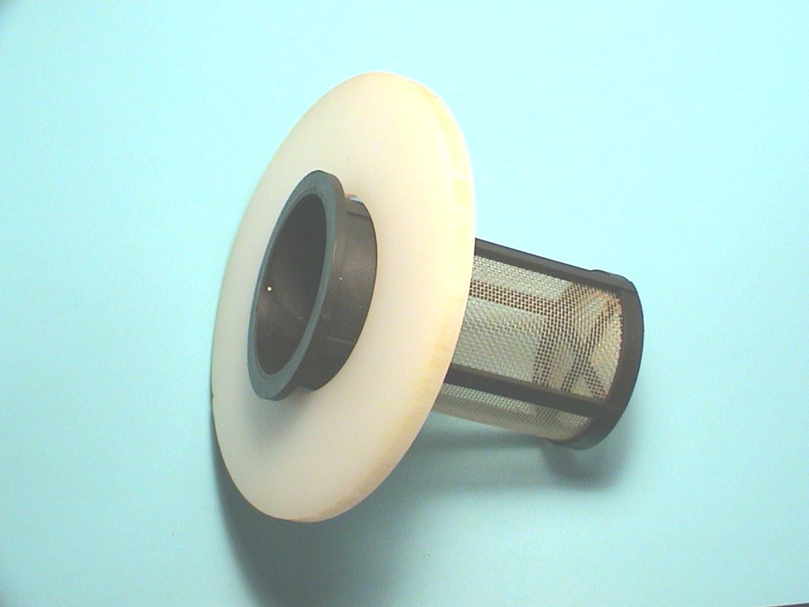

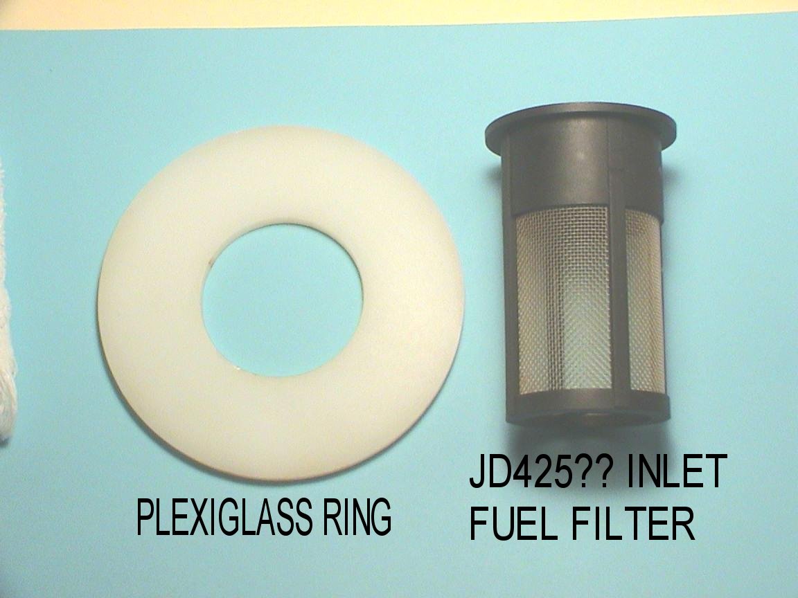

Bill--The fuel filter came from a JD 425 garden tractor or something similar. The plexiglass ring was cut from scrap with a hole just large enough for the filter to drop into. Mike S.

Bill--here is a photo of the two pieces assembled. Mike S.

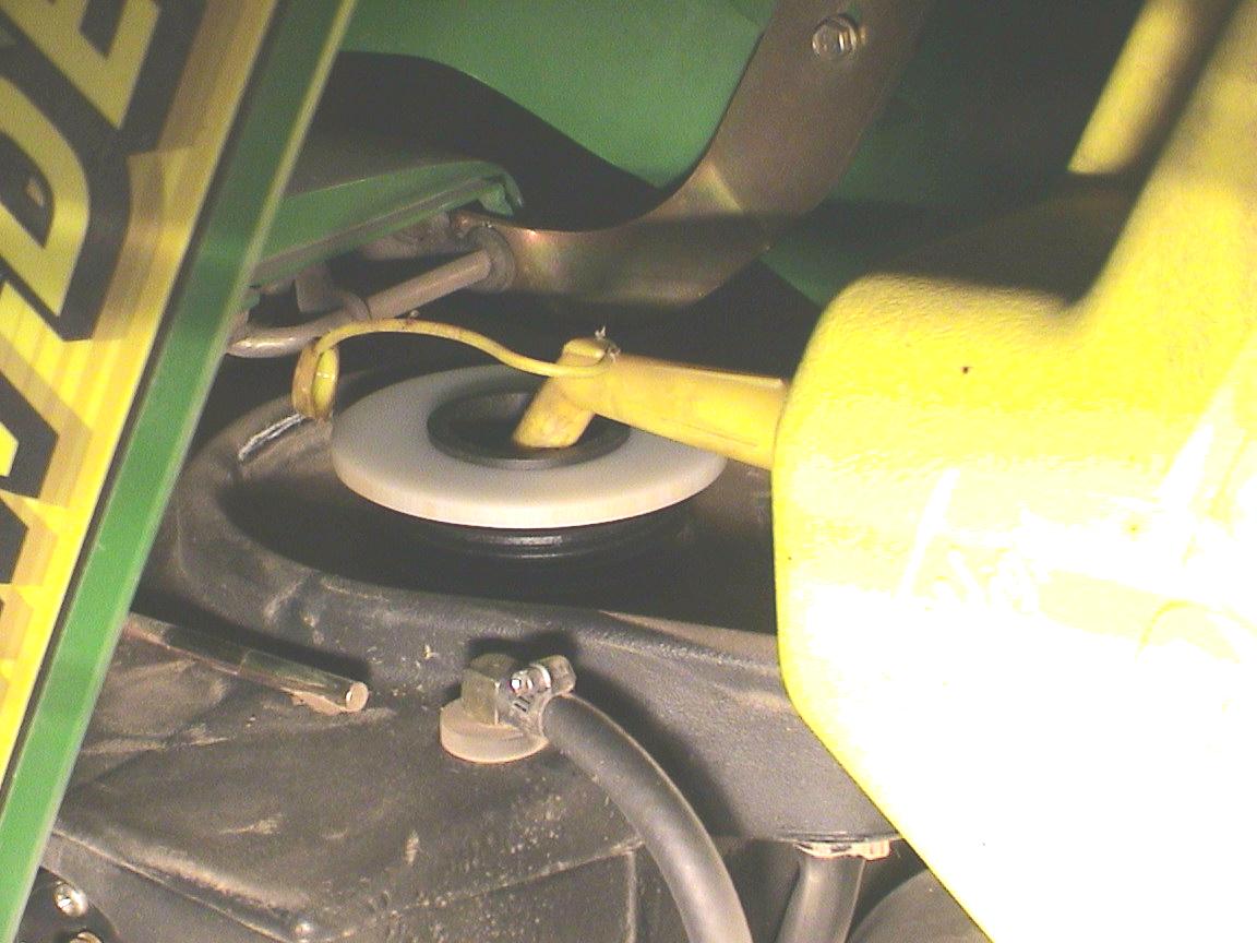

Bill--here is a photo showing the filter in use as diesel is poured through it into the 4400's fuel tank. Mike S.

VERY nice setup. Now, about marketing this product? Between you and Harv, you guys could develop an inexpensive, but effective system. Now, more questions: How did you cut the ring; where did you get the material? etc.
I didn't think this post would generate this much interest, but I've learned a great deal, including the need for filtering diesel fuel. Thanks.

   / Help with yellow diesel cans, please. #66
Bill--the Plexiglass was out of some scrap that I had laying around in my shop--there is no real reason that the outside has to be round since it is removed after each use. I used a bandsaw to cut the outside and a scroll saw to cut the inside. Other materials would work such as polycarbonate or lexan--I just want the tractor's fuel inlet covered so the wind and/or gravity does not introduce dust or leaves, etc. into the fuel aorund the filter. Come to think of it, large Honda gasoline engines have an even finer filter, but the one that I pictured takes out any visible impurities and the real fuel filter removes the real small stuff. I wish I could weld--plan on taking a course in wire welding at a nearby community college when my retirement is less busy. Mike S.

   / Help with yellow diesel cans, please. #68
My dad has a ag diesel tractor. He has 2 250 gl above ground fuel tanks (unleaded and diesel). Gravity feed into whatever you are filling. Shut off valve on the tank and a nozzle similar to a gas station on the hose. Leroy (check my profile) was having major running issues. Would be fine for a while, then just quit, like you pulled the shut-off handle. Did the usual, changed filter. No difference. Drained tank, no difference, took tank off, drained, cleaned, washed, dried, back on tractor, fresh fuel, no difference. Etc., Etc. Finally took all tubing off everywhere from the tank to the injection pump and found a small bug carcass, just the exoskeleton bone structure. Reached the conclusion that it was living in the nozzle and went into the tank once at fill up. He now has a piece of screen hose clamped to the nozzle.
Just something else to consider. Especially for the non-filterers.
