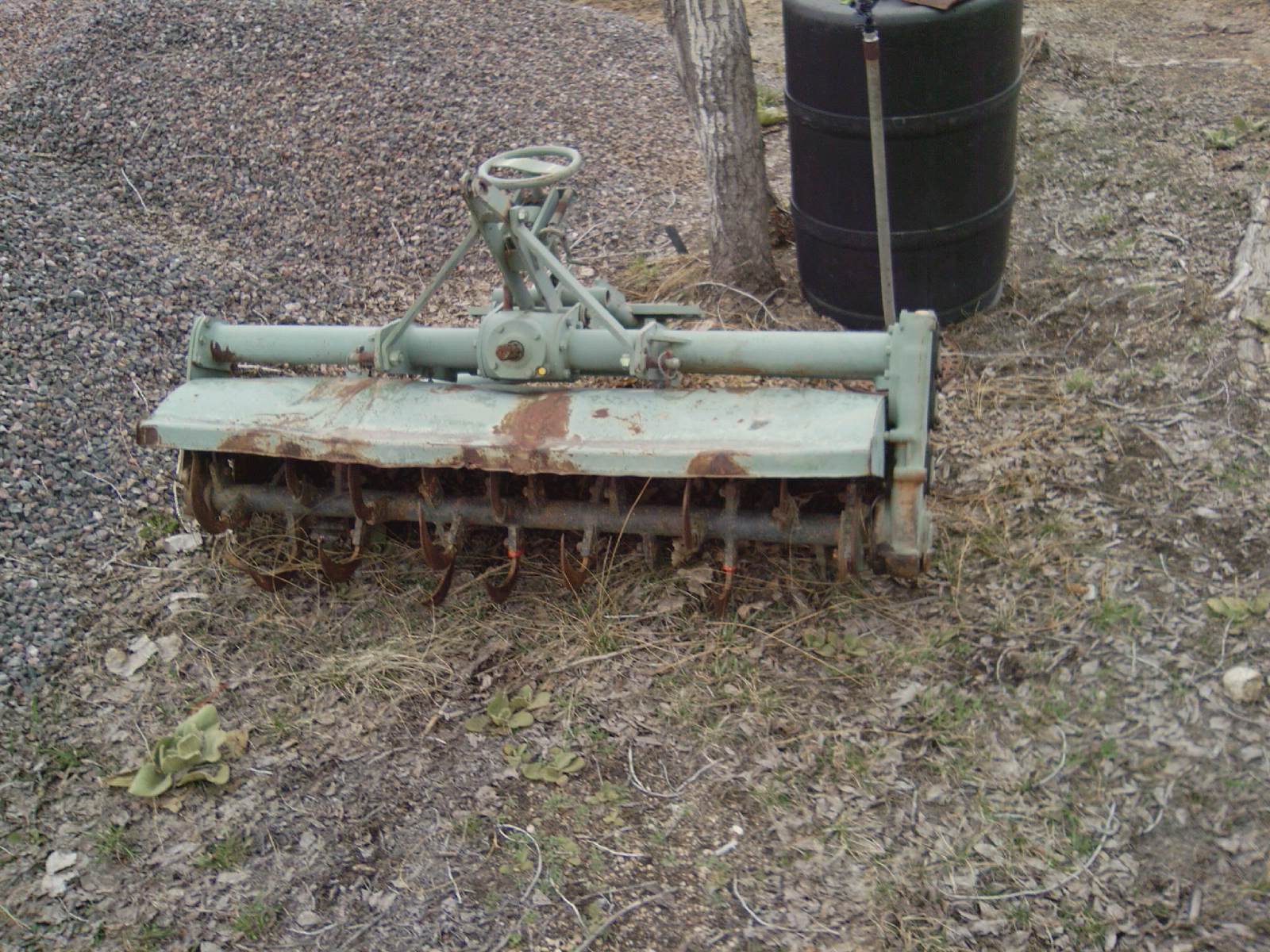

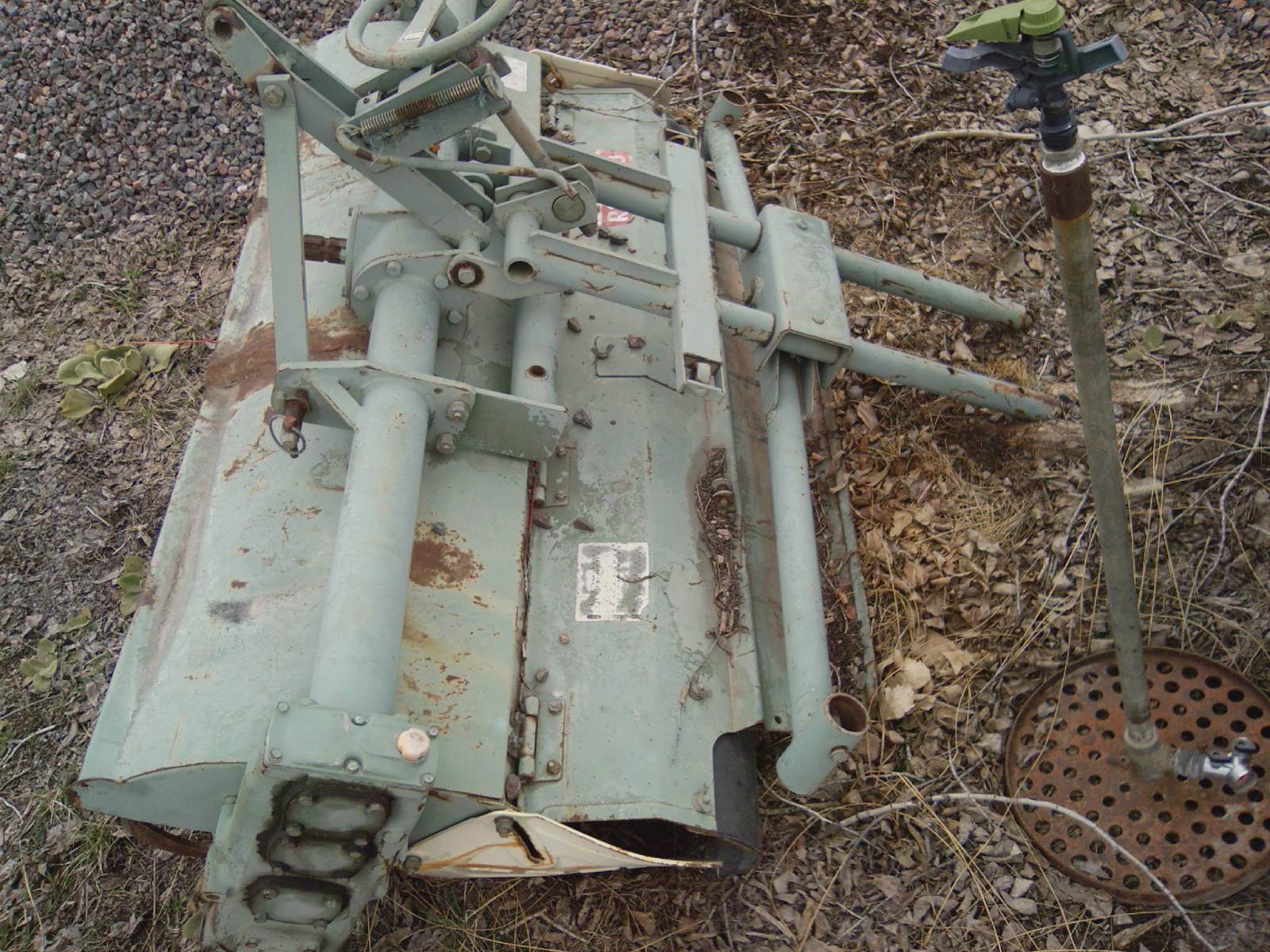

I need a little help in determining what is a good deal on a used tiller. It seems that used rototillers in good shape are very few and far between.
I finally found one near where I live and I'm trying to determine the make and model and whether or not it will be a good deal.
Andy feedback is appreciated...what do you feel would be a fair price...what to look for when buying a used implement like this etc.

It looks like a grey market tiller from Japan used originally in rice paddies. The tines are few and curved differently than a tiller used in regular field soils.
Around here, they go for 250 bucks to 400 bucks. That one looks well used. Remember that you will have a bear of a time getting parts should the need arise.

That tiller is beat to ****** (i'll save the system the effort to put in the ***'s)
I wouldn't touch that with a 10' pole
I wouldn't buy it with your money.
Plus, the tines are weird, it's not built for our clay soils

Thanks for the replies....you all have pretty much confirmed my suspicions....
I might just have to bite the bullet and buy a new one....I've been looking for a used one for about 6 months now and unfortunately this is actually the best one I've come across around here that wasn't asking for like new prices...

It's a Yanmar tiller used in the rice fields. If it's 48" wide, then it's an RS-1200 model.

Looks like an old Yanmar tiller. Pretty beat up as others have said. You didn't mention what the price was for it.

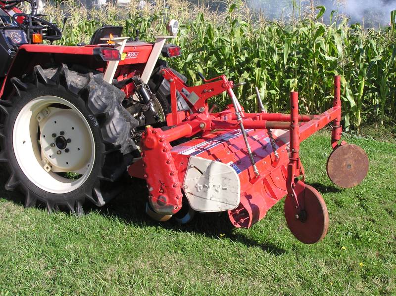

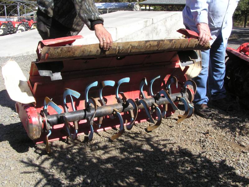

Here are a couple pics of my used Yanmar tiller. Paid $600
Works great in my soil. Tiller is extreamly quiet and does a great job.

Mickey....something like yours is exaclty what I am looking for and i would gladly oay $600 for it...in a hearbeat...but there is absolutely nothing around these parts that is in that type of condition....most of it looks like the one I posted above....
btw...asking price for the one above is $550....
/ Help with used tiller #11
$550!!!! anything more than free and I'd keep looking. It looks like someone with a bigger tiller was tilling up a field and ran across that old thing.
/ Help with used tiller #12
I agree with most everyone else on that little grey market tiller. I got tangled up with one of those, I cost me big dollars before I got what I wanted. I replaced the main shaft $125 just for the steel that I had to weld flanges to so I could get standard KK style tiller blades. Made whole new mounting system out of 1/2" steel plate $100 to fit the tractor. New PTO shaft and slip clutch $250. New bolts and new tiller blades $350. Many hours of labor. Buy a new KK or CCM. Wish I had. bjr
