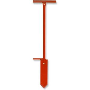

Are these trees one year old seedlings? If they are you can plant them by making a hole with a digging bar or mattock if your ground is soft enough. Jab the digging bar into the ground and pry a wedge shape opening in the ground. Stick the roots into the ground and push the tree in deeper then the it would need to be and then pull up the where the soil level is. The ends of the roots want to drag behind going down and going deeper and pulling back up straightens them out.
After you get the tree at the proper level take your digging bar and at an angle thrust it into the ground a couple of inches away from the tree and pry toward the tree to squeeze the soil around the tree closed. Keep the trees soaking in a bucket of water as you go around planting them. This link shows it better then I described it. http://www.uaex.edu/Other_Areas/publications/PDF/FSA-5007.pdf

Rick is that called a dibble bar? I have used those on pines that were a year old.
Yes dibble bars are made for tree planting but I was guessing most of us did not have one and did have a digging bar which works as well or it did for me.
