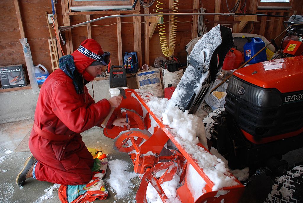

Whatever1,
I have the same problem, or I did, with my BX 1800, but it wasn't the issue of the sheared pin coming out hard, as much as getting the drive shaft and the auger shaft to line up. With advice from TBN'ers I found that the wings on my BX 2750 had flexed out, which provided for play in the drive shaft (The bearing flanges pulled the bearings sideways and the allen set screws couldn't hold against it,) so finding the sheared bolt in the grease was the first issue, then lining the two holes up side to side was the next. Even when I was confident that I had the holes lined up, it didn't take much to be off kilter and that pin was not going to come out. Once they lined up, the pin was punch out quite easily. Are you certain the holes are lining up? By the time I generally notice that I'm pushing snow with one side and not throwing it, the sheared pin has been smoothed down by the drive shaft rotation that I have not had the problems of the sheared pin leaving burrs to give me problems.....once I get the correct line up on the holes, out it comes.
Just a thought. Dyer, retired
P.S. Does the attached picture look familiar? This was one of those 20 minutes shear pin replacement jobs, as it was 2degrees, the wind was at about 20 mph, and I was too stuborn to shut the garage door because I hadn't backed the tractor far enough in....you get the idea.
