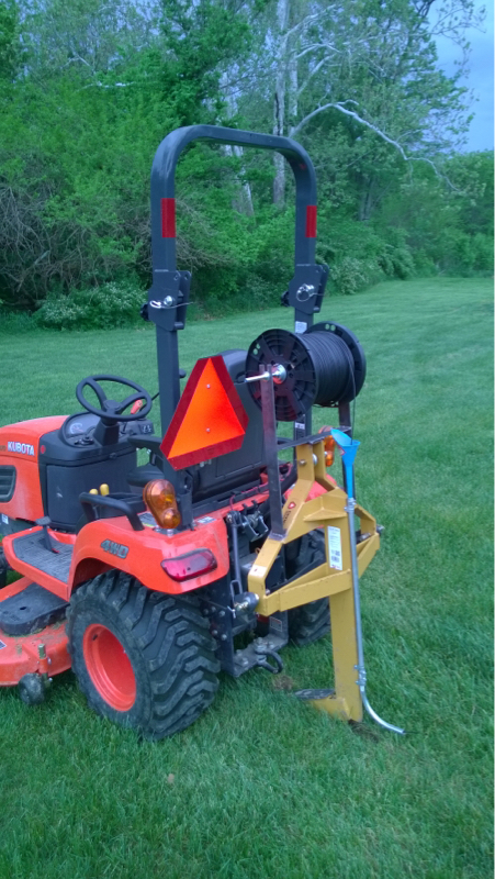

Did anyone ever end up using a subsoiler on the back of a BX? I'm interested in buying one.
   / Help with selecting a trencher for my BX #39
I used a subsoiler on my BX to install an underground fence for my dog. It worked like a charm. I fabricated a wire spool mount and wire guide. Here it is: image-2611642510.jpg
