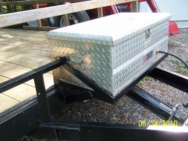

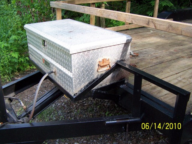

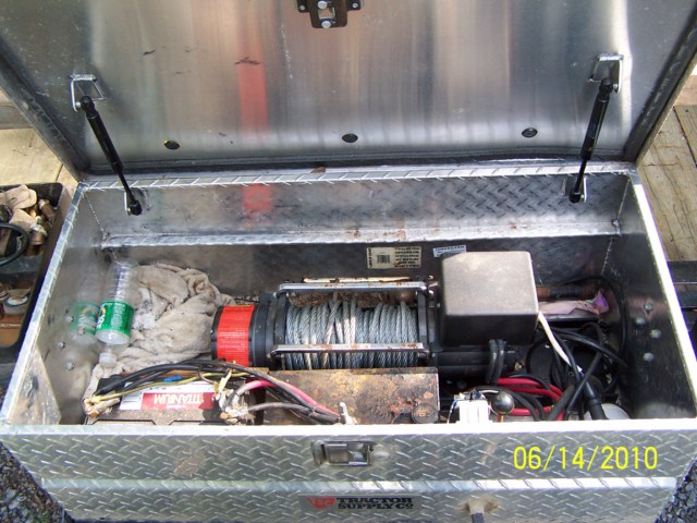

I bought a similar box from Tractor Supply for my tilt trailer. I welded up a 1/4" angle frame to support the box. My box goes up with the trailer when it tilts and contains my hydraulic pump, winch, and battery. Mine opens from the front and has been on there for almost 4 years now and has never opened up while traveling.
You can easily mount your box to the tongue of your trailer by welding or bolting two pieces of angle across the tongue to bolt the box to. You'll probably have to relocate the spare tire. I made a bracket for mine and put it on the side of the trailer.
