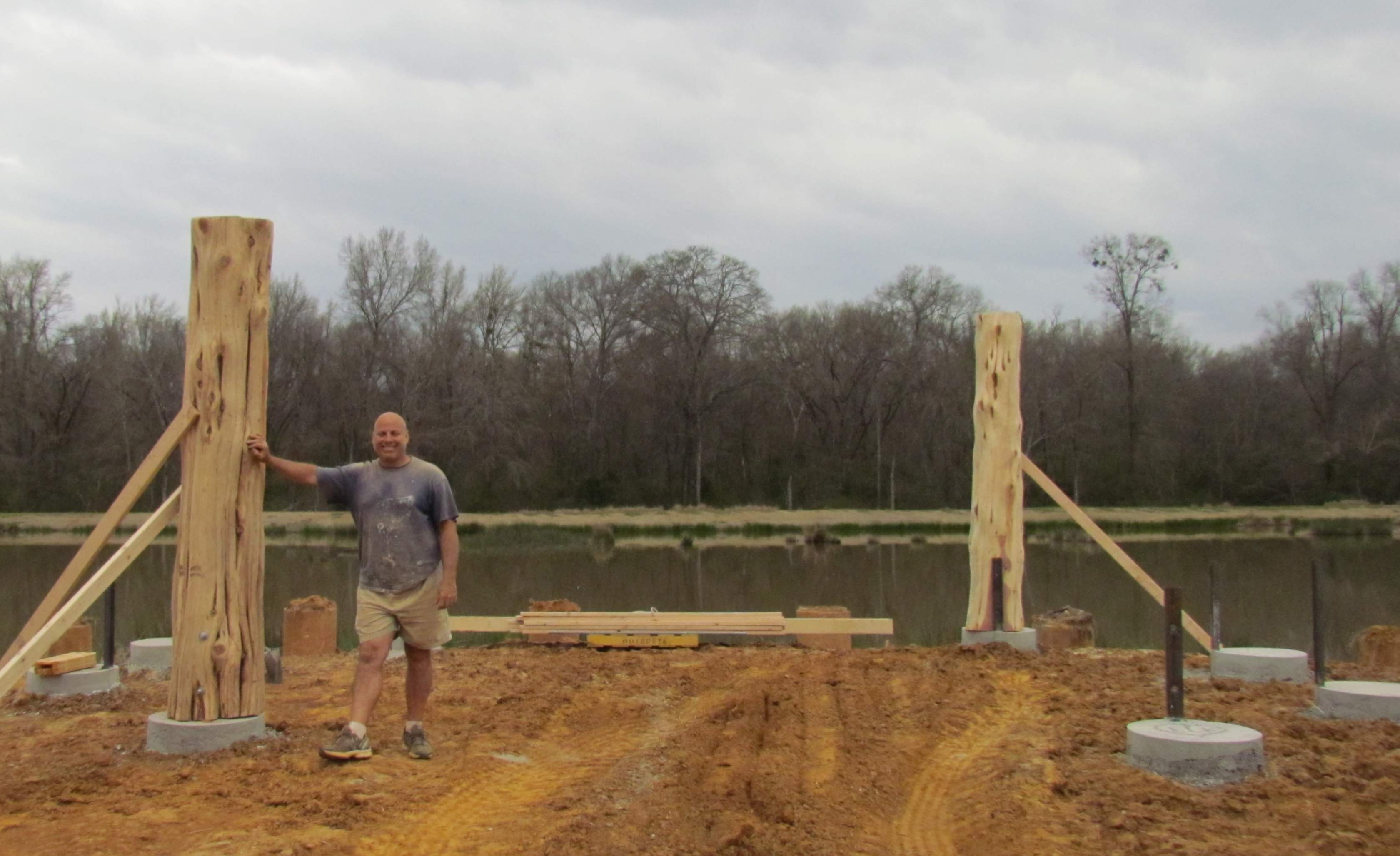

I'm building a gazebo in a remote area of my land that it's not practical at this time to run power to. I would like for it to be lit up at night time and think that going solar might be the way to go. My thought is that if I put a solar panel on the roof, I could charge a 12volt battery during the day, then when it gets dark out, a photo cell would turn on the lights. They would stay on until the battery, or batteries ran out of power. Then the next day, the solar cell would recharge the battery and it would be ready to go another night.
From what I'm seeing online, outdoor low voltage lighting with LED's is 12 volts. So wouldn't this be just like wiring up a car?
Am I right, wrong or what am I missing?

If you wanted to build your own I would think deep cycle batteries would be better than a starting type battery as is used in a car, truck, or tractor. Using LED lights it should be possible to get enough run time to last over 12 hours without depleting the battery below 50%, that's just a guess as depending on the type and chemistry of the battery there is a recommended maximum discharge level.

As an example let's say you wanted to run some of those 50-watt equivalent Malibu lights. From the pic it looks like you have 6 posts and you want to light each post. They use 11 watts each for a total of 66 watts.
Amps = Watts/Volts so Amps = 66/12 or 5.5 amps.
So each hour the lights are on you are using 5.5 ampere-hours. A good Group27 deep cycle has about 100 ampere-hours but you don't want to go below 50% charge so 50/5.5 means you can run those lights about 9 hours. That is assuming your battery is at 100% charge at the end of each day.
Which brings up charging your batteries. You would need to figure out your average hours of sunlight, how much your panel location will get and then set up the correct amount of solar panels and a charge controller to be able to bring your batteries back to 100% charge each day. The deeper you discharge the batteries and the more often you cycle them (daily it sounds like) the more you will need to check them to add water etc. Summer heat will cause water loss as well so you may have to check them pretty often in the summer until you get a feel for how often they need to be serviced.
