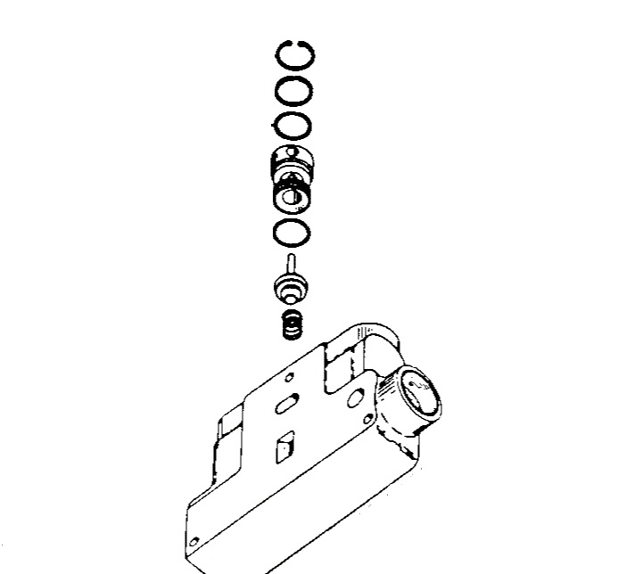

In case anyone ever needs to know I got in the seal parts for the check poppet for the original IH loader valve from the dealership. I mainly ordered them so I knew they were the exact parts because I tried ordinary o rings and it still leaked badly and as I said before they were missing from a previous owner so I had little idea what they actually looked like.
The first seal toward the bottom appears to be a common o-ring but thinner than usual , probably buna -n or viton.
The second seal is like a common o-ring but thinner than usual. I assumed it should be thicker but maybe thats why the normal o-rings got mangled everytime they were installed.
The ring between that o-ring and the reataining ring
is flat and is diagonally split and is like some kind of hard fiber or plastic, like kynar or something.
The retaining ring is just a wire ring about like paper clip metal. It is initially larger than the plug and the hole so I assume it is installed like a piston ring and then snaps out when it reaches the groove down in the hole. Problem is, I don't know how you could ever get it out because I don't see any access to that ring once it's in. I must be overlooking something.
update: below, after I got done, I had found that the retainer ring actually goes on top of the whole thing.

I put the new OE seals in the original loader valve and NO LEAKS!
I had to think for about a half hour and inspect closer because I had been sure that the retainer ring was supposed to go in the hole on top of the split flat ring but I was wrong. The reason I was wrong was because there is a groove at the top of the hole that was filled with part of the old ring that had been shaved off and it did not look like a groove there, just a flat surface. Anyway, the ring holds the whole thing in place just like a lot of things that use a retainer ring or circlip. Of course the long top bolt thru the whole assembly would keep them from blowing out if the ring failed.
As for it sealing, I guess the main problem was that the o-rings I was trying and the guy before were too fat and they would bind and mangle. With the new OE ones it went in so easy I didn't think it was going to seal.
Below is a couple more pics with the new seals.
I tried the loader some but it got too dark to take out and check float etc. this evening. It never once dropped before raising when re engaging up after setting in one place for a bit. It had about 200# of dirt in the bucket. Everything seemed to work OK so far except that it drops real fast when pushed for down.
