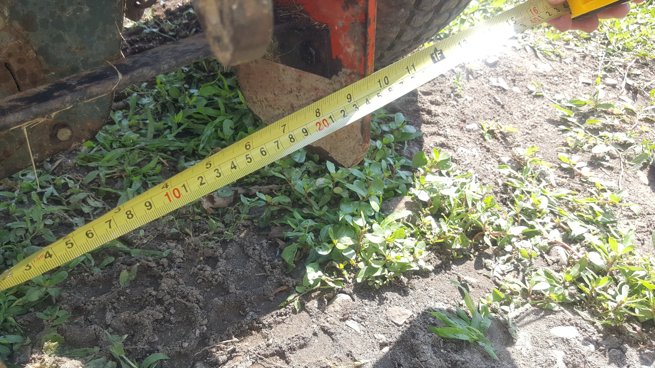

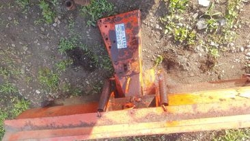

I have no idea how to attach this (I think it's a snow Blade) to this setup, I'm not familiar with Hydraulics or mounting anything on the front of the tractor, I only had a # point rear blade on my last Kubota. I know it's not a Hydraulic blade, but there is a Hydraulic cylinder, I guess for lifting the blade?
Does anyone have any idea what is going on with this setup? I'm the 3rd owner, the guy I got it from never had the blade attached, he just used it to cut grass on his farm.

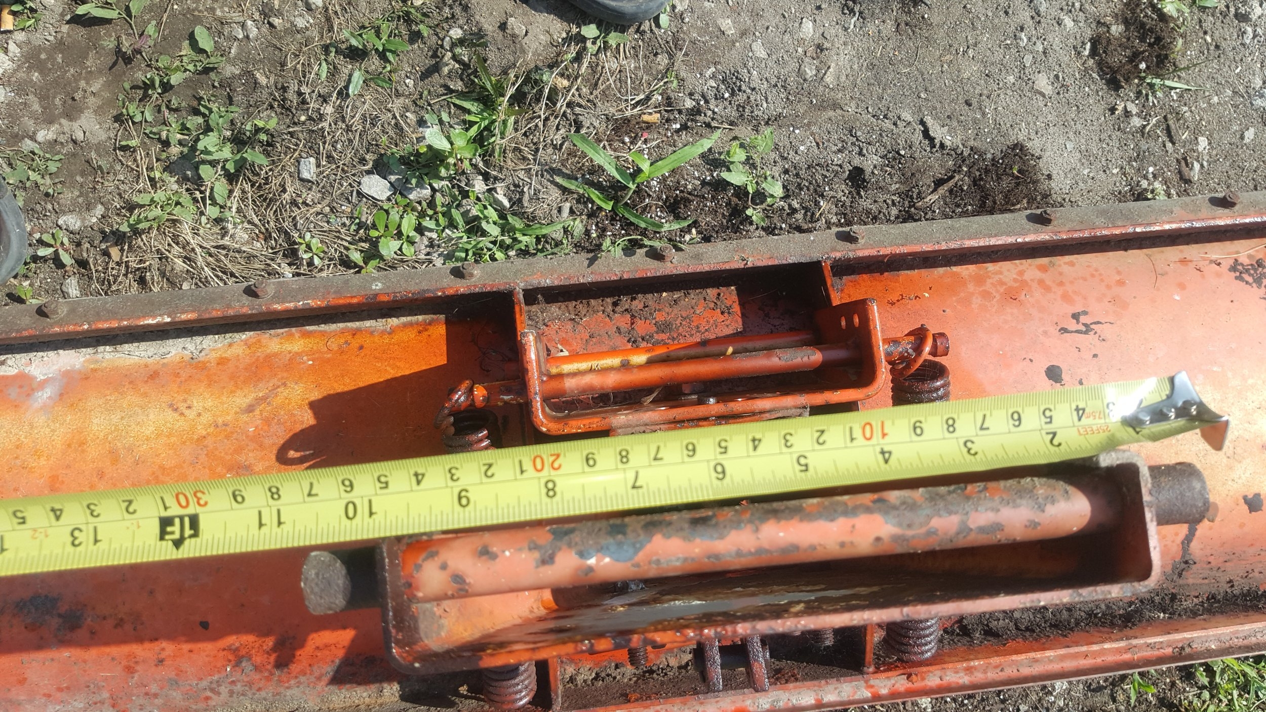

Are the 2 pins spring loaded but rusted up? A good picture of one of those pins would help. I would assume that you would not have to remove the bracket to mount it. Flip the plow up on it's face so you can get a good look at those pins.

Not spring loaded, the pin length is 11 inches, and the opening of the bracket on the tractor is 9 1/2 inches.

I don't think it's a Kubota blade, I turned it over, and it looks like it was White before; and painted Orange.
OK
That is NOT the B2763A
It looks more like the blade mount for a BOLENS yard tractor, The HT series in particular.
