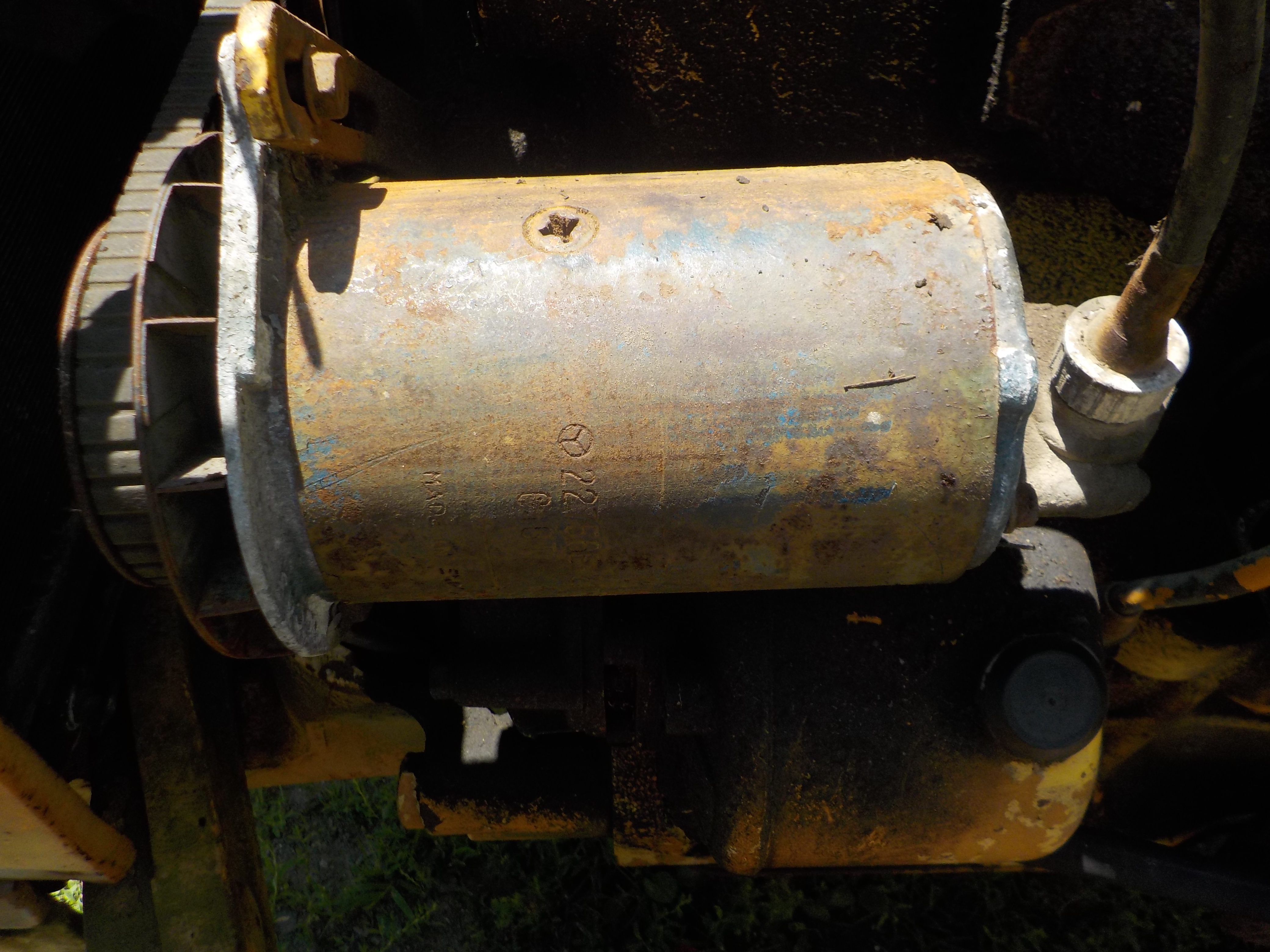

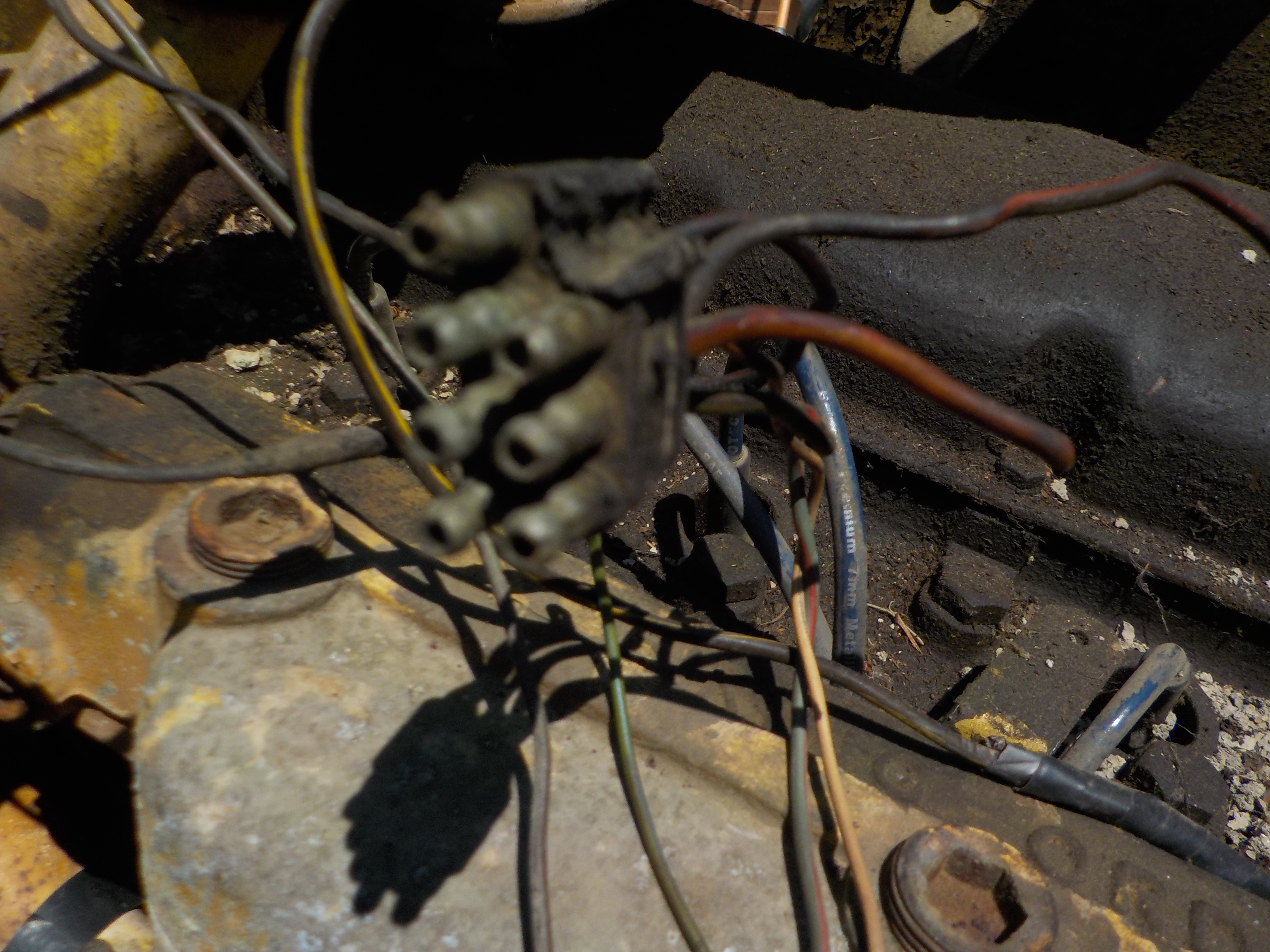

1972 FORD 4011 LCG Tractor : I am looking to install a New IGNITION switch and Repair / Replace the whole wiring Harness which has been abandoned and taped up by the previous owner for reasons unknown, lot of Taping Up of wires.... I have looked on Steiners for a Replacement Harness and can't seem to locate the right one,*** I am NEW to FORDS***

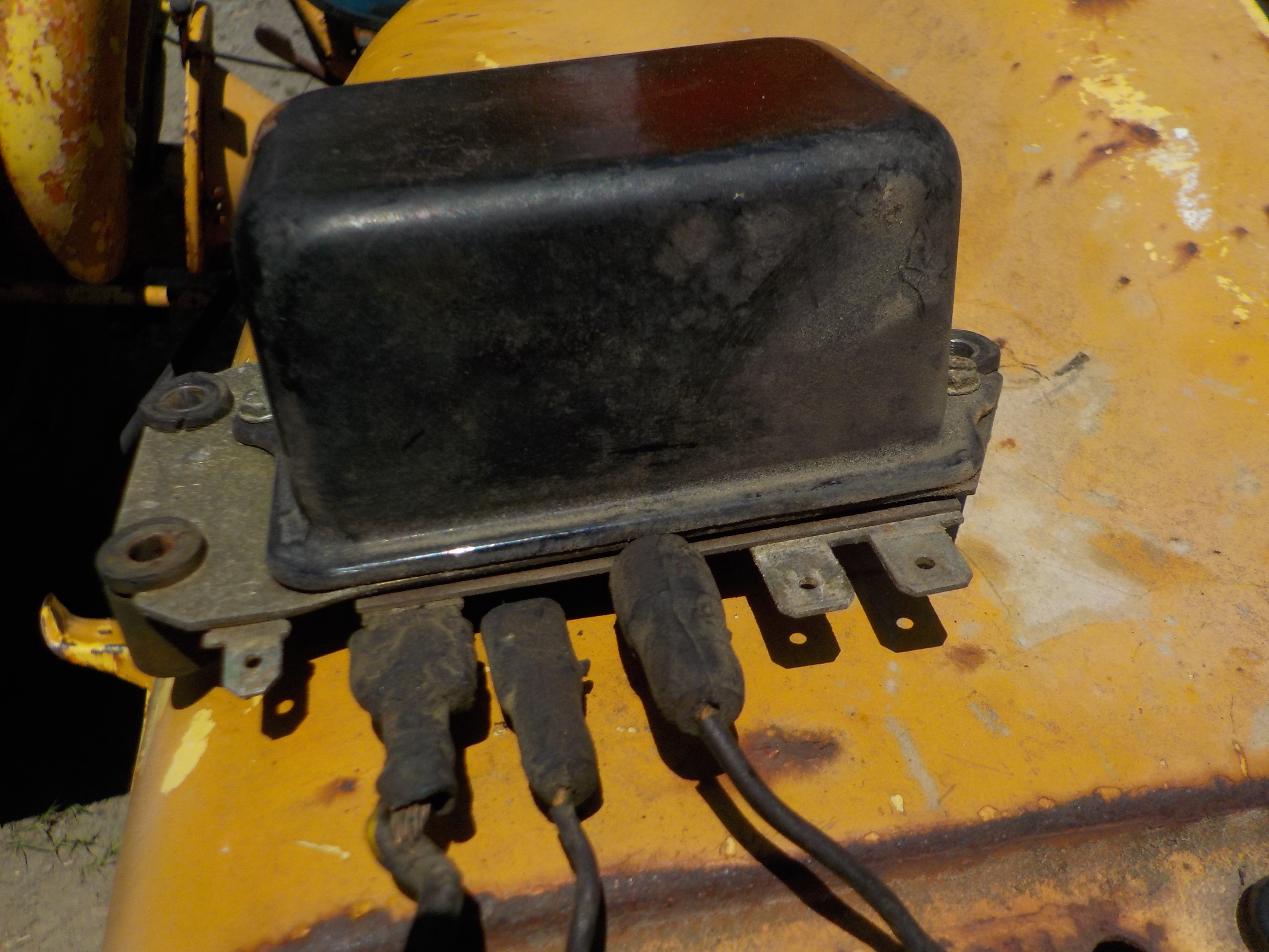

I have made my own wire harnesses before for many IH Farmalls , fairly simple to do but this one is a little different , different Genny & Regulator as well as Key Switch, which I'm NOT familiar with, and so I just want to be sure I'm not gonna FRY something. PLease see the Pics and Video Link Below for a up close look at what I'm dealing with.

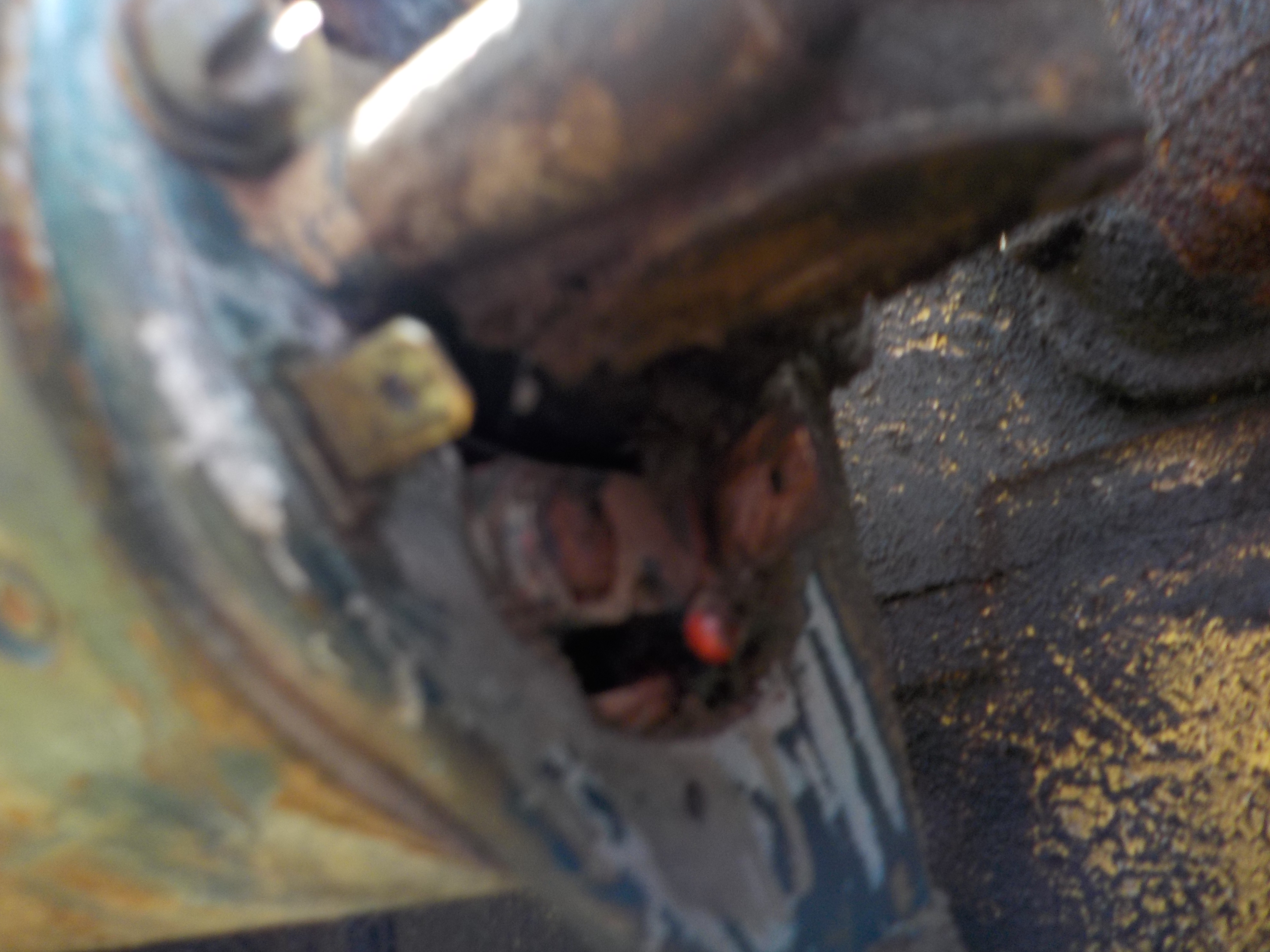

The Generator has only 2 Prongs, 2nd Pic Hard to See But Trust Me Just 2, and BOTH are Unmarked, The Wire Harness ciming from the Genny has a 7 PIN Plug in Connector?? As Does my New Ignition Switch Coinsodence?? And the Regulator is a 6 Pin I have looked at Many Scematics on Line and Can NOT locate ANY with this 7 PIN PLUG or this exact Genny Anywhere at all ... Most Genny Scematics I found were for 6 Volt Positive Ground, Most 12 Volt I found were for Alternator systems, Could this 7 pin harness be wrong? could it of been added by someone?? I just don't know but I am at a loss here.
Anyway, Any and all Help would be GREATLY appreciated. I want to get everything working again but DON'T really care about the IDIOT lights, as I plan on installing Gauges and don't need the fuel gauge either.
Hopefully the attached Photos and Video will Help Solve this Mess.
Thanks Guys, DanO'

Not going to be able to help much but the 7 pin plug accepts all the wires from the motor compartment. The other end (Female) accepts the wires from the instrument panel (Cluster). If you need to seperate the tractor, that makes it easy to just unplug the front from the back part. It's usually connected under the shroud covering the fuel tank.
The ford wiring, except the voltage reg, is the cluster is fed hot and one wire from the oil sender, one wire from the temp gauge and one wire from the fuel sender (All - grounds) go to one side of their corresponding guage or light on the cluster.
This is about as far as I can help because I've never heard of a 4011 Ford. Try and find out exactly what model you have and maybe I can help find you a diagram. More than likely you can go online and find any 3 cyl ford diagram and use that.
/ HELP with FORD 4011 Wirering Please
Thank You Very Much for Responding Steave and for your Wise Advice. The 7 Pin Plug making for ease of electrical disconnect splitting the tractor for repairs makes all the sence in the world. I never thought of that. Anyway, As you can see in the attached Video I found the needed scematics and so decided to just do my own wire harness. The 4011 LCG Tractor, I'm finding out, is an Industrial Commercial model and so I discovered that some things were just slightly different in many aspects to the Regular 4000
