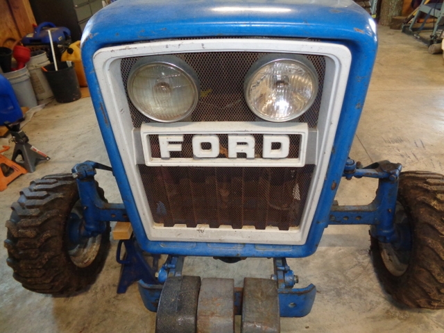

Hi All!
Noticed I had a headlight out. I rebuilt my grill over a decade ago, and I remembered the bezel was held on by an odd spring clip.
I managed to pop the bezel off, but can’t figure out how to get it all back together again.
Anyone have access to instructions?

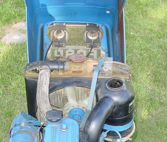

Howdy,
I have done one bulb change many years ago. I went to my archive and found a reference pic.There was a retaining plate for for screw that kept the light in place. I remember some spring loaded clips as well. It was a very quick and painless work. Look at the pic below. Take a pic of yours as it might be different. I also have a PDF from the owners manual for your benefit.
