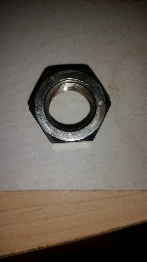

All attempts to find the kit locally have failed or even find it for a decent price. Any help would be greatly appreciated. I went to my local fastener (not fastenal) store and they sold me a nut that fit the bolt, but the markings on the nut a "i" lead me to believe it is Grade 1. It is also not a Locknut either.

Your nut is likely a grade 5, or "standard", bit of hardware.

Here is the nut that was sold to me by my Local Bolt/Nut shop.

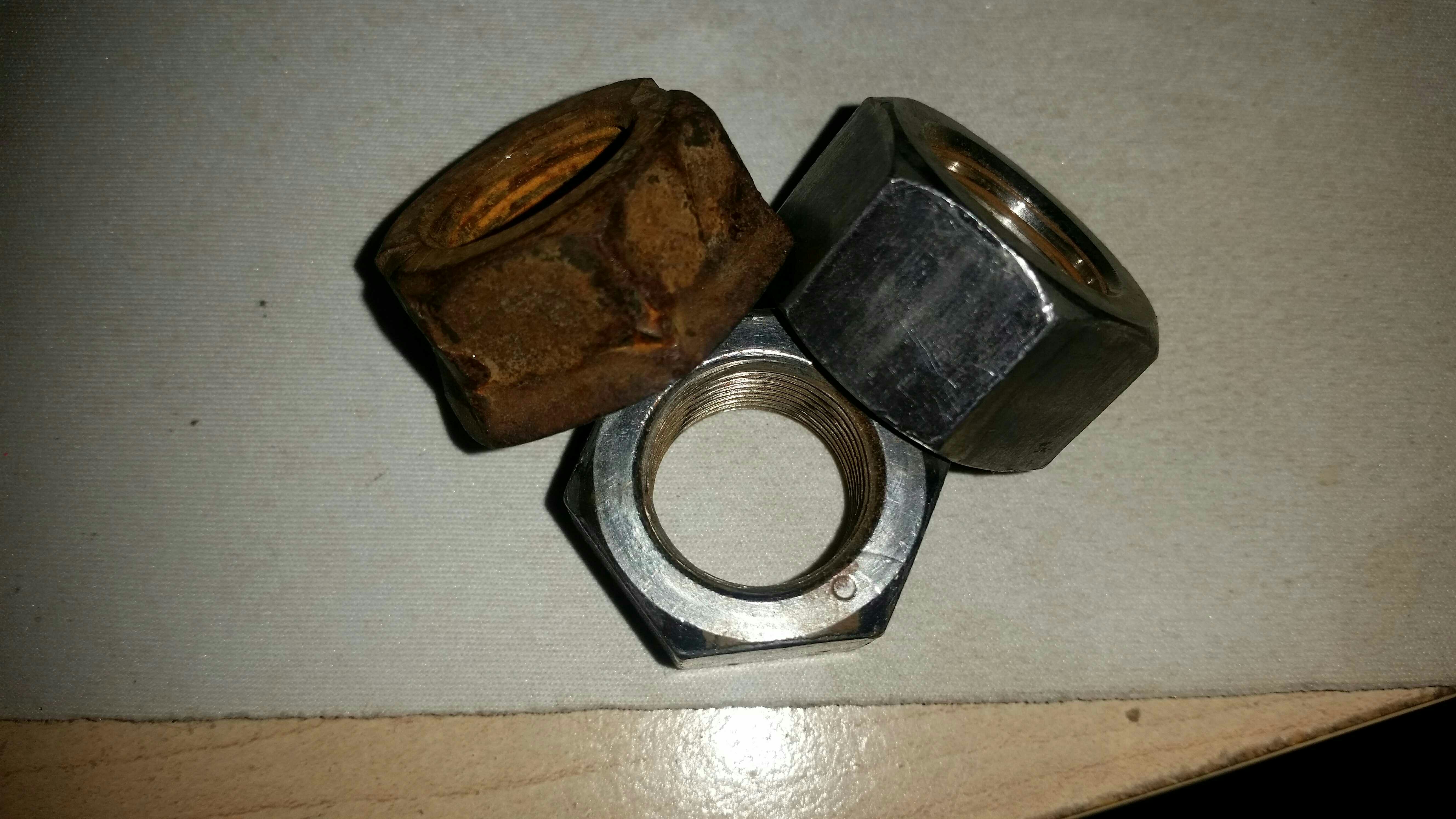

Here you can see the Rusty Nut that has the mushroomed end. It appears to be a locking nut with two triangle looking indention's on opposite sides. The new nuts screw all the way on very easily and without a lock washer they may vibrate loose over time. Even with Locktite on this particular application I would be worried.
With properly applied Loctite I wouldn't worry. Heck, use red Loctite if you are worried—but you may need to heat it to remove it!
