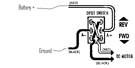

I have set up a 12 volt winch to run the rotation on the chute of my snow blower.
It works fine in the shop but I need to figure out how to power it on the tractor.
I can bring 8 or 10 gauge wire directly from the battery to inside the cab but I am looking for a simple and inexpensive plug-in connection (male and female) so I can plug in and unplug the winch controls easily when I put on and remove the snow blower.
I've been searching the web without success. I am guessing someone on this site has done something like this and might point me in the right direction.
I have gone to a couple of auto parts stores locally where they start talking about in-line fuses, heavy duty specialty connectors etc and they are scaring $80 to $100 by the time they are finished. I think it should be simpler and easier and cheaper.
Any advice appreciated.
Bob

Yes, Catdriver. You need devices rated to carry large currents, 200-400 amps.

Sorry Bob...I misunderstood your question. Search for "Anderson Connectors"

As others have pointed out, Anderson Connectors are what you probably want. Find out what amperage your winch draws on say a 500 lb load (or whatever load you are comfortable with) and size the electrical cable and connectors for that load. Rotating a chute should take next to nothing for load if everything is right with the world, eh? :)

The small size Anderson Connectors will work fine. I use them on small winches all the time. The actual contacts should be coated with die-electric grease to prevent corrosion though. For your use, you will only be applying current for a few seconds to swing the chute, but when the chute gets iced up there will be a good load. Go with at #8 superflexible wire (or double up #10's). Future shop should have #10 speaker wire (thats what I've been using on ATV winches).
Just run the winch controller (I'm assuming that you are using a winch relay) into the cab when you need it.
Make sure that you solder the Anderson lugs and don't just try to crimp them.
If you are using the pushbutton controller that comes with some of the small winches you can just extend the wires as needed but I've had about 5 give up the ghost when friends have used them on ATV's. You might get lucky because of the short duration of your loads.
If you are going to fuse the feed, use a 100amp fuse. Normally we don't fuse a winch but are really careful when we route the wire to prevent fraying. (PM me for details)
