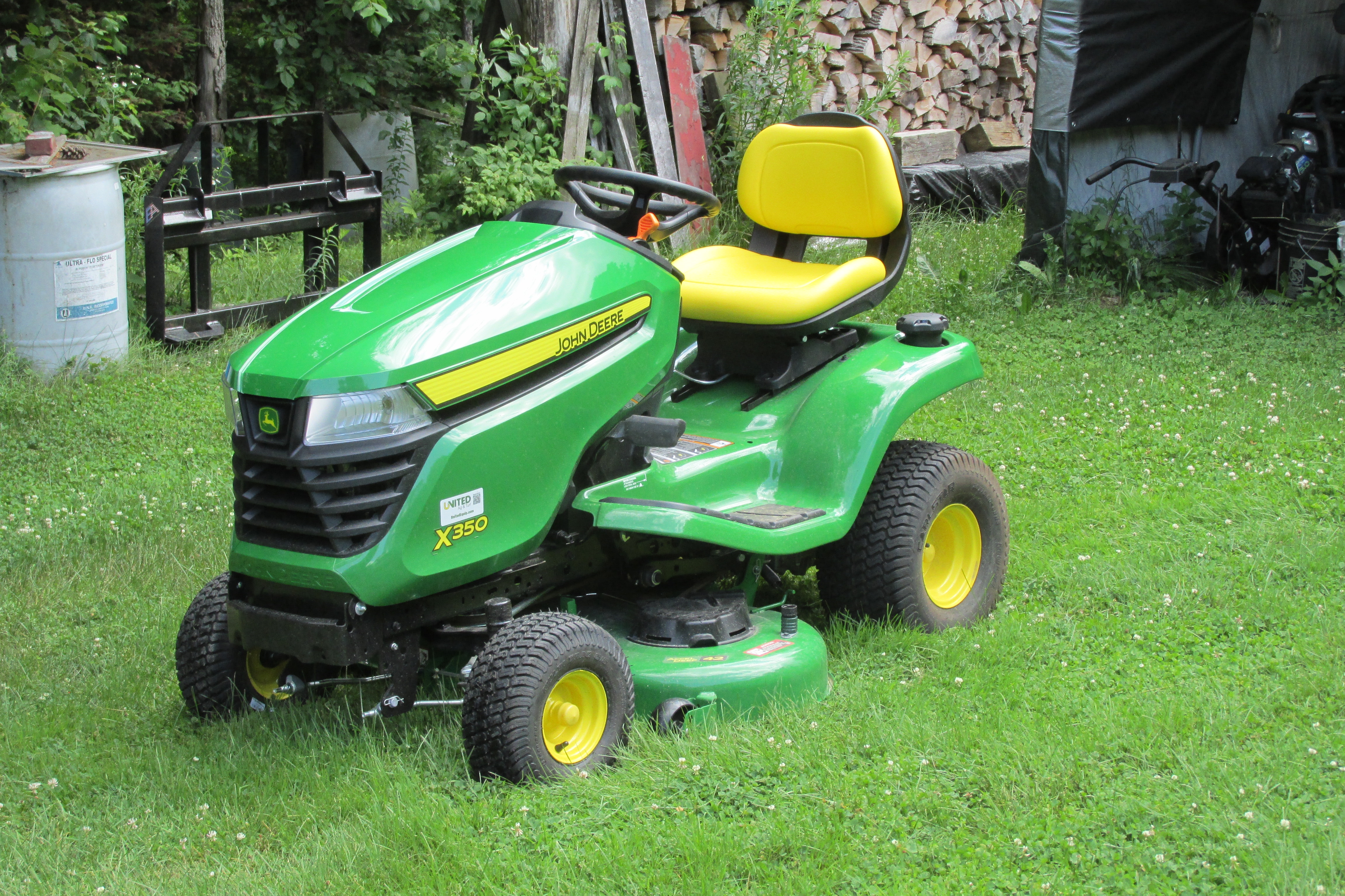

Update, I took the plunge and got the JD X350. I'll probably get flamed for not going with the heaviest duty machine I could find, but this seems to be a good compromise for my needs. Didn't need something of a level a lawncare pro would use, but wanted something better than a box store model, this seems to fit the bill.

Actually both dealers I visited told me the X350 was by far their biggest seller.
Trouble is with the models you guys mentioned is that the smallest deck size available is 48", I specifically said in my original post I was looking for a 42. As it is, the X350 is a tight squeeze in a couple spots (old one had a 40" deck), no way no how gonna get anything wider in those places.
As I noted upthread, transmission failure is not something I've experienced with previous machines, including a couple of box store ones. While I definitely appreciate the info, I didn't see the cost vs benefit working in my favor (even if the heavier duty ones were available with 42" decks, which they weren't).

All in all, I'm pleased with the X350 so far. It's quiet enough so I don't need hearing protection when I use it (a first), gas consumption with the Kawasaki twin seems about the same as the B&S in the old Ariens (despite the new one being almost twice the HP). I love the way it handles...steering is very easy and smooth and it has a surprisingly tight turning circle...much tighter than the old one.
I don't especially like the separate choke lever, it's kind of awkward when starting it, and I've really got to find a way to defeat the reverse-mow lockout (there is a button you can push to over-ride it, but you need to mash it down or else it might not engage). I'd imagine it should be something as simple as bypassing the switch, just holding off for now so as to not potentially void the warranty. The seat switch got disconnected after about 15 minutes. :ROFLMAO:

Congratulations! I like the idea of keeping the old machine as a backup, have a couple of "backups" myself.
Need pics of your new mower.
Yeah, the old one's in too good shape to junk, just too many issues with it to work on right now. We'll see what Mrs. Oak has to say about keeping a spare...she thinks I have too much stuff as it is. :ROFLMAO: 🙃
(y)
I really like that they put the big fuel filler out on the fender like that. The fillers under the seat are harder to get to and accumulate lots of grass and dirt.
I'm sure you'll jumper the backup button with a paper clip in short order (that's what I did with mine).
