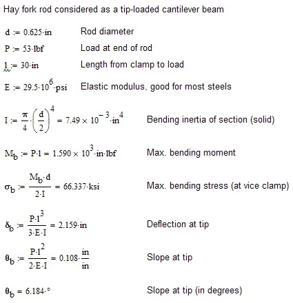

I'm designing a hay fork for my B2150. It will lift 4 bales at a time. The bales are stacked 2 wide x 2 high to make a 200 pound cube about 36 on a side. I envision 4-8 round spikes, like a tine bucket
A quick test of a possible spike using a 50# bag of feed in a 5 gallon bucket says that 5/8" diameter rod clamped in a pipe vice will hold 53# at a distance of 30" from the support, and spring back when the weight is removed.
With that as a starting point, I got out the books to 'experiment' with different rod diameters and lengths. When I calculated the stress in the 5/8" test, I got 66ksi. Interesting for mild steel that should only be able to withstand 30-36ksi. I went back to the shop and tried again with other rods and was able to get calculated stresses as high as 100ksi without bending the rods.
The equations I'm using are:
Stress in a cantilever beam = (My)/I. M is bending moment, y is distance from neutral axis...the radius of the rod in this case, and I is (Pi/4)r^4 where r is the radius of the rod. Pi is that magic 3.14 but I'll have to write it as Pi since I don't know how to make the symbol.
When I do the calculations with 5/8" dia, 53#, and 30" I get M = 1590 in#, I = .0075 in^4, y=.3125 in. This gives a stress of 66ksi.
It's been way too long since school and engineering lab. Can someone tell me what I'm missing?

Here's what we got:
5/8" Diameter Rod - S (section modulus) = .0239685 in3
Momemt = 1.590 in-kips
fb= M/S
fb= 66.33 ksi
To still be in the elastic range on the stress/strain curve, your steel would have a tensile strength of 100ksi. Possible, depending on the grade of steel, especially in rounds. Round bars come in tensile stregths well over 150ksi.

Like a starved Chihuahua on a pork chop, I can't stay away from this one, mainly because it gives me an excuse to use Mathcad! :eek: (hopeless geek engineer). I checked the math as well (it's spot on), and went on to calculate the deflection and slope at the end, which should be nearly 2-3/16" and 6.2ー (or .108 in/in) at the bucket handle. That's pretty noticeable, did you see anything like that? It seems to me that if you had the rod clamped horizontally in a vice, the bucket would want to slide off the end.
I'm not doubting your word - your tech skills are obviously strong enough. Actually, your attitude seems like mine - you want the numbers to reflect reality.
So like Michigan Iron says, you must have some mighty good stuff there, maybe heat treated 4140 or something. Unless, like Huskerboy says, it took a set and you just couldn't tell (easily).

Good point and true, henerythe8th, but what is bothering me (and Craig, at least) is the fact that the deflections aren't anywhere near where they should be, and that is based on an entirely linear calculation (no "yield" or permanent bending).
With Craig holding his bar in a vice, it's hard to believe he'd measure less deflection than a built-in cantilever calculation, which of course assumes an infinitely stiff "wall" that the beam is attached to. That's difficult to duplicate in real life.
So, yeah, you can heat-treat plain ol' steel up to some pretty good yields, but for steel the elastic modulus is well established, so the deflections shouldn't be that far off, much less in the "too low" direction.

Your ruler says L = 20". You had it at 30" in post #1. Looking at your c-clamp, the effective length is more like 21"
Using a modulus of 30,000,000psi which is independant of temper, I get a deflection of 0.73 - not too shabby.
I used D = 0.625. There is probably some mill scale on the rod.

I can hardly see to type because of the bright red glow from my face. Guess I win bonehead of the week. Post #1 ended with 'can someone tell me what I'm missing? You did. I have 30 stuck in by brain as the first guess for length of the spikes on the fork.
I agree that the clamping setup probably increases the effective length of the experiment. Using the proper length in the calculations at least gets the experiment and the theory in the same ballpark. If we assume that the effective length is 21" as confirmed by your deflection calculation, that gives a stress of a bit over 46ksi. I still have a little trouble with that one, but given what I learned from your link to McMaster, and what Henrythe8th said about steel making and meeting minimum yield specs, it's possible.
