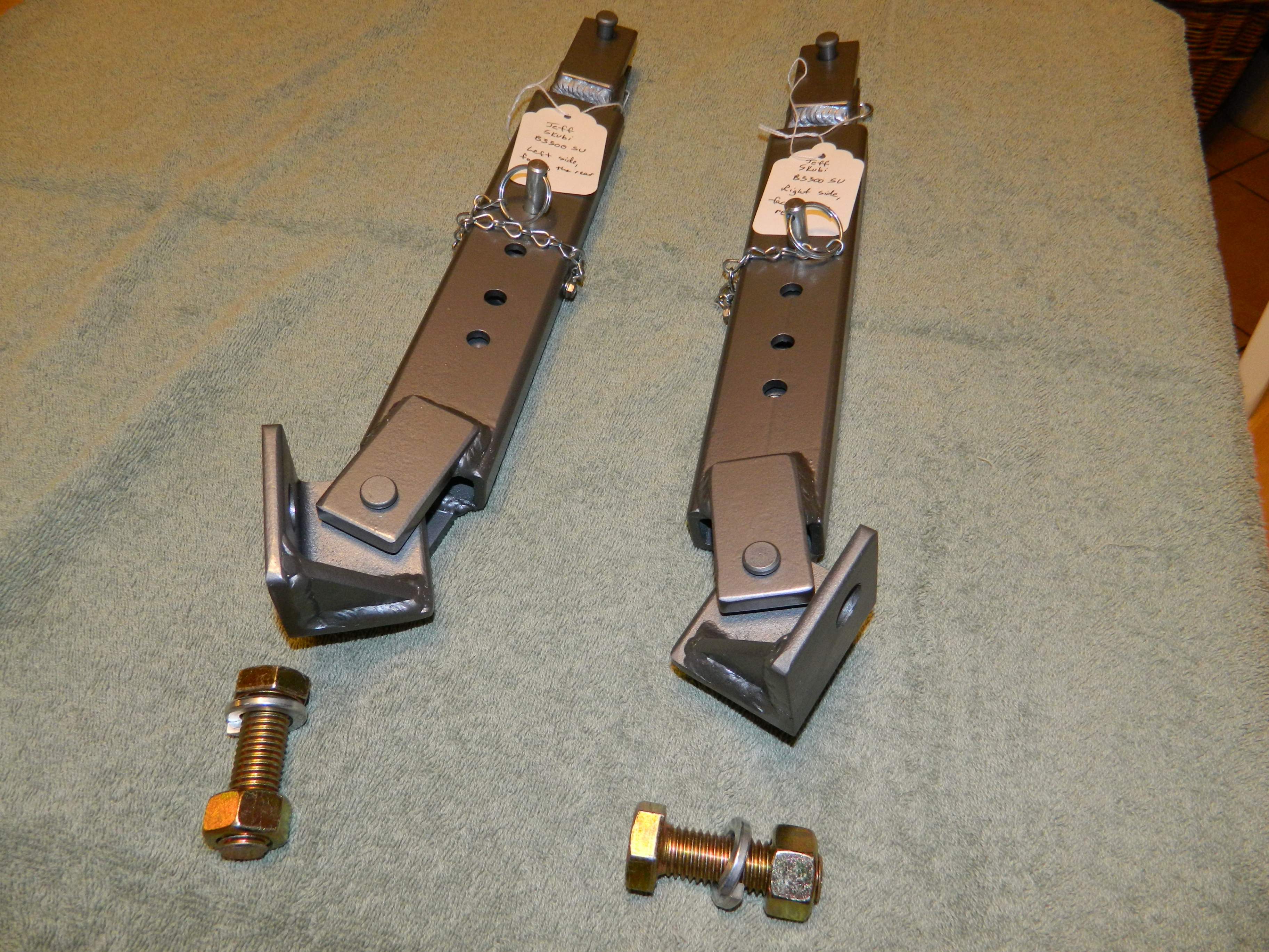

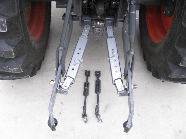

Land Pride is partially owned by Kubota. Good implements.
Kubota is making Three Point Hitch rigid, pinned stabilizers optional on smaller and smaller Kubota tractors. I do not know if these are available for a BX. Standard are turnbuckle stabilizers, sometimes called chain stabilizers. You cannot PUSH at all with turnbuckle stabilizers, which you will likely want to do with your Box Blade from time to time. You can PUSH, prudently, with rigid stabilizers. These do make mounting implements easier.
MORE: http://www.tractorbynet.com/forums/...opic-stabilizers-check-chains.html?highlight=
Mounting implements on BX Three Point Hitch is not too difficult. Implements are relatively light. You can jockey them around 1/4" to line up implements and tractor without much trouble. As tractors and implements increase in weight mounting implements requires more technique and more effort.

   / Help with BX80-series implements #5

Mark Hodge is a minister who operated Stabilworks as a side business. As Stabilworks grew, it impinged on his ministry, which is Mark's priority, not tractor parts.
I read recently that he is still producing his excellent stabilizers on a limited basis but sales are by reference.
Check with Kubota. If Kubota does not produced rigid, pinned stabilizers for the BX I will send you Mark Hodge's e-mail address in a private message.
I suggest Kubota first because there is a wait for Mark's made-to-order output and I doubt Mark has produced for the for the new BX if it has unique dimensions, a further complication.
