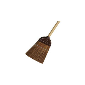

part of my arsenal, is a "bush broom" a 1 to 2 feet wide, and has tons of bristles in it. to smoother fire out.
snip.
"Bush Broom" I did a search for that and got squat...except this;
Is this what you refer to boggen?

Firefighting professionals shop for helmets, flashlights, boots, badges and shields at TheFireStore.com - Brush Fire Broom, 5 Ft Length
This is what he is talking about. Heavy duty bristles that you wet down before using. We used them to sweep the edge back into the burned area on smaller fires/smoldering stuff. Not too useful on anything free burning.
There is also another version of the "fire broom" that is available from Cascade Fire Equipment that is essentially a "push broom" with metal bristles. It is used similar to the Perfex fire fighting broom of rattan fibers, but is pushed instead of "swept". cascade fire broom.jpg
As with all the "brooms" and "flaps", they work good on creeping fires in light fuels. For hotter fires, you need someone to cool it down with water spray from a backpack pump or small spray hose.
