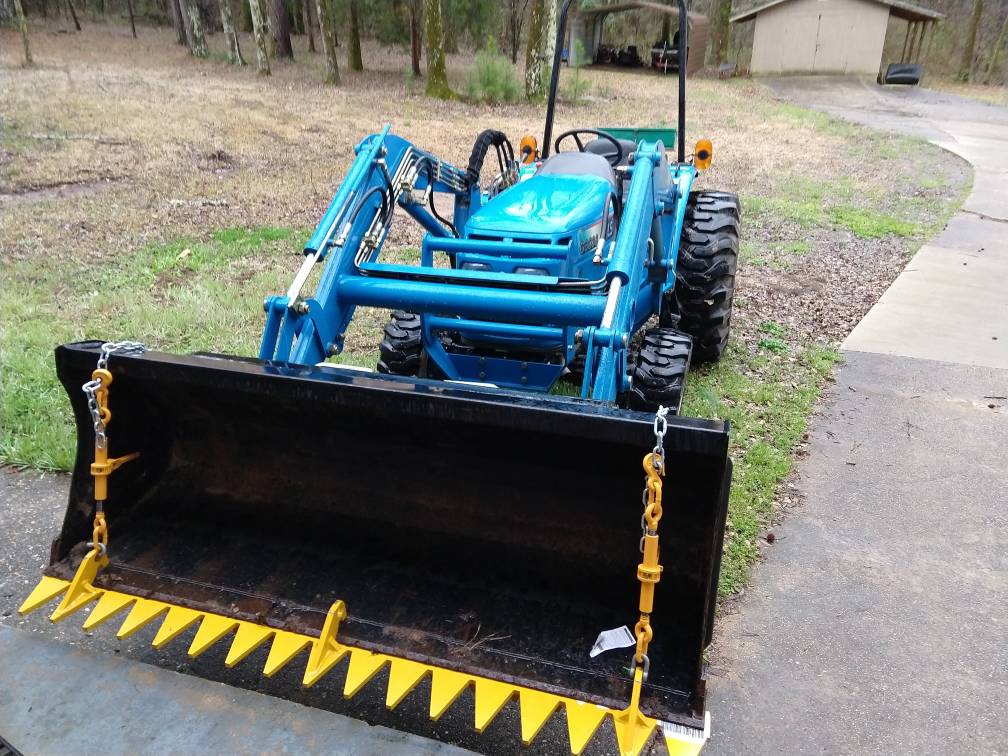

Check out the ratchet rake. It rips stuff out by the roots. I love mine! I ordered it with the forestry chain shackles and binders instead of a ratchet strap. I haven't head of anyone that had trouble with the ratchet strap, but I felt like the binders and shackles would hold tension without slipping better. I've ripped pine saplings out with mine, so I think what you're describing would be within the realm of possibility. IMG_20190313_170105894.jpeg

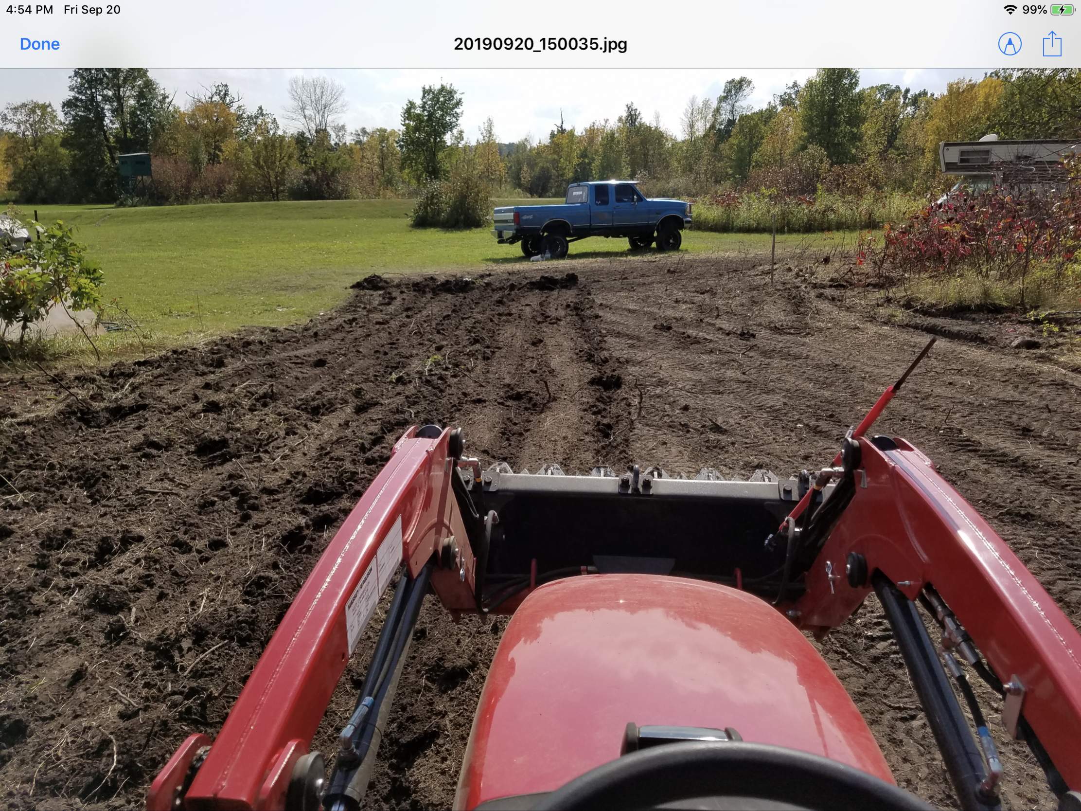

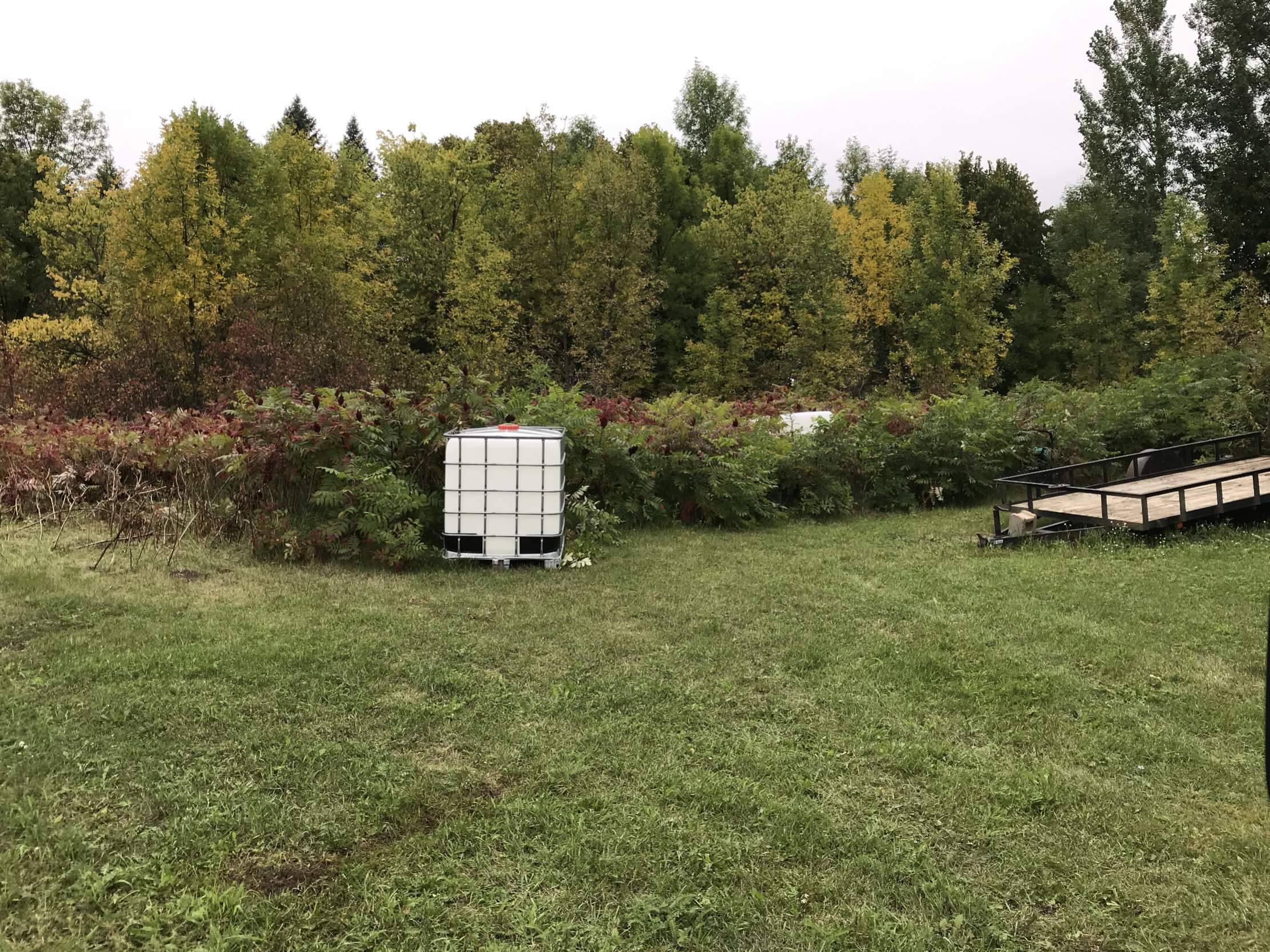

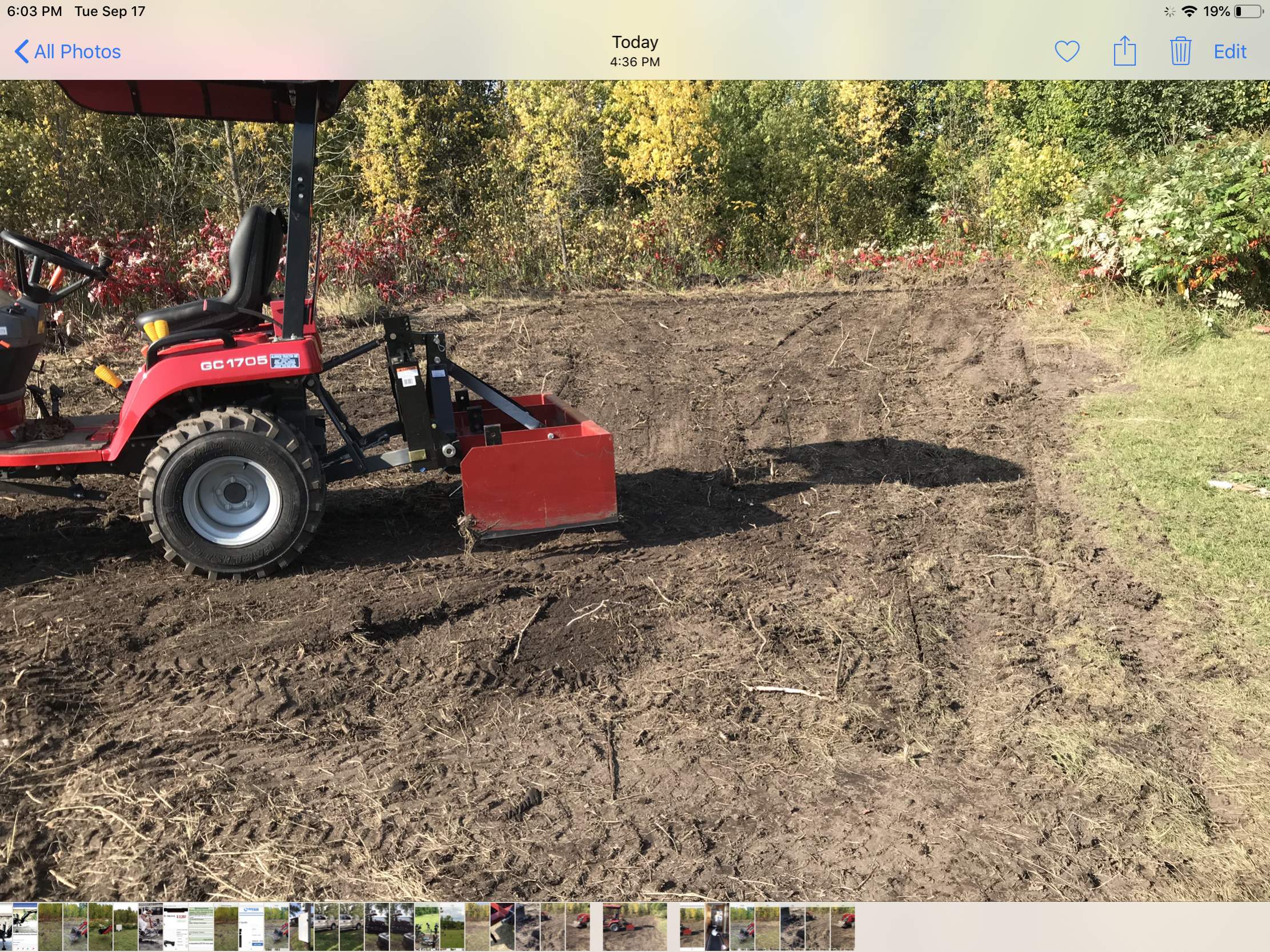

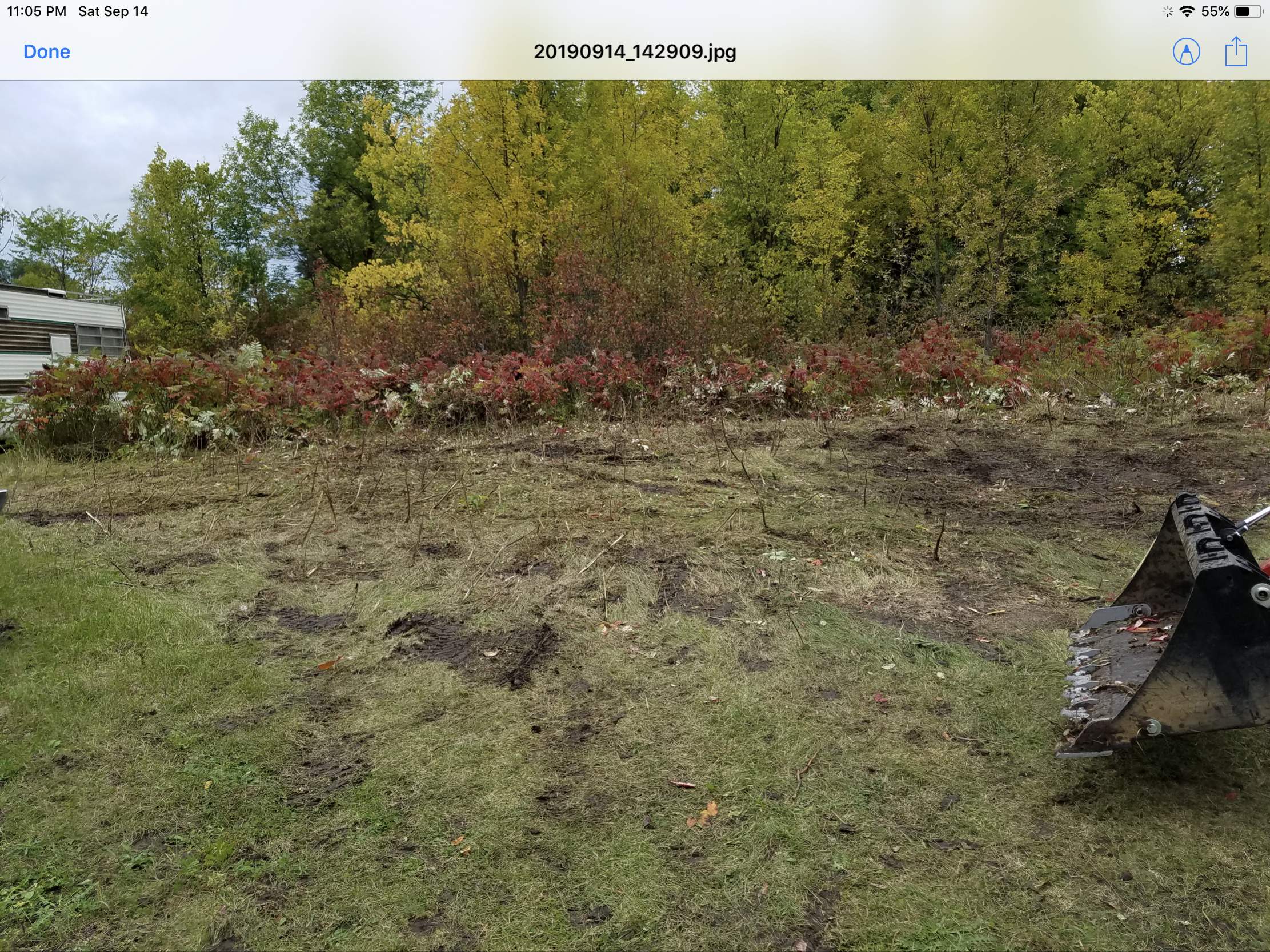

I used the Piranha bar and my box blade to do this 34 foot x 65 foot area. I think I will try a land rake or a scarifier/tooth bar to get the rest of the Sumac roots cleaned up and level with the BB.

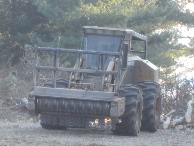

Just remember that the ability of a implement to pull vegetation out of the soil will vary, depending on the type of soil. Sandy soil or soft sandy loam in a woods allows veg to be pulled easily while solid clay/dirt does not. When I had 4 acres of trees and buck-thorn cleared, a guy with a mulcher head went over the whole area to clean up the mess.

Interesting you brought the Mulcher up. Neighbour just said, "go get someone with a mulcher and let them take care of all of it" then you don't need to buy anything. Financially I suppose that makes some sense. but then why do I have a tractor??
