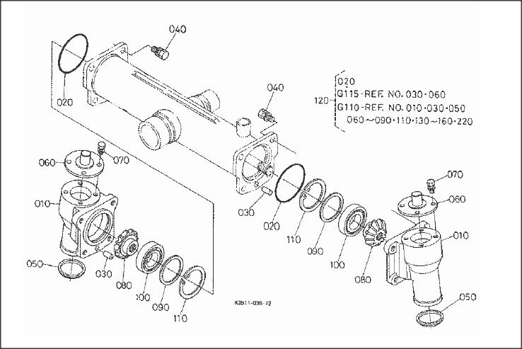

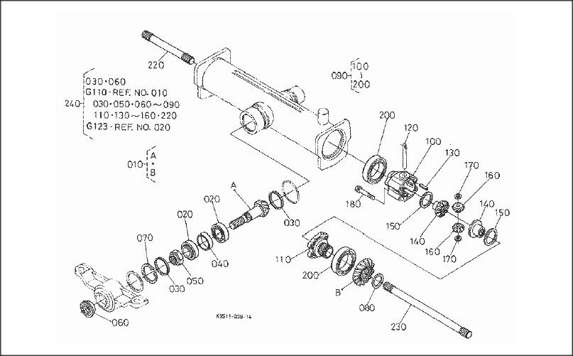

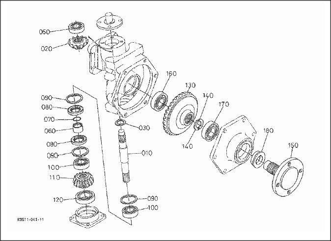

I finally decided to attack the rear axle pivot oil leak in my F3060
All it really needed was oil seal (part 060) in the enclosed differential parts drawing, but while at it I took apart both bevel gear housings and replaced all oils seals, dust seals, O-rings and couple of snap rings & wear bushings.
Lot of parts but like most things it's pretty easy once you figure it out!
(By the way, all gears and bearings still looked very good with hardly any signs of wear.)
Next time the oil seal 060 can easily be replaced by just disconnecting the drive shaft and prying out the old seal - no need to take it all apart if it ever leaks again but I figured with over 3500 hours of use it was time to check out and replace all seals

I have a similar leak on my trusty F3060 which just got to 2,500 hours.
I called my local dealer and they have the "OIL SEAL" (mentioned by the OP as 060) in stock (part 76611-12130, about $11.) Apologies for the dumb questions but here goes:
1) how does one remove that real-wheel drive shaft to replace that oil seal? Do you start by removing the two big bolts that hold the big V-shaped bracket that holds the shaft on the rear side? What next?
2) on my tractor this shaft has a roughly 1/2 inch front/back play, is this normal? The leak is not at either end but between the above-mentioned bracket and the rear case housing.
Any tip is much appreciated !
