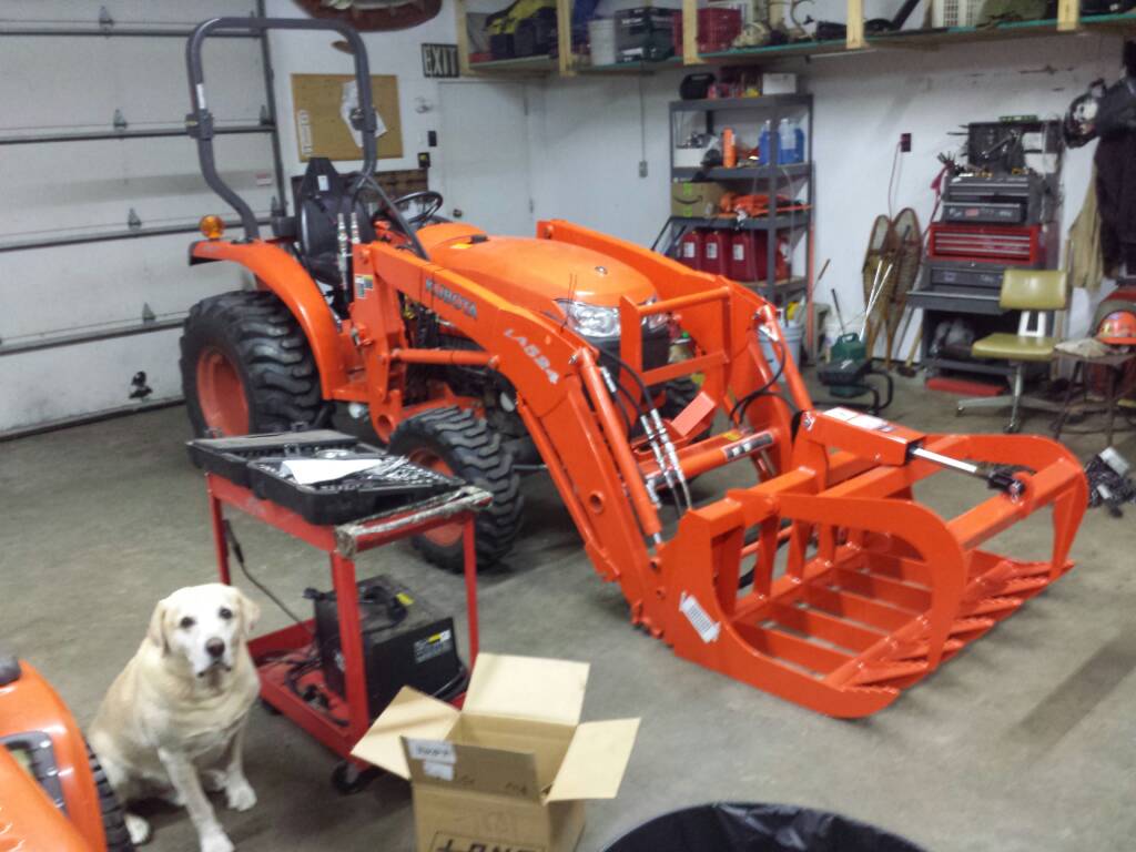

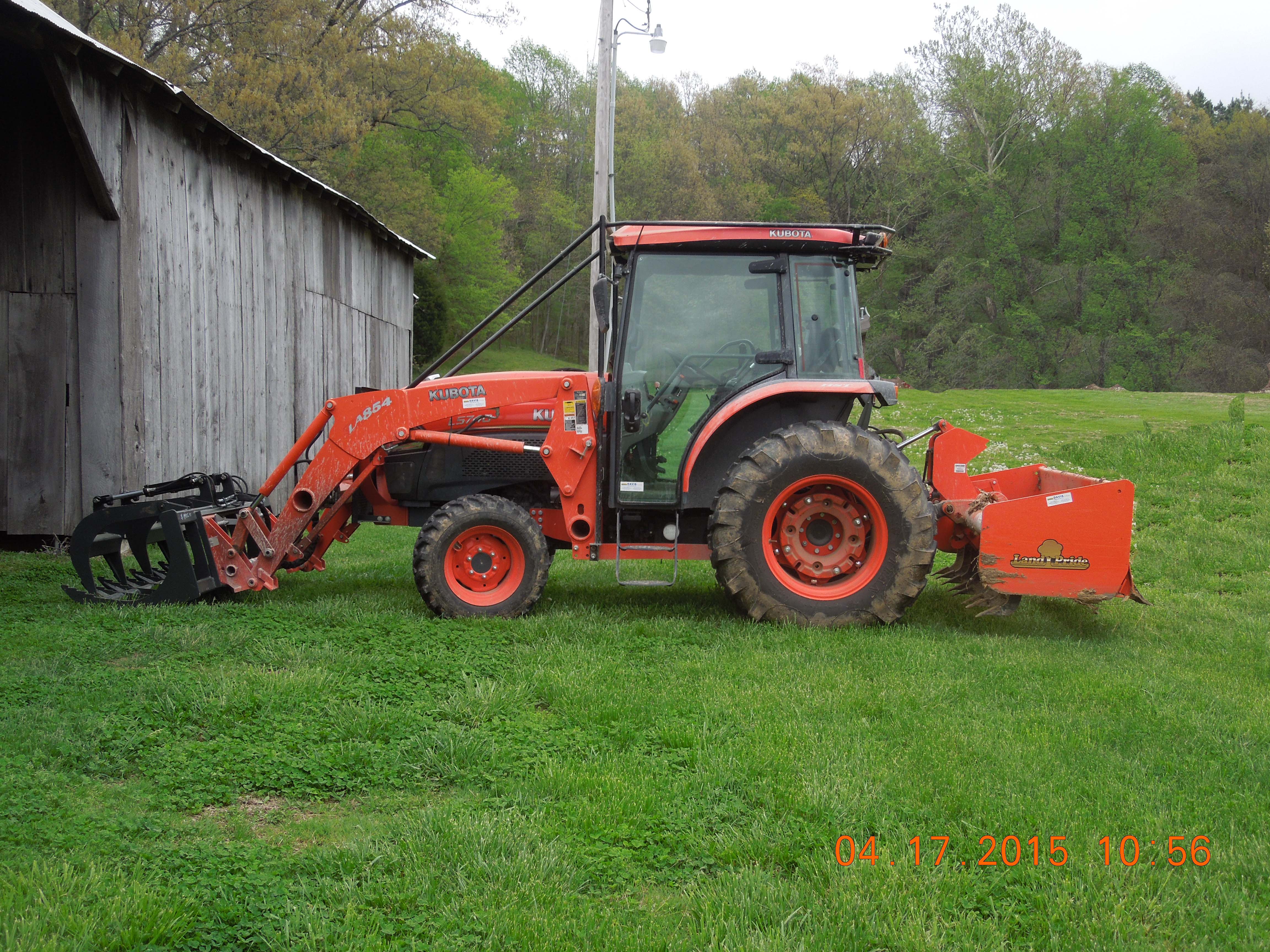

I went to my Kubota dealer to buy a LP grapple. The owner steered me to what he uses as we won't be using them a lot. No name on it and he doesn't even sell them, but agreed to get one for me, I found they are made by Loflin and sell only to dealers; don't know why. I liked it so well I got one for our L5740 and M8540. We have a good shop with good welders etc. if repairs or reinforcement is needed.
I usually recommend top of the line stuff, but in this case I'm using pretty much the same as in your picture.
