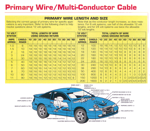

You guys are applying AC in-home wiring standards to DC automotive problems. Take a look at your pickup truck, there isn't a single wire bigger than 12 gauge running to anything other than the alternator and starter.
You should use 12 gauge wire for a 40 amp relay. In fact that would be a standard 40A automotive circuit.
EDIT: I didn't read this quite right.... a 40 amp relay and 12 gauge wire go hand in hand... but you want all of this:
a set of 55W front lights, pair of 55w rear lights, strobe beacon, dome light, defroster fan, front wiper and rear wiper
on one 40A relay? Somehow I doubt that adds up. The defroster is likely near 40A all on its own. Each 55w light is 5A. Each wiper motor is probably 5A. The strobe and dome light are probably around 2A.
Normally you run each switched circuit to one relay. Why even worry about ignition on? Run them from the battery through a relay to a switch you put on the dash and then you can turn on the dome light or beacon or rear lights without the ignition. You'd be surprised how useful that can be (the tractor lights are wired like that already on my 4200). And use the inline maxi fuse holders with weatherproof hoods ($2.50 at TrueValue) and save yourself a pile of trouble.
Only the defroster really needs a relay. Most switches are rated at 12V/10A so you don't even need a relay for the rest if you don't want. I wired two extra 55w lights directly to the headlights circuit in the ROPS. On my 4200 the wire was already designed to handle the extra load.

Here is the wire guide I've been using for ages....

I knew there was some different set of "rules" for 12V wiring. You are correct - there is nothing in a car larger than 12 or 14 AWG. I spoke with a guy at NAPA today and learned a lot. First - you're right - no relay is required unless I want the switches armed by ignition on. I like the idea of having power available anytime - running or not. Unless you use a dedicated relay for each circuit, there is no isolation offered by a single relay activated by ignition on. That type of relay circuit does not protect a thing. An isolation relay is where the ignition-hot (or any other control voltage) is run through your switch which in turn activates the relay to switch the power on to the load. I am goung to run a single 12 AWG or maybe 10AWG wire fused at 40A at the battery and cascade it directly to my switches. Each switched circuit will be individually fused right after the switch. By the way here are the loads: Wipers are fused at 7.5A each - but that is to cover inrush current at start-up. The wipers will draw about a third of that when running - call it 3A each. The 220W of front and rear lights will draw 18A, the dome light - 1A, the strobe draws 2A, and the defroster fan is just a little 4-blad, 6" fan on a swivel that draws about 3A. Total if everything is on at once: 30A. None of these loads require an isolation relay.

Yep - you hit the total amperage right on. Actually, I am an electrical engineer - I just have zero experience with auto wiring materials, components or methods. I am in the semiconductor business and have done a fair amout of residential wiring over the years, but no auto/marine work or design. But, I am learning. The response I gave above a few minutes ago is my best interpretation of the situation, and I firmly believe it is technically sound. Since I have decided to have power on constantly rather than with the ignition, there is no longer any need for the relay. Makes life a heck of a lot easier! Makes no sense to overcomlicate or over-engineer a system is there is no added real value - perhaps percieved value, but in the end, the simple circuit I have decided on will function the same as the more elaborate circuit without cutting any corners in terms of safety or longevity.
