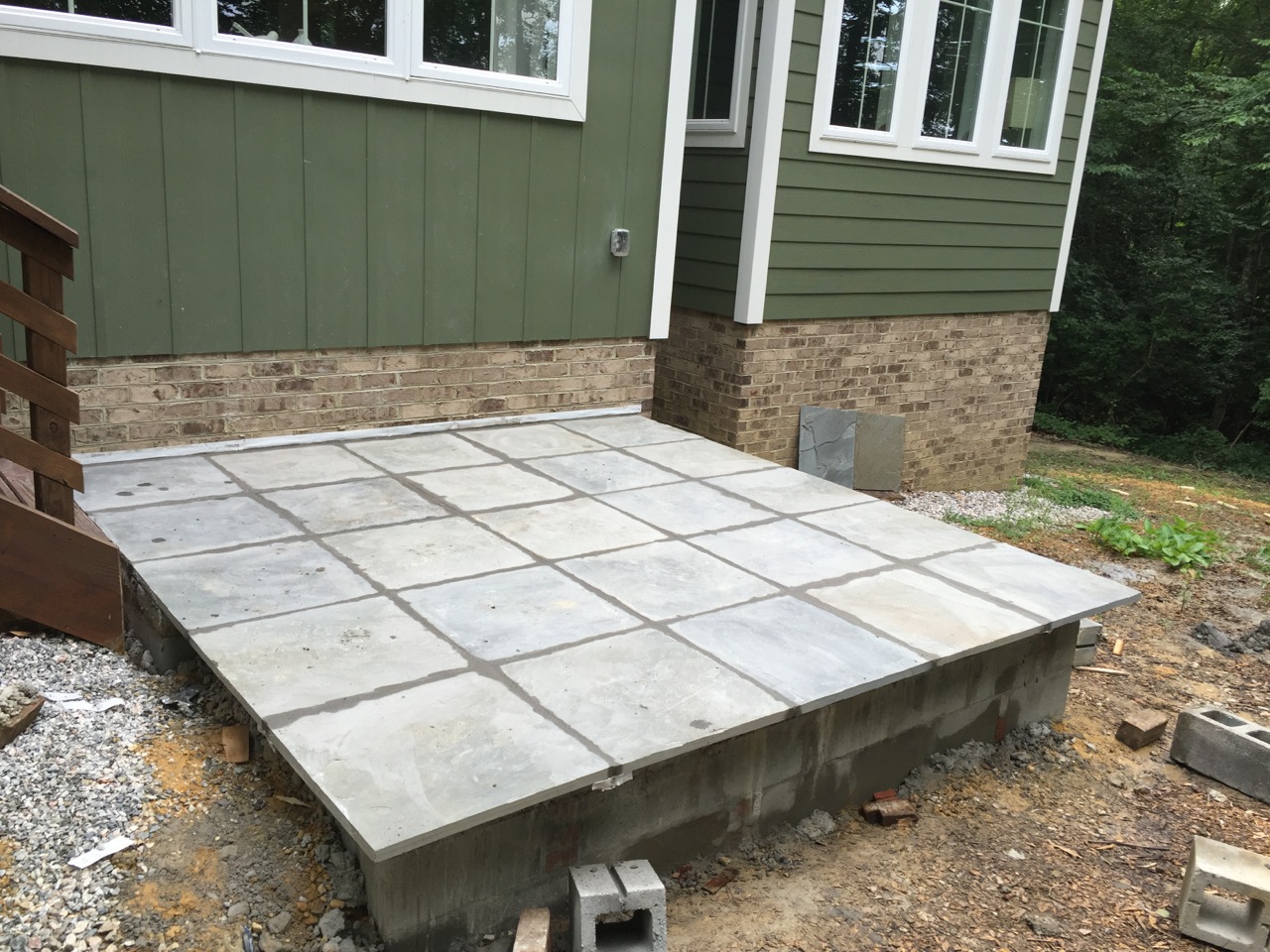

Here's an update -- the thin set seems to have worked very well. All stones are solidly stuck down, probably better than mortar could have done by itself. I grouted yesterday, just before rain showed up again, and it came out very nice:
I used concrete coloring (charcoal) to make the mortar a little darker -- mixed it to the point where the wet mortar was similar in color to the wet bluestone, so I'm hoping they are close in color when dry as well.
I tented over the patio with a tarp to provide protection from rain and some breathing space, and got about 9-10 hours of dry protection before heavy storms hit and the tarp gave out. We got about 3.5" of rain in 2 hours, it was just plain ridiculous. Grout still looks good this morning, so no harm done.
I'll give it another couple days and then give a light scrub with muriatic acid and water to get all the grout haze off the stone. After that, I need to start sticking on the stone veneer to the base, and also decide what to do about stairs.
I have to say, if this was a deck I would have been done in a couple days, rain or shine. I really didn't understand how much more weather-dependent and weather-vulnerable masonry work is. I would think twice about doing this kind of project during a rainy spring/summer. This would make a better project for the fall around here. Live and learn I guess.
