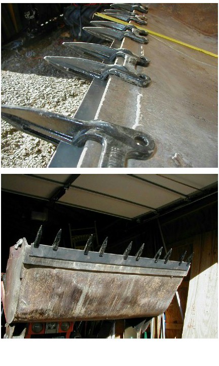

I'm building my own tooth bar also. The main reasons are:
1) My bucket is only 38" wide and about 15" deep and the tooth bars offered by carver and others would end up having five teeth across that extend out 5" from the front of the bucket. Now, I know that you WANT your teeth to extend out but to me, that is way out of proportion for my small bucket.
2) The tooth bars offered commercially all weigh 200+ pounds. That's 20% of the lifting capacity of my FEL!
3) Cost.
So I decided to make my own. I found "combine guards" at Farm & Country that looked to me to be just the right size for tooth bar teeth for my bucket. They were only $9.99 each and five of them ( ten teeth total ) fit nicely across my bucket. They have a 3/16" slot in them where I inserted a 3/16" X 2" piece of steel that I got for $4.95. This left the distance between the steel and the "tails" of the combine guards exactly 1/4" which is how thick the front lip of my bucket is.
I've fitted it all up and it looks like it will work. Now I need to get the combine guard/"teeth" welded to the piece of steel and bolt it on to my bucket. I'll probably use 1/2" bolts through the "eye" on the tails of a couple of the teeth.
Accompanying is a picture of the combine guards I used for teeth.
Next several posts will have the resultant toothbar fitted to the tractor.

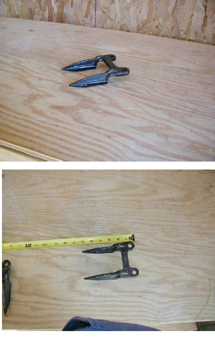

   / Help! - Tooth Bar #22
more pictures

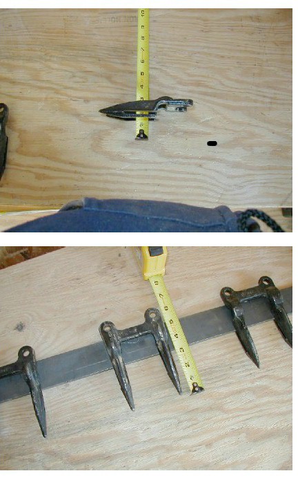

   / Help! - Tooth Bar #23
more pictures #2
   / Help! - Tooth Bar #24
more pictures - last set

Bill,
They look good and fit well. The one problem that I see and I hope that you don't have is that most of those types of teeth are brittle. I hope that they work well for you and don't snap when you hit a rock.

Bill... a commercial toothbar for your bucket is about 44 lbs. vs. 200lbs.... In fact it may weigh less than the one you are building... /w3tcompact/icons/blush.gif
I don't want to hit you over the head, but I think those "cast guards" will have an extremely short life the second you go to dig into something substantial... the material will break and it's not designed as your intended new use...
Somewhere around $240 + freight would get you a lifetime toothbar for your bucket... /w3tcompact/icons/smile.gif
But, I wish you the best on your project and look forward to seeing the results... /w3tcompact/icons/wink.gif

Well, I figured there would be a flaw in my theory somewhere but since I've got less than $60 invested it will be an interesting experiment.
Those guards DO look like they're cast but they say "forged" on them so I was hoping....
I'll let you all know how they work out when I get them bolted on and tried out.
I was going from memory of what carver e-mailed me on the weight - now that I think of it, 200# does seem a bit high...
