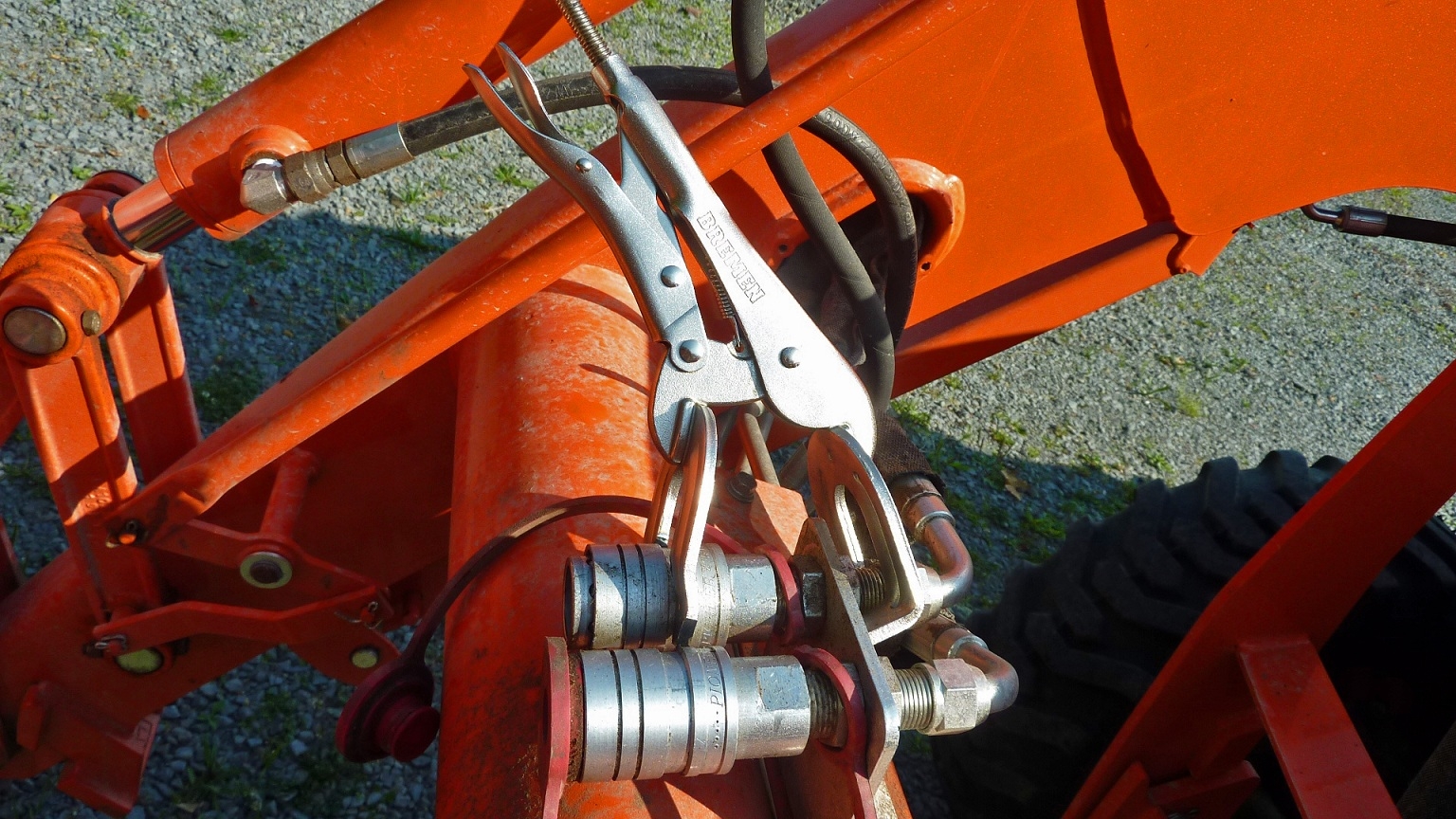

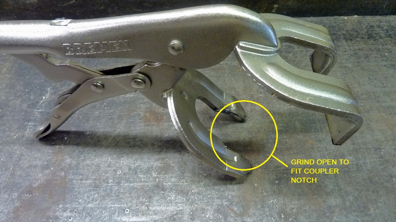

Get one of these welding clamp sets from Harbor Freight:
Open up the jaws with an angle grinder to fit the notch in the ag coupler shell:
It will open any pressure bound AG coupler with a pop and tiny spurt of oil. Wrap with a rag first to avoid a spill.
