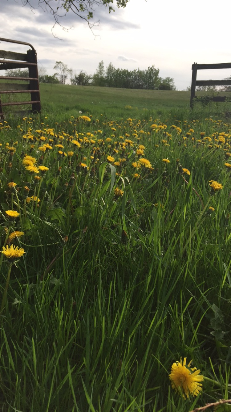

Brand new to this life. Never driven a tractor in my life. New owner of a 25 acre (used to be a horse pasture with a 1 acre pond in it). Now dream of developing this property.
Need to select a tractor that can
a) move some earth around (compost and top soil)
b) clear some trenches for better drainage.
c) mow around 20 acres (just tall grass)
d) use to maintain a 1200 Ft driveway.
e) after a house is built will need to snow plow the drive way
f) mow around house (finish cut)
g) projects around the house like patio, planting 8 ft trees, gardening etc.
Soil type is Clay and the landscape is rolling hills and some marshy/wet lands.
Appreciate all feedback with models. I thought I need a tractor with FEL and a BH with mowing attachments.
Thanks in advance to all the masters out there.
