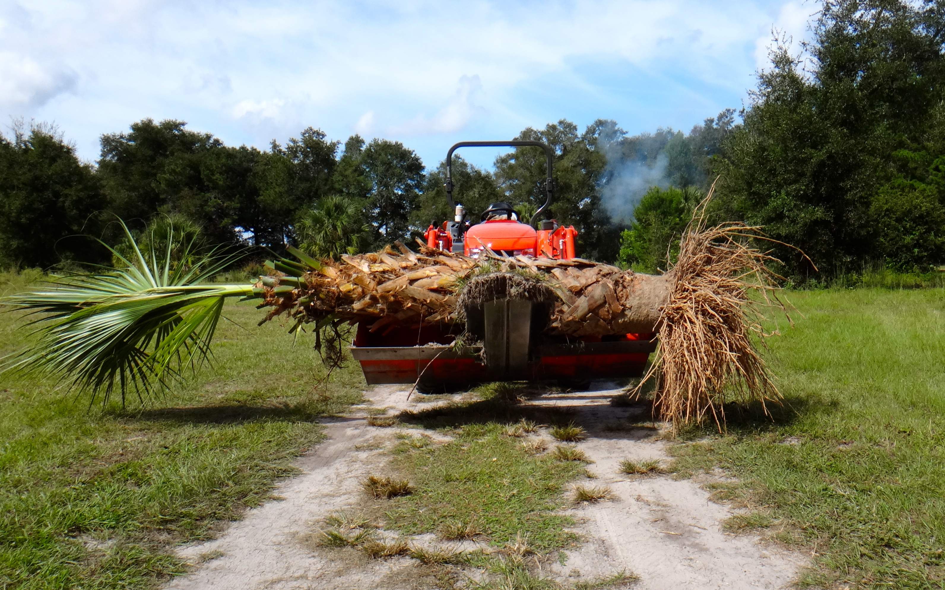

Loader buckets often take attachments. A Ratchet Rake attachment would allow you to use the pivoting FEL bucket to back drag debris out of your ditch. Photo #2. It is also good for minor grading. It is the best attachment for tearing out brush and knocking down saplings prior to shredding the horizontal debris with a Rotary Cutter. Industrial tires are usually paired with Loaders, in lieu of standard agricultural tires.
VIDEO: ratchet rake - YouTube

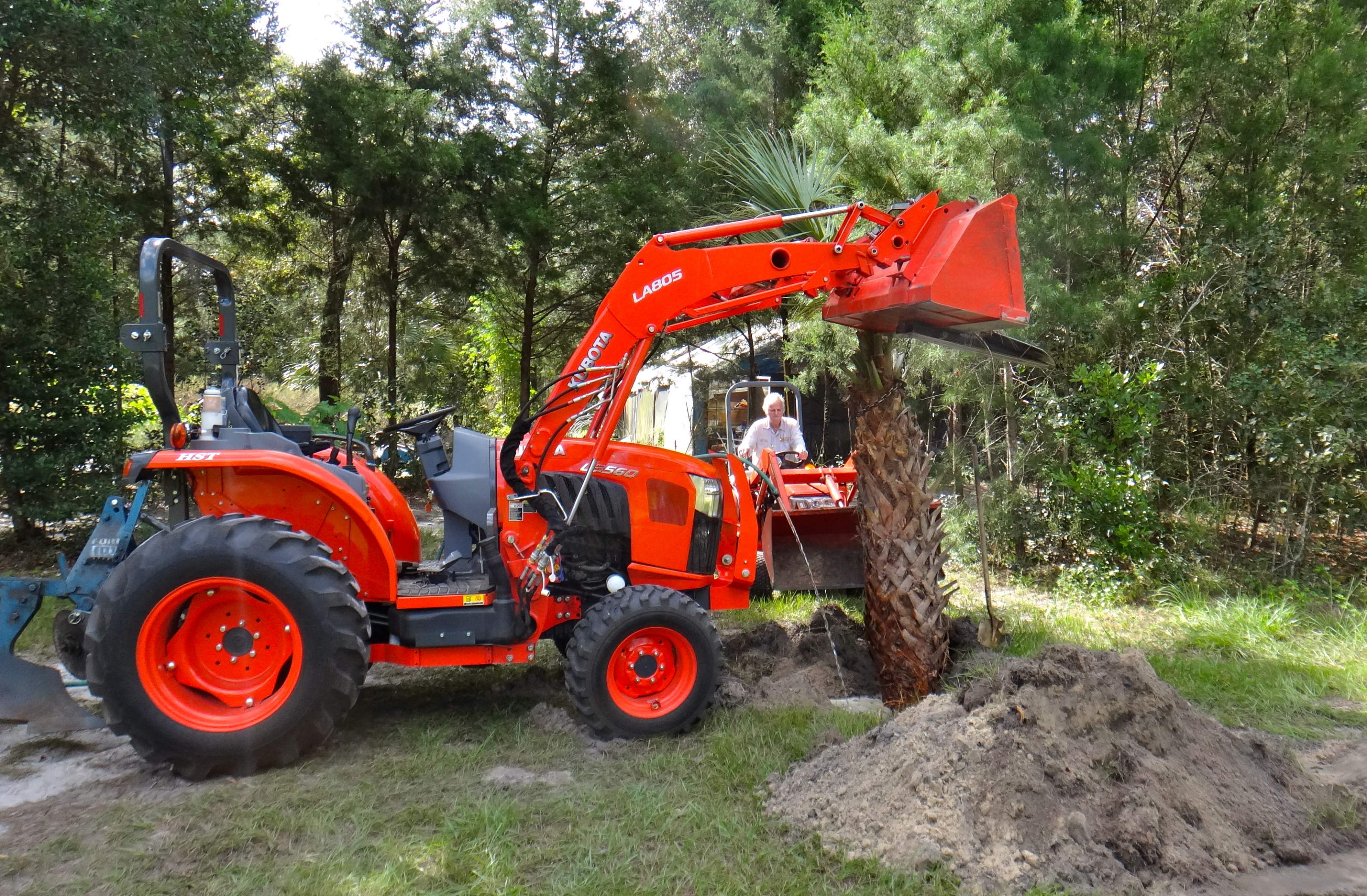

For planting trees you can use a Bucket Spade prudently. However, this size tractor is the lightest which can utilize this clamp-on bucket attachment.
A Middle Buster is often co-opted for tree planting. Mount on the Three Point Hitch, cut in an 'X' pattern and shovel out the loosened spoil with a spade.
VIDEO: using a middle buster - YouTube
BUCKET SPADE LINK: Tractor and Skidsteer bucket spade shovel
