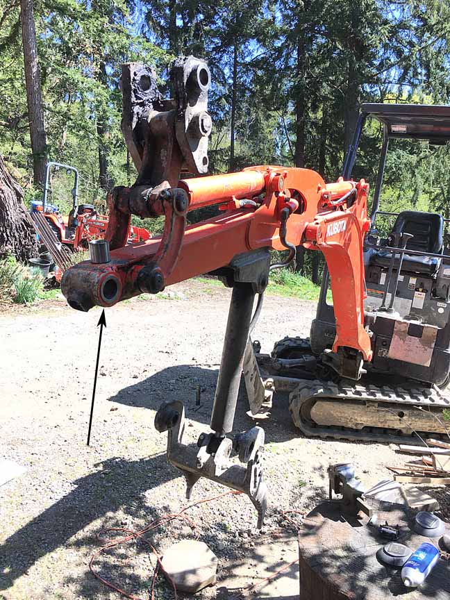

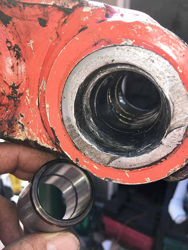

I'm wondering if any of you can offer tips to get these worn bushings out.

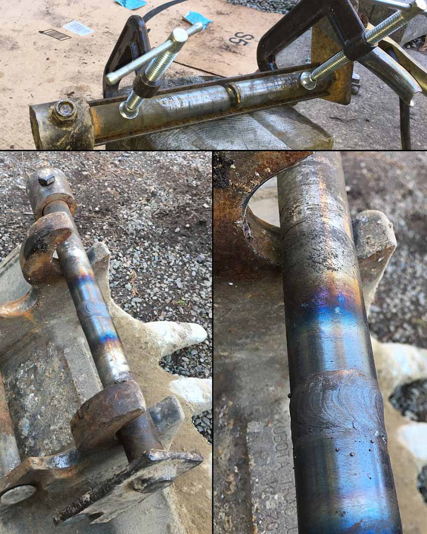

Bushings were so worn out it was letting the thumb bend the pin... until the pin broke.
I welded the pin while waiting for my new parts, and it fractured again 3x, quickly which was no surprise.
651323d1587074548-help-replacing-dipper-stick-bushings-kx41pin_weld-jpg
As you all prob know, when a pin breaks by fatigue, there's a whole bunch of subsurface cracks in there that you cannot weld up and it will just break again at the next crack over that the weld did not penetrate.
651322d1587073694-help-replacing-dipper-stick-bushings-dipper_8958-jpg
651321d1587073694-help-replacing-dipper-stick-bushings-dipper_8960-jpg

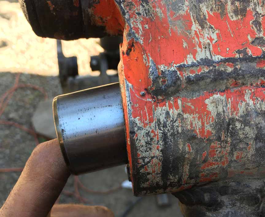

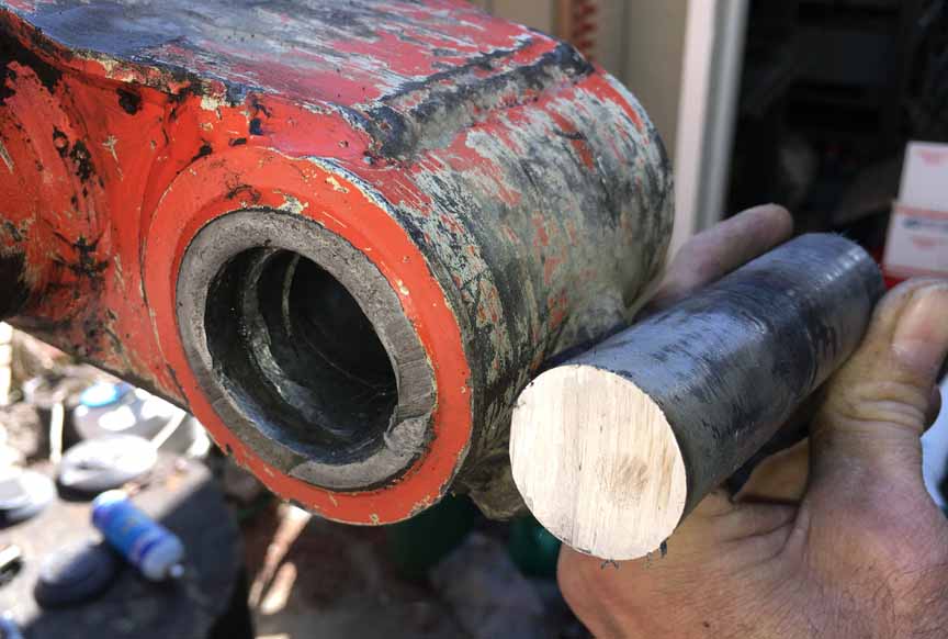

The bushings are so worn there's no face to push on.
It's pretty much a taper.
651320d1587073694-help-replacing-dipper-stick-bushings-dipper_8957-jpg
Hope you like the pics!
Well if anyone has experience getting tapered bushings out I'm all ears!

Torch and cut them out....

Thats a great way ! But if I can just find my danged O/A torch. That would do it! Ive burned steel out of cast....can I burn this (steel) bushing out of mild steel Safely?
Along those lines what about welding a bead inside, will it shrink?
   / Help replacing dipper stick bushings, mini-excavator KX41 #4
I watched my boss burn lug nuts off a truck front rim and not wreck the threads I guess it depends on how good you are... I don't think it will shrink heat expands it you need to slice it ....:)

But when it cools a weld shrinks.
Theres the oft-told-tale of that one mythical feller...
who got a bearing race out by welding a bead in a circle around the inside,
then he smokes a cigarette and listens for the race to "TINK"! ( fall out ).
OK I got it.
Thanks for the smokewrench suggestion Peter.
I looked all over for my torch
....and not finding it, hatched this plan.
651337d1587080714-help-replacing-dipper-stick-bushings-dipper_8963-jpg
651338d1587080714-help-replacing-dipper-stick-bushings-dipper_8967-jpg

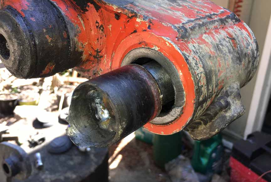

Welded the old broken pin inside, and pounded it out.
651339d1587080714-help-replacing-dipper-stick-bushings-dipper_8973-jpg

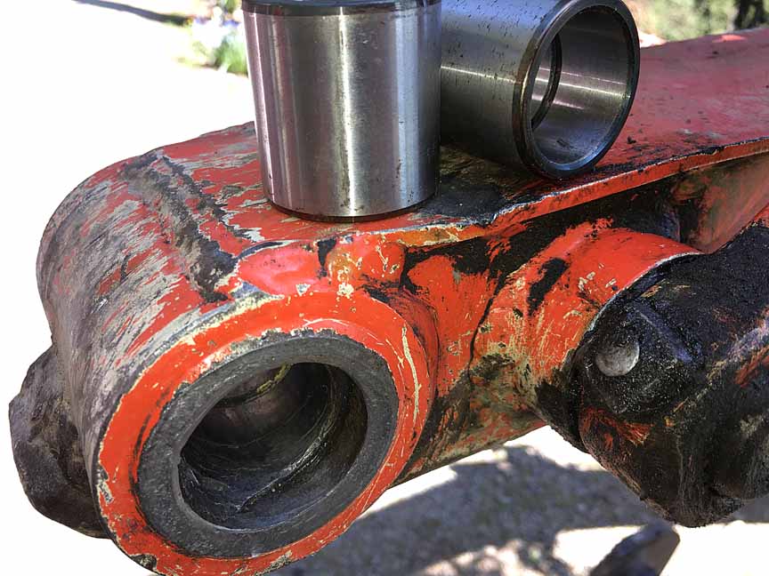

Now I have another problem.
It's been bored out and the bushings were oversized,
and my new $45 each Kubota bushings and $19 seals are loose in the hole.
Dang.
Where can I get oversized bushings?
Looks like I have to find a lathe....
Actually I need to clean up the bore too.
This dipper stick is not so big... I can unbolt it and take it to a machine shop.

Welding around it will shrink it just make sure you do go AROUND or a zig-zag pattern around it not just a couple of beads straight in and out.

actually, the bushings are probably hardened steel, if a file won't nick it, that's what it is, if you made those bushings on a lathe, you'd have to use hardenable steel, turn it, then have it hardened by a shop that does that. it's tricky to properly harden steel. and a shop would have the Rockwell tester to check them.. an alternative is to weld up the inside of the hole, and have a machine shop rebore the hole to a proper press fit for the stock bushings.. another way is to have them make a mild steel bushing instead of welding the inside of the hole. the hardened steel bushings would then go inside that..

Replaced several on my IHI, and a torch is what I used. Cut a line in the bushing all the way thru, and knocked it right out.
