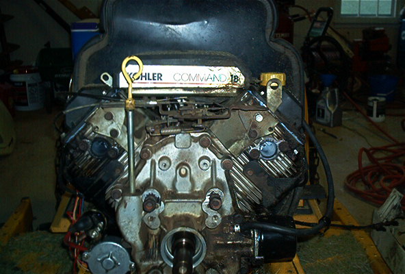

Not sure if this helps or provides any ideas, but my Cub 1864 (Kohler 18hp) had been leaking around the valve covers. Bolts were fairly tight, so I decided to take the two valve covers off. Cleaned the head seal area up with a mill knife and alcohol, did the same to the plastic valve covers. Used some RTV/Permetex and put them back on. You may try putting a little bit of Permetex around the head of the bolt so it seals against the top of the valve cover? Not sure how well that would work though
I have about 5hrs of use so far, and everything seems to be fine, well almost, I have a PTO seal leak I'm fixing now, but that's a different story.

   / Help on oil leak valve cover Cadet 782 #4

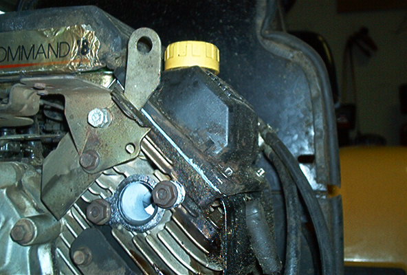

close up

   / Help on oil leak valve cover Cadet 782 #7
Take head off and see if the gasket is blown.

   / Help on oil leak valve cover Cadet 782 #9
The KT17 is just a flathead/L engine, so removing the heads and replacing the gaskets is a very easy job, just unbolt them, remove them, put on new gaskets (avail at small engine/Kohler shops), and properly retorque the heads back down- should get rid of the leak which is probably residual blow-by oil getting past the gasket.
